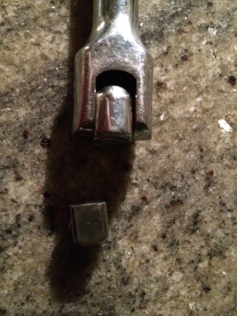

I was taking my driveshafts out last night for an engine rebuild and the O/S came off ok but the N/S was so tight that it did this...
That is a full size 1/2" Halfords Professional breaker bar...damn that tight :-)

Did you do that with just the breaker bar itself or did you use a tube or something to give extra leverage?
The cheap breaker bars don't last forever, I've bust a few in the past.

Big tube for extra leverage but I am still amazed at how bloody stubborn the thing is....lucky for me it is a lifetime guarantee one so they can give me a nice shiny new one :-)

Don't tell Halfords you were using a tube, I'm pretty sure it says "DO NOT USE EXTENSIONS" on the side of them!

Halfords 1/2" breaker bars aren't great - I think I've broken about 4 or 5 now over the years without using an extension pole, although usually I break the casting of the bar around the pivot rather than the 1/2" drive part that you have.
(and as anyone that's met me will confirm, I'm hardly exactly a muscle bound hulk!)
Never had an issue getting them replaced under warranty, but it's a bit frustrating.

It will still be a half inch square taking all the force... unless you've gotten a one inch 32 socket.

Either the impact gun or oddly the 1.6 ones seem the worst my Torque multi plier, never use 1/2" stuff on these for that reason I;ve broken loads in the past, beware thou sometimes the splines rust into the hub's

I broke a small extension tightening mine up using a 306 beam on the end of the breaker bar, thought the threads had given way at first then when i did the other side it just fell off as i nipped it up
