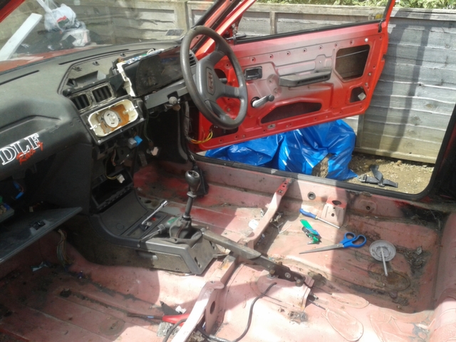

Well I have finally got the seats out and started on the dash, not come across to much rust and just a small bit of welding needed, what is the best thing to do with the floor drains, should i stick or weld them down?
Thought I would give the interior a rub down and coat it in waxoyl with a coat of Hammerite over the top!!!!

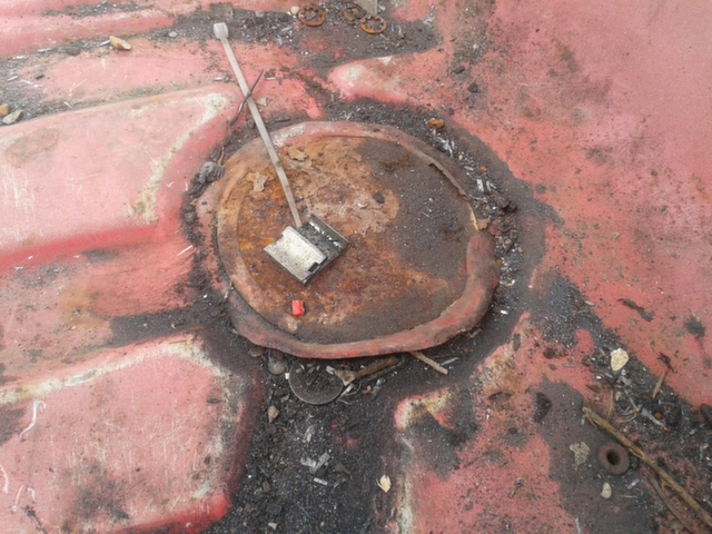

rear foot well
Clean all the grot out, then you can stick those plugs back in place. Something like Gripfill is a good choice. I have sketched them up to have stainless steel replacements made, but I haven't got them cut yet.
Painting wise, you cannot paint over the top of waxoyl. I wouldn't use waxoyl on the interior floorpans anyway, it will stink the car out!
For inside any decent paint will suffice although as you can see the original survives quite well.

Pic 1: this is the worst of the rust that I have come across, should be easily treated. ;)

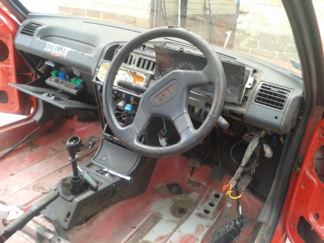

Pic 2: found the seat welded down, gonna weld a new strip in once I've tidied it up a bit. :blink:
Pic 3: think this is the immobilizer, not looking forward to taking this out, hate electrics. :unsure:

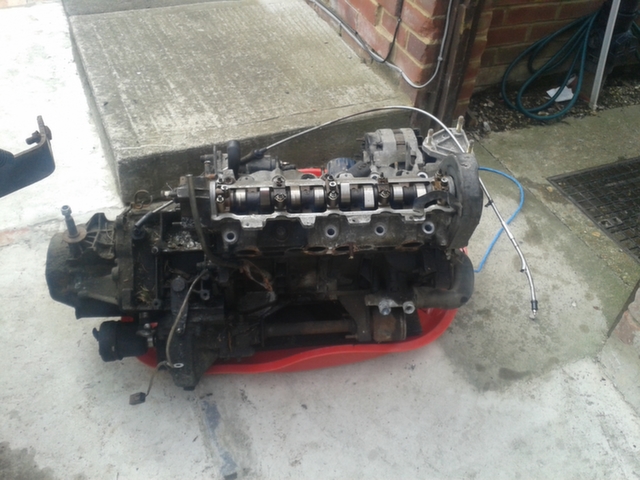

Well it's been a while as I was borrowing my neighbors small tool set so decided to invest in a set of Halfords advanced socket set for £75 (definitely a good choice too).

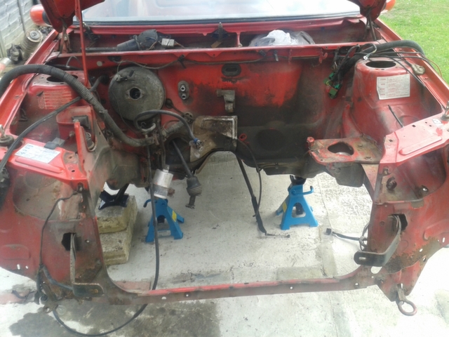

Because most of the nut were rusted together, and the exhaust was a one piece I had to remove it from the manifold which meant removing the subframe first.
After that I disconnected the engine and lowered it onto a sledge :lol: and jacked the front of the car up to drag it out. (that was this morning)
Gonna strip down the subframe and save most of it, apart from the suspension.
Prob gonna strip down the engine and sell it in part to fund a new engine.

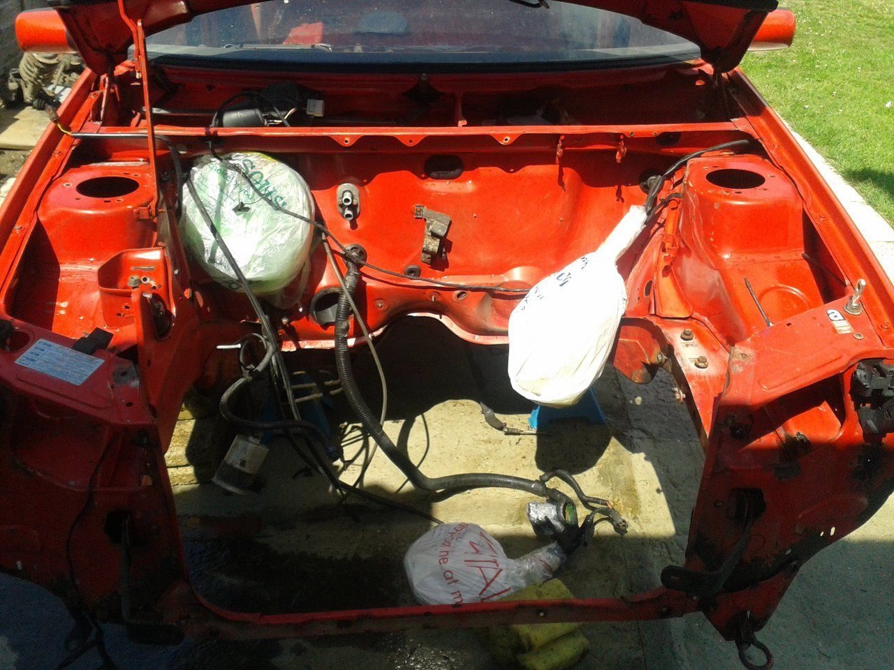

Once the engine was out the way I thought I would crack on with cleaning the engine bay ready for painting.
Here is a before and after, was quite happy with the outcome for a days work, not as bad as I though underneath all the grease and crap, also quite satisfying to see it looking clean :)
