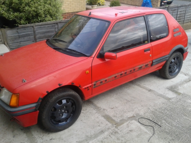

Well my 205 finally arrived today so thought i would take a quick picture before it got cleaned.
Few questions. What's the best way to get the skirting off and where's the best place to get an ignition barrel/door lock set from?

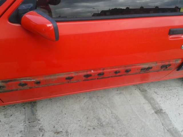

looks like he has used a bit of putty or something on the front trim and the wheelarch ones are screwed to the bumper so probably gonna invest in a straight set and re-paint em.

Well, it would seem that the previous owner was a bit uncoof as I have started to "gently" remove the trim only to find that it hasn't got any fixing but instead has been puttied and screwed to the body, I think I can save most the trim "bar 2 bits" but the red stripes are a bit ruined, and i now have a car covered in black putty lumps...... lol

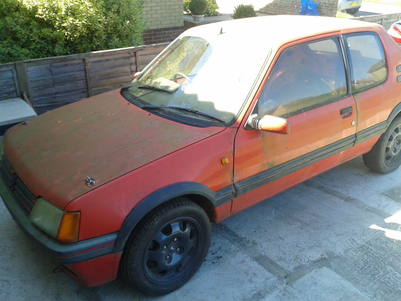

Here it is after a quick clean, just started taking trim off and you can see where they stuck it down :angry:

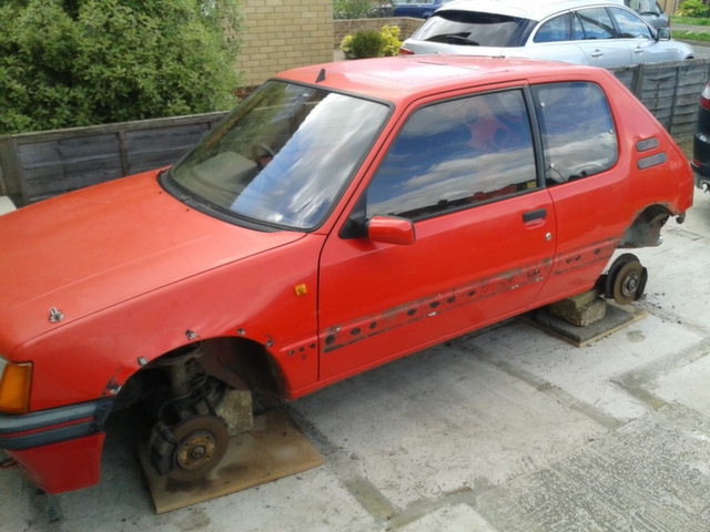

Have now got the wheels off and is up on bricks so will hopefully start on the skirts and bumper 2moz, as long as that aint held on my half tonne of putty too :(
please get some axle stands, bricks are not safe.
As Mei said axle stands are a must and not overly expensive. Bricks are downright dangerous :o

Will invest in some, bricks are just temporary so I can store the alloys away so some little weasel doesn't try and nick em.... lol

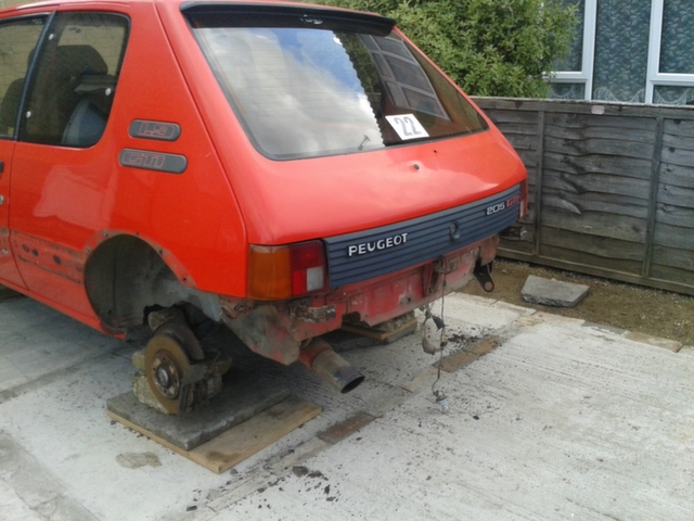

Well I finally managed to get the wheels off yesterday along with the back skirt and bumper only for the corner bracket to fall off the car :(
Does any know/have a set of rear bumper bracket anywhere as i'm gonna weald 2 new ones on for the corners and replace the back two with new bolts :unsure:

There was a guy reproducing the bumper brackets on here fairly recently mate, not sure if has has any left or plans to make more though.
