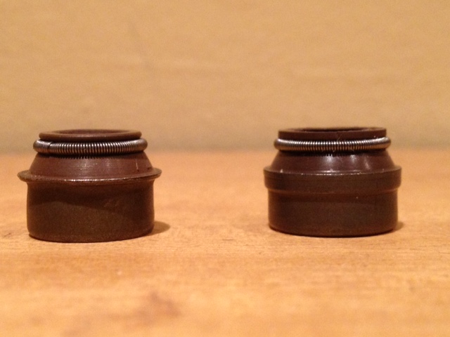

Second question I have is that when comapring them, there appear to be slight difference between the two sets. See picture attached. I assume that they are just two slightly different versions of the same thing and either will do. But that's an assumption; can anyone offer any comment or advice on which are correct/incorrect, or whether it even matters?

The seals in your picture are just two slightly different styles of the same thing. I would happily use them, its the heat and oil that makes them go hard.

Thanks Tom. I will proceed and use them :)
