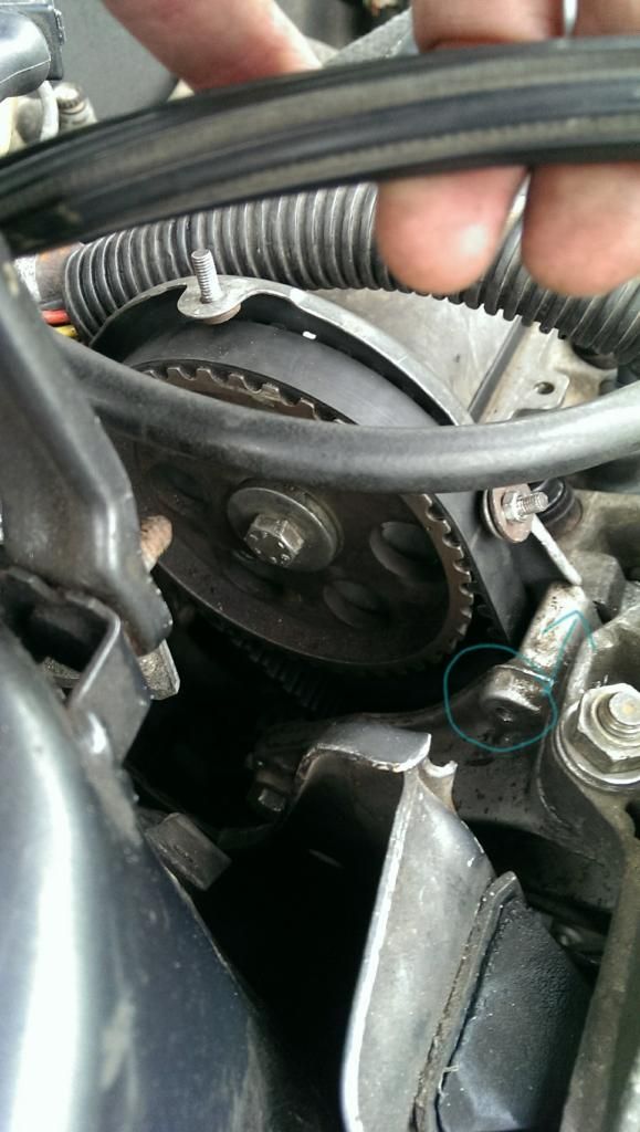

update - i think its the metal upper backing plate moving about. added the lower bolt but the backing plate still moves.
should i have a third bolt securing it in the pic below? There appears to be one missing - middle right of pic.
what is the purpose of the backing plate?

Stop debris and fingers from getting into moving parts?

is there meant to be a third screw/bolt do you know?

Don't know whereabouts you mean
Slo
No circled bit or arrow on it mate? I've just looked on servicepox too and it shows every timing cover component except the the backing plate

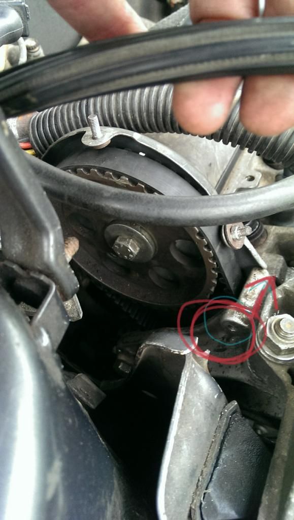

Second link above buddy? Faint blue line and circle halfway down photo on right hand side?

That hole is for the top cover has 2 10 or 11mm bolts and nothing to do with the rear cover
ATK
Ah gotcha. silly me. any idea what i can do about this noisy f#cking backplate?! it seems to be occasionally catching on the upper pulley too.
Slo
If the pulley is catching the backing plate and the plate is nice and flat and bolted up properly then it can only be your endfloat washer needs replacing in the camshaft.
Is the pulley straight or has it got a wobble?
ATK
pulley looks ok, backplate is ok when in a certain position but shifts with engine movement causing it to rattle in its new position :s
