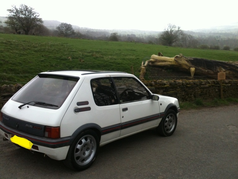

Not been active on the forum for a few years. See a few names I reckonise are still around :)
Back behind a white GTi. She pasted her test at the start of the month. Done about 800 miles so far without any major issues. (apart from the petrol bill)
Cheers Andy

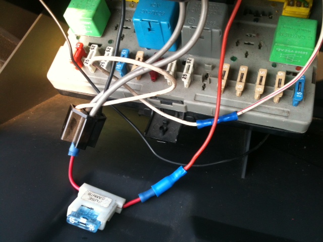

Had a spare hour this morning to check out the starter... With a cable direct to the battery + it turned over every time without clicking. Kinda gutted I spent ages changing the stater over now. You live and learn.
Followed the command / solnoid wire back to the glove box and found this...
Urggh! At first I thought maybe someone has wired up a relay but cant find one. Only one wire comes out of the black connector so not sure what its for.

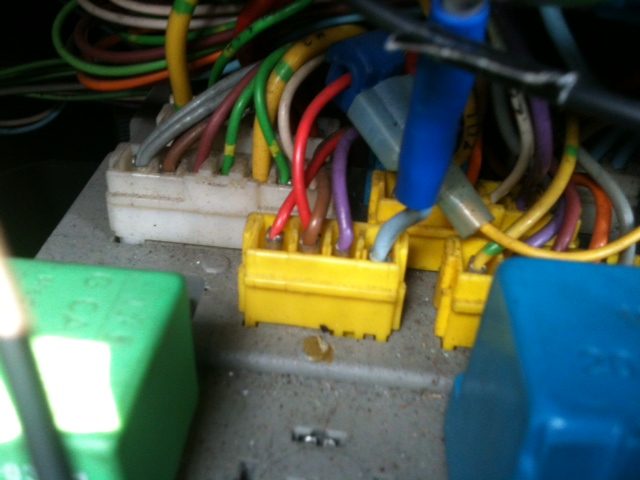

After going through all that (and more near the starter) the wire ends
going into the last wire on the right hand side on the first yellow connector. (light blue and with the blue connector on it)
Is that the correct location on the fuse box? and can i remove that fuse (doesnt look standard) Hoping I can just wire in a whole new cable and see if that improves things.

It's hard to know where to start with that, the blue fuse thing is non standard for sure.

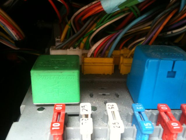

I just took this photo of mine but it's a phase two so not quite the same:

Had a search on the forum. The light blue wire looks wire 46 the correct solenoid wire :) I guess it's not normally fused? If not ill rip all that other s*ite out.
jackherer
No, the only fuses that should be there are the ones plugged directly in the fuse box.
