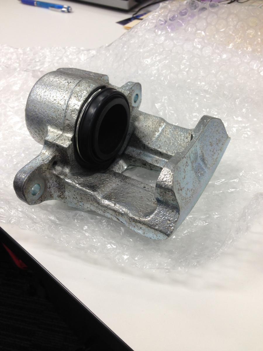

Since I purchased my GTI over 4 years ago, it has always been running with Wilwood big brake setup. The only downside to this is that I am unable to fit standard rims - either 14 or 15".
So i have started to acquire a set of 1.9 calipers along with pads, 1.9 caliper bolts and 247mm discs to enable me return the car to a more standard look.
However, the reconditioned calipers I purchased from the UK do not include the carriers.
See image:
So what else do I need? Obviously the carriers - but is there also a kit that includes the correct bolts to attach the carrier to the caliper?

carriers will probably come with the slider pin kit, however they can be purchased separately if required.
early renault clio and citroen ZX used the same calipers as well as the 309 and 205.
Anyone have any recommendations on where I can source a pair of carriers - from someone that will ship to Australia? The usual suppliers here cannot help.
