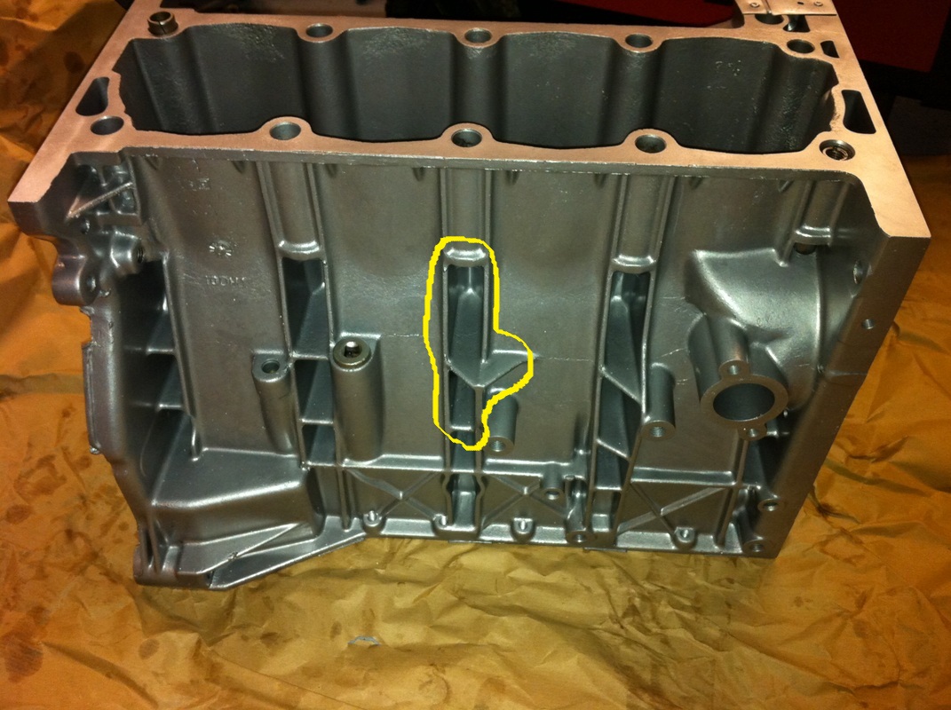

this not my engine,just as an example, where its circled is where its coming from on my heap

That is around the place where the blocks tend to crack sadly.
Clean the area up and inspect for cracks and a better idea of exactly where the coolant is coming from.

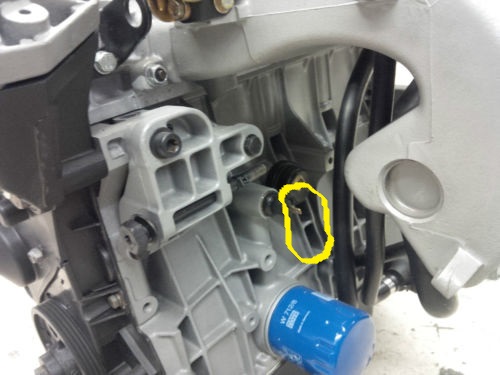

where circled is where its leaking from one of the squareish blocks

it might be something as simple as a leaking HG where the coolant is seeping down the bolt threads.

OK had a look, and it seems to be running from the head bolt as the others are OK and this one showed signs of rust and scale
and it has suddenly become hard to start,maybe water is getting in the cylinder too as well,oil is ok
