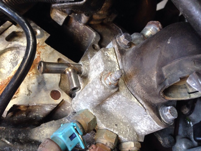

Mattr5uk
Have you blocked off the top right hand expansion tank outlet/return or have you plumed that to top of thermostat housing bleed screw? That's what I've done on mine and fan cuts in as it should ATM. Defiantly advisable to do that if you haven't .

dobboy
Matt, no never blocked it off yet, just turned it into the bay and i thought its working as an overflow at the minute?
So on yours it's constantly bleeding it?
