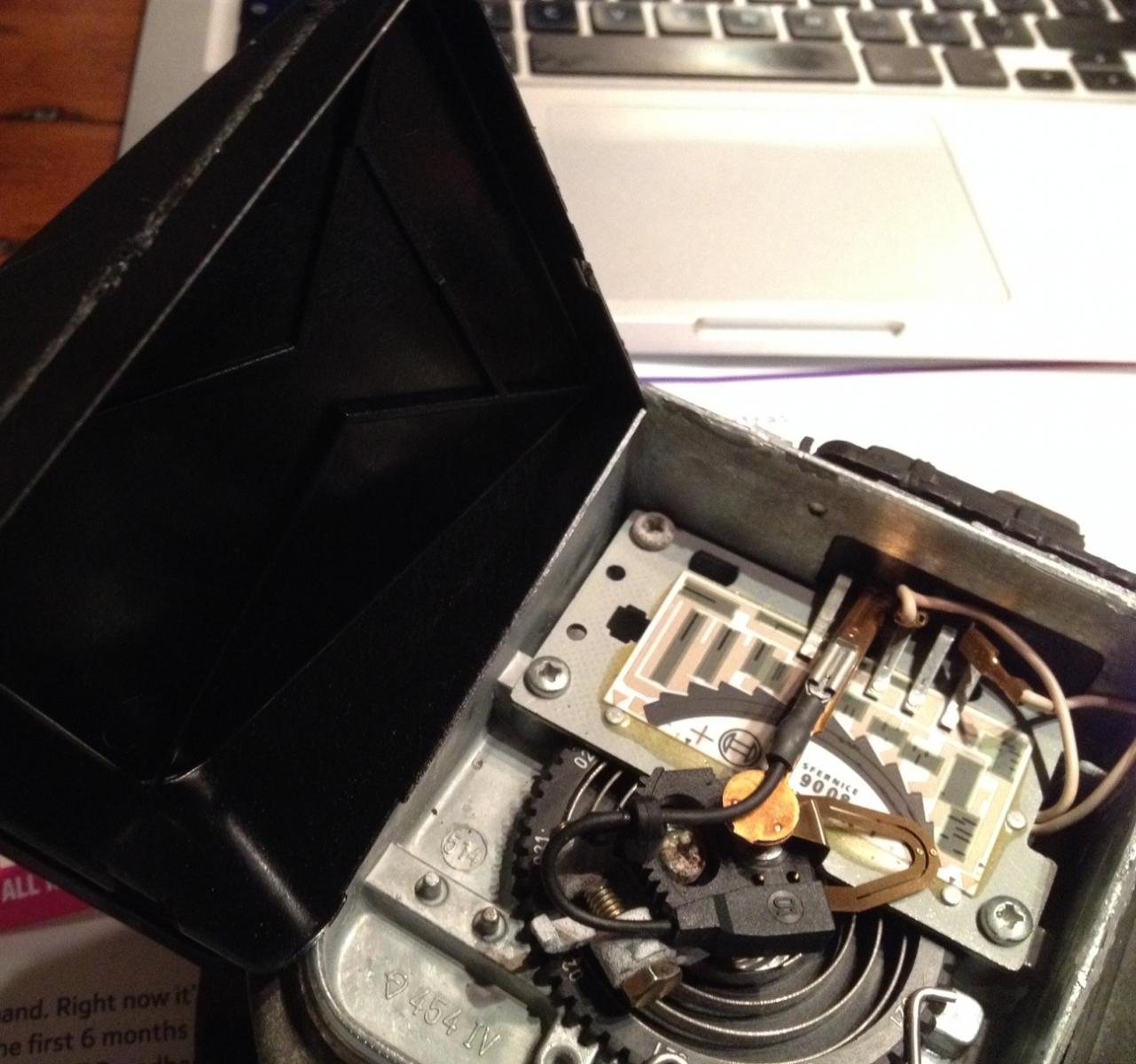

Whats the easiest way and will this help cold start issues?
nveeate
Carefully remove lid (selaed on with silicone), loosen the three screws holding the circuitboard (make sure you get the right sized screwdriver, as the screws can be tight and they easily round), move circuit board slightly until the copper bit is on a new bit of track, then tighten up and re-seal lid.

That easy huh? Do the circuit board holes have enough room to be able to move it or did you need to drill arger holes?
There should be enough movement...it only needs to move by 1mm or two.

Pic attached.
ATK
Great thanks, that makes it very clear. Do the two tracks on yours indicate its been retracked before?
nveeate
No, the copper piece is split into two connection points (presumably to increase the certainty of contact).
