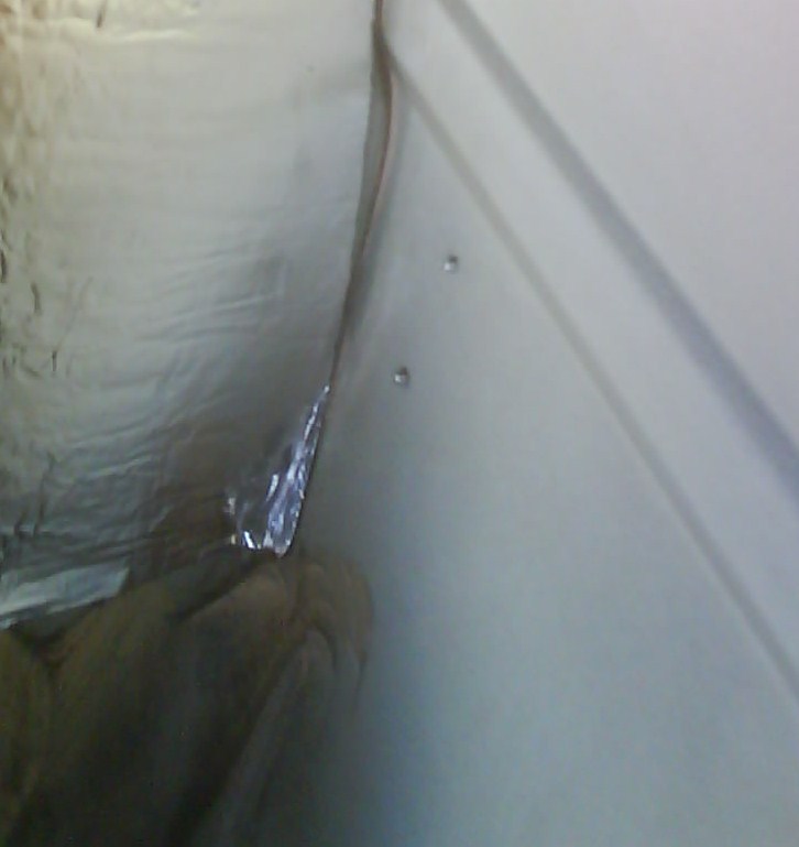

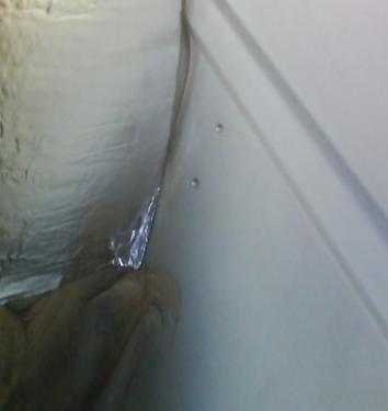

No dent or anything, just looks like something has pushed it through slightly. It's the last one for the red strip before the wheel arch and seems like it was off-centre for the hole in the plastic bump strip. I'll try and get pics of it in a bit.
Found it on the other side very easily die to broken interior and clips lol. Doesn't look like there's anything to get a hold of though.

If you can get some good side cutters on the rivet inside you can avoid going near it with a drill. You should be able to just pull it off from the outside once the inner part is snipped off. I'm presuming it's one like these...see pic?post-15673-0-38465200-1395308283_thumb.jpg
scbond
Think so...can't really tell from that side. On the outside it's like a stud. Tried pulling it back through but it just started to crumble.
Carefully with a small belt sander or dremel grind the outside lip off then push the remains through to the inside. Then fit a new one. Done!
