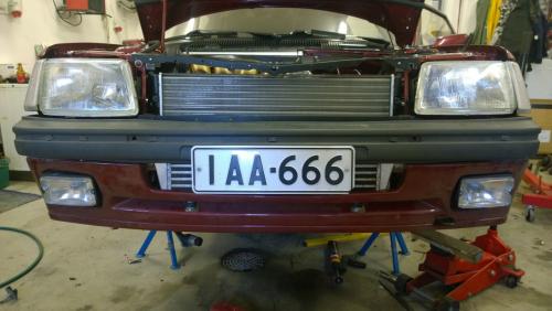

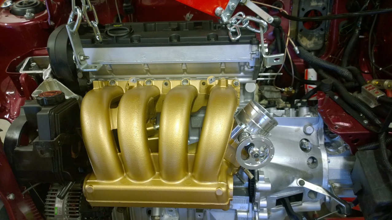

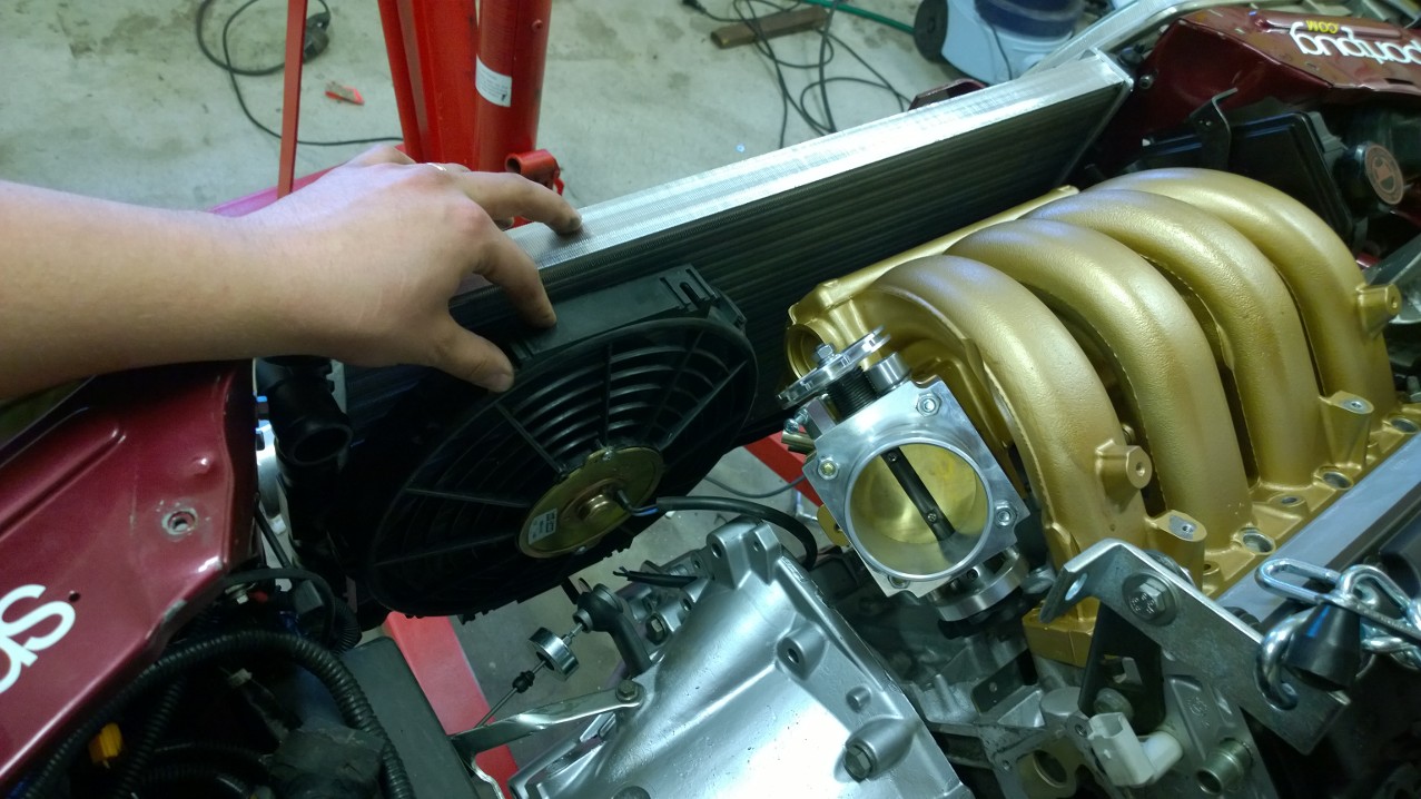

Tuuba 8 Posted May 26, 2014 Some progress has happened, but still some things to do. Ex. manifold is at welder, I might have it back next week. Now, I´m starting to do wiring loom for ECU. I´m very happy that the look of the car remains as "sleeper", from outside, you still don´t know what it has inside ​ Intercooler is in same place, but I had to move coolant radiator about 4cm more forward, so I must put one 300mm sucking fan behind it... Radiator is from VW Golf III 2.0 GTi, you can´t fit much more larger than that. I hope I can get it running before Pugfest, we are coming to visit there, with my 407 sw though. Journey is about 5500km long so we have to come with little more comfy car (my wife insists!) But it would be nice to have a little ride before with this little bastard ​ Few pics attached Share this post Link to post Share on other sites

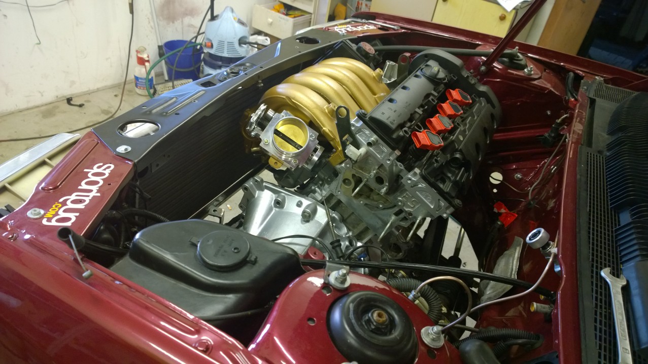

B1ack_Mi16 67 Posted May 26, 2014 You using VW/Audi FSI coils? Looks same as the one I bought for the T16, just black instead of red. Nice and good looking build 1 Share this post Link to post Share on other sites
Tuuba 8 Posted May 26, 2014 Yep, they are VAG 1.8T / TFSi ones. Let´s see how long do they last, good thing that they don´t cost much and you can get them almost from the milkman ​ Share this post Link to post Share on other sites
2052NV 24 Posted May 27, 2014 Is that a custom throttle body? Looks very nice!! Share this post Link to post Share on other sites

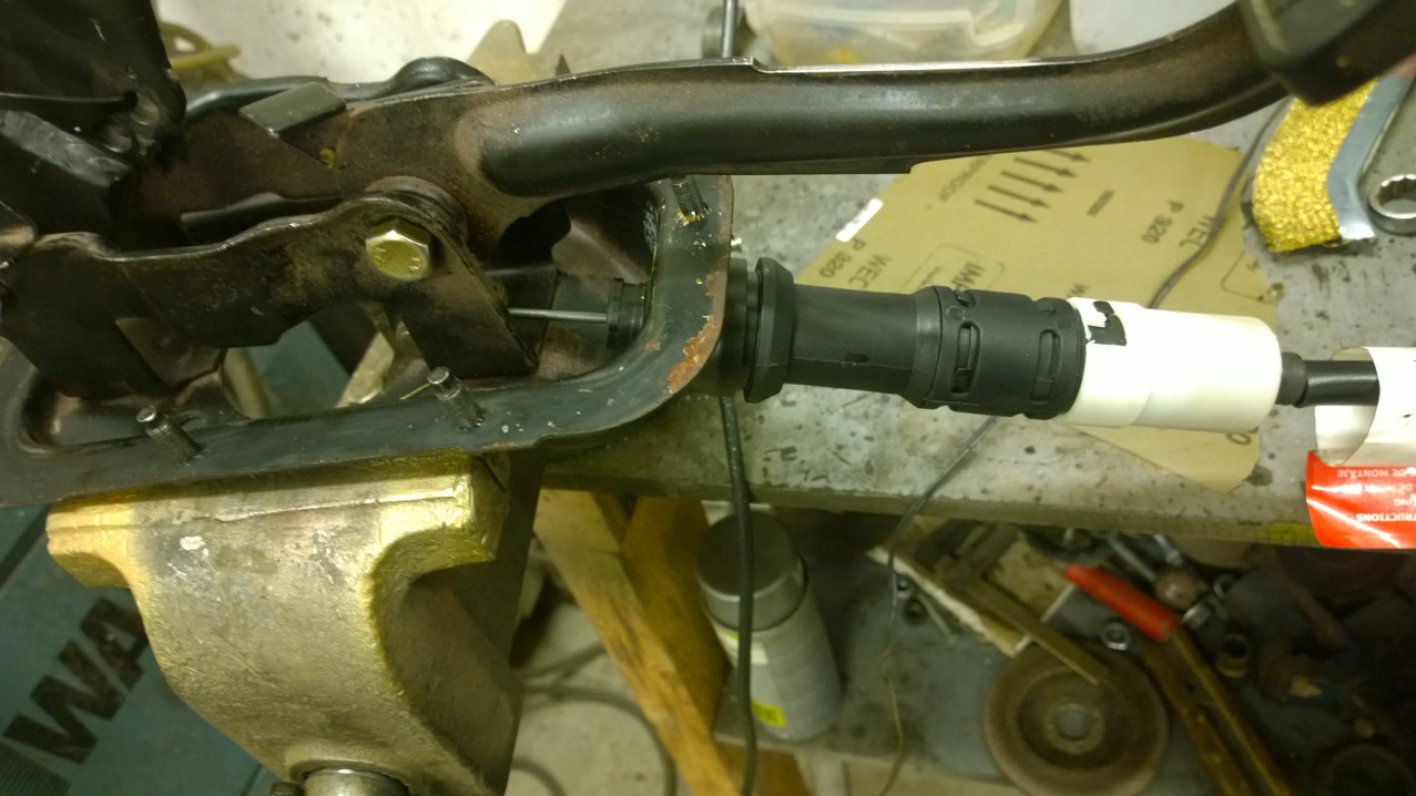

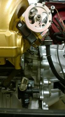

Tuuba 8 Posted May 27, 2014 Is that a custom throttle body? Looks very nice!! "This car is built using genuine E-Bay parts" 70mm Universal TB from China, pretty good actually, bearings OK, tidy flap and good finishing. 205´s throttle cable/pedal just opens it fully open without mods. TPS sensor needed new adapter but it was easily done from PEHD plastic disc. MAP/MAT sensor is fitted from VW 1,9 TDi, fits when you cut off both bolt flanges ande make a metal clip that presses it on it´s hole. After that, it was fully Bolt-On Idle control valve is a stepper type from Renault Megane. Clutch cable is from Citroen Berlingo (with auto adjuster) so I had to build the pedal end to fit and make a little space for adjuster. I also fitted 206 cable assisted gear levers and knob with adapter plate from original gear knob, so I didn´t have to mod the body itself at all (except 40mm hole for cables) And when the new engine had a Steering pump, I digged one 306 HDi steering rack from backyard. Thanks to new gear linkages, it now has really good space for at least 3,5" Downpipe... Share this post Link to post Share on other sites
