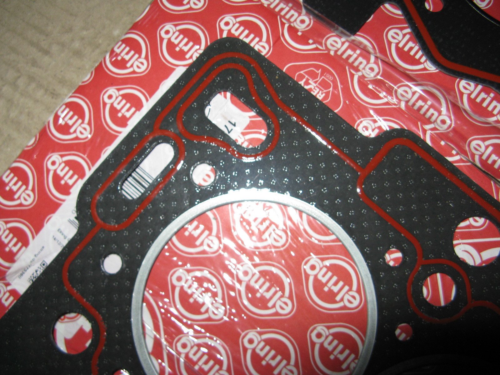

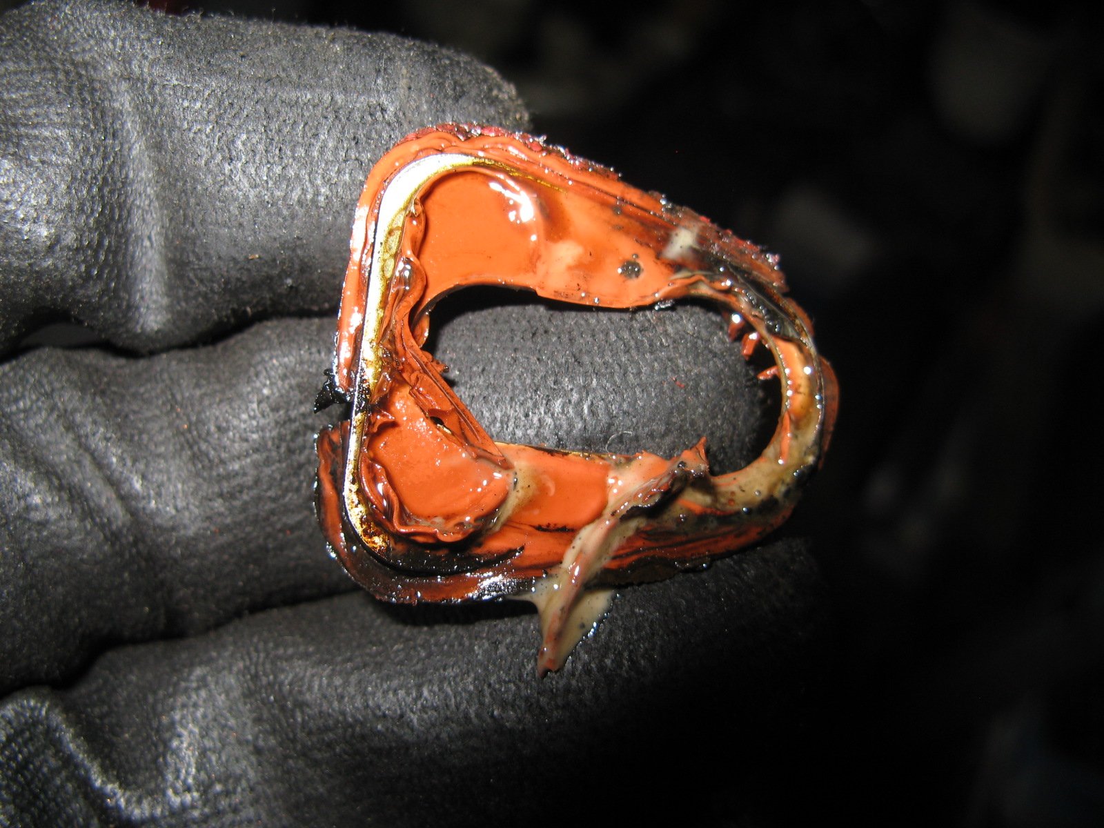

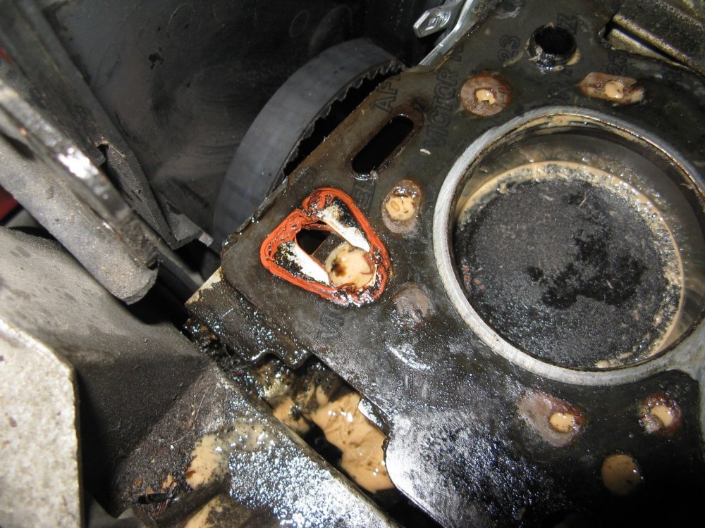

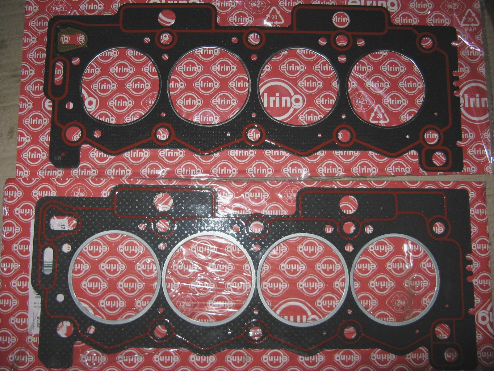

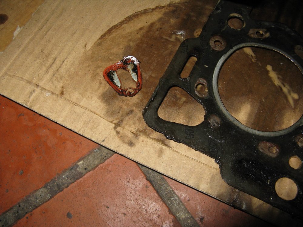

Keep wondering about these TU's why and who came up with the design of the head gasket with that dreadful elastomer/viton pressed insert on the main oil feed passage ?! They're pretty much bullet proof engines apart from this head gasket problem , and they never redesigned the head gasket from the first day of the TU series production up until they replaced it with Prince engine ... a lot of years to correct something and a lot of PSA models affected by this issue yet no one didn't seem to bother .
There's only one head gasket from Erling which is "solid" , without that insert , unfortunately it's for 76mm bore engines .. all the others both OE and aftermarket are with the insert .

The TU is a redesign of the X with plenty of design features shared... but the oil feed was moved.
Some of those engines had a non bonded circular Quad-Ring like seal that you had to put in place yourself but others didn't. You don't hear much about head gasket failure and it's a very good thing when your engine block is slanted at 72° to the back!

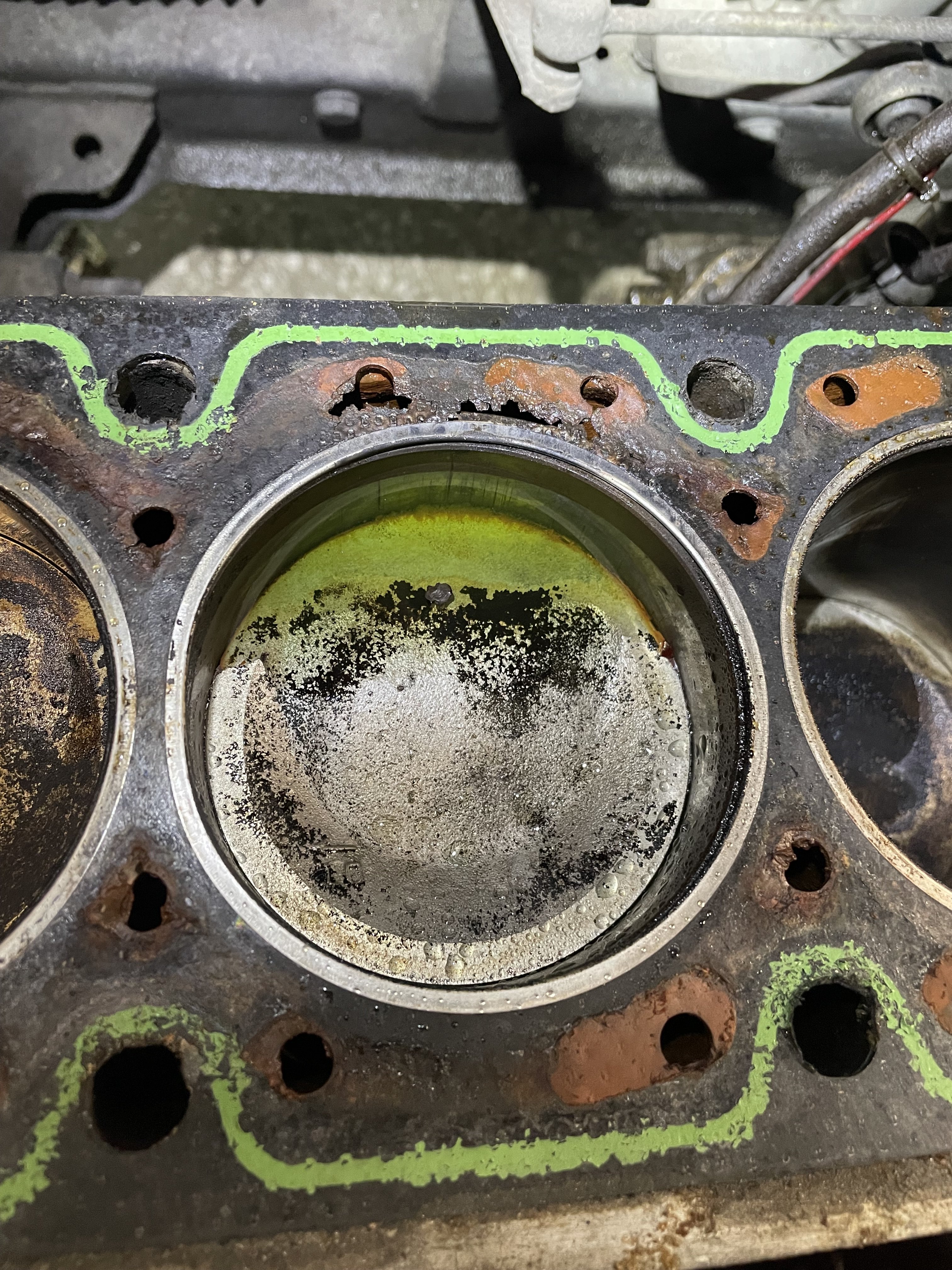

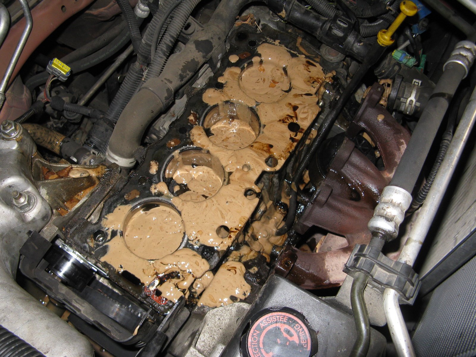

I found water leak in the cylinder #2. Cylinder head removed and then the guilty found, the head gasket.
It was easy to slacken the head bolts. I thought cylinder head not torqued properly. May be this caused the gasket problem
check the block has not cracked across the back at the base of the liners where the head bolts pull up.

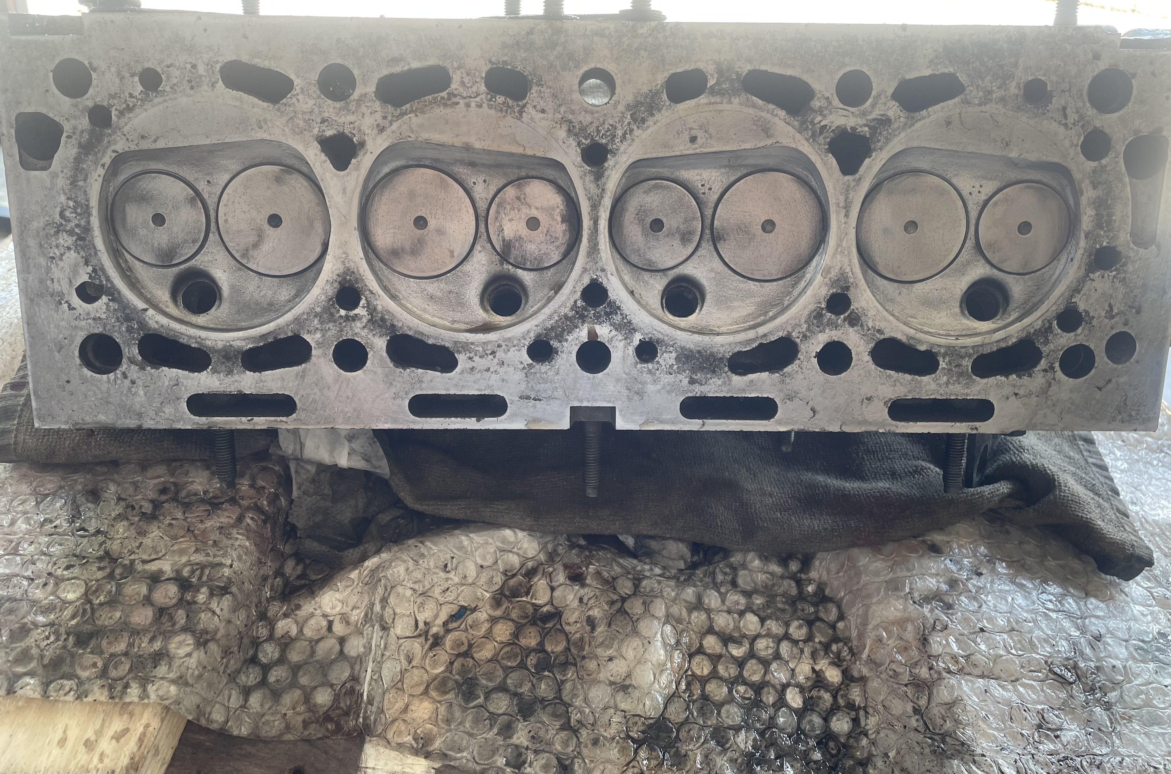

I was happy that the problem would be solved by simply replacing the cylinder head gasket. Unfortunately, when I finished sanding, I found that the head was cracked. What a disappointment.
