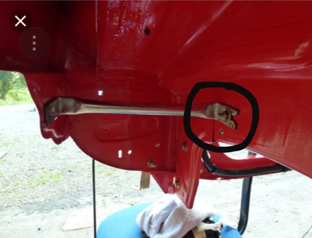

Is it possible to remove the front bumper by removing the middle t bolts and then undoing the nuts that hold the corner supports to the body and lift the bumper of with the sliders etc still attached? I've circled the bit I mean in the picture below

No.
The sliders on the bumper are held to the support bar by the T bolt and nut,  you have to undo that ( on the left side of your picture if it was fitted) to remove the bumper.
As stated already they are generally corroded to hell and just need cutting out and replacing- preferably with a stainless after market set. The support strut is neither here nor there and doesn't have to be removed

Right okay I have new stainless t bolts that I got off eBay, like you say mine are corroded so I was thinking I might have been able to remove it at the corner bars in one unit to give me better access for cutting the old bolts off but now you've said it I can see from the picture that's not possible I should have looked closer at it before posting!
Edited by Callum
The t bolts hold the slider to the bumper. Unless the sliders are rotten you should not need to disturb that. What you probably need to replace are the top hats and rubbers that fit into the slider and secure to the corner bar at the outer end.
