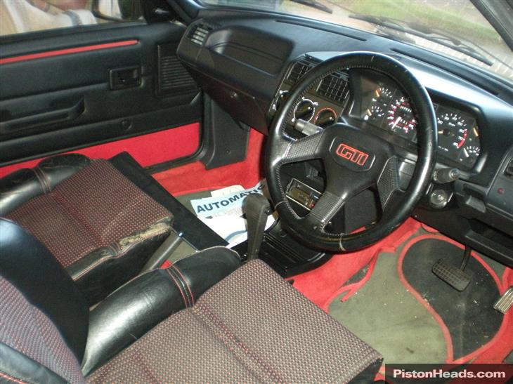

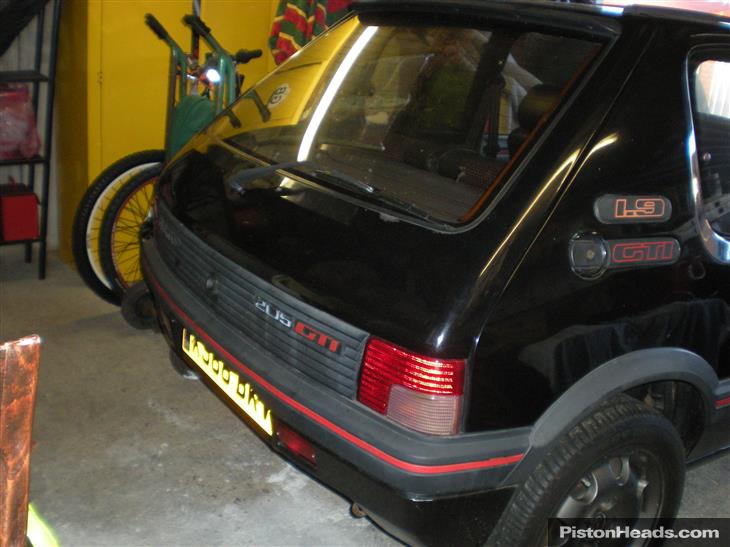

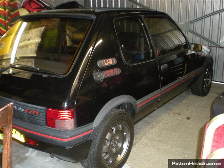

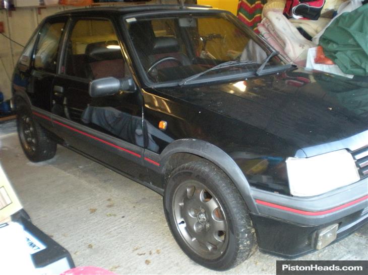

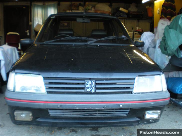

I've been away from the world of GTI Drivers for a good few years, but am glad to say I have returned in style,
Some of you may remember me from ages ago as I've had a fair few 205 Gentry's including 2 Sorrento ones and 4 Aztec gold ones and 1 205 GTI 1.9 Automatic in Graphite Grey.....
I must say I've always had a soft spot for 205's, and was rather gutted when I got rid of any of the 205's I had especially the 205 GTI Automatic (many of you know - only 10 where brought to the UK) after Japan didn't want the order.......... There loss our gain!!!!! :)
I am disabled hence needing an Automatic!!!!!! I always promised myself if any 205 Gentry or GTI Auto came up, Id sell my soul to buy one, just to get in to a 205 again..............
Well.................................................
I decided to start keeping my eye out for any Gentry as I didn't think Id find a 205 GTI Automatic in a million years as I checked the Howmanyleft website and there was only 3..... :( 2 sorn and 1 registered on road...............
After a good year or so I found a 205 GTI automatic....:) one of the 3 remaining in the UK...... so so HAPPY and cant believe my luck.... Told you I was back with style.....
This Will be my project thread ......
Some of you may know this vehicle, If you do????? any info would be great On a K plate.....BKV
Happy to be back!!!!!
Cheers Phill
