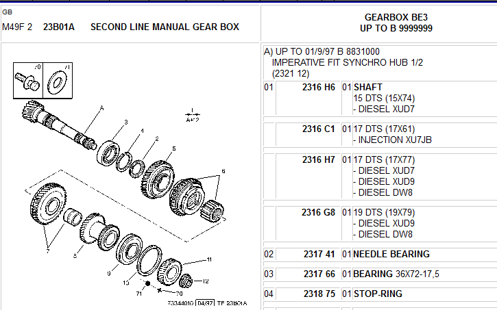

Looks like it has to be XUD7, but it appears there are two options!
309jazzpanda
I know its from the non turbo diesel model, but rare

The other thing you need to watch is the Dia of the Pinion shaft, later ones are smaller so you cannot use the 205 gears
you could just buy a new one from a pug dealer, they weren't limited to the Partner/Berlingo.
