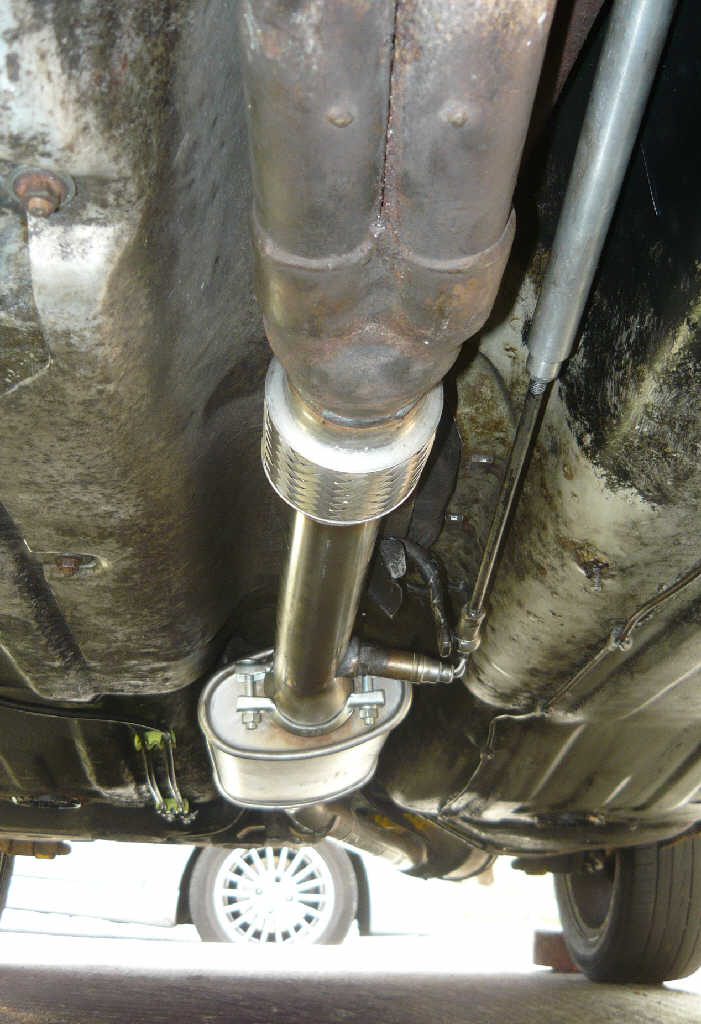

Another question, with regards to welding in a boss- is there a standard distance down the downpipe they should be? Presumably the same as the cat equiped 205s? Does anyone have a measurement or a pic of a 205 downpipe with a lambda?

I don't think there's anything special about the xm lambda. I have it because I got it new and genuine for £15 on eBay. I suspect a decent 4 wire is fine. On position, you can't really go wrong. It has to be after the downpipe split, but before the pipe narrows just after the split. That gives a distance of about 50mm and the lambda is around 20mmso not much leeway. It can't be on the bottom half of the pipe or water can build up in it and cause damage. It can't face up or toward the gear linkage or it fouls, so you have a really small available space. I just put it in the middle of that space, just above the exhaust centreline.

I just got the boss fitted into my four branch when I was having the swivel joint changed to a flexi type, the place I got that done had the boss in stock & welded it in after the flexi joint, roughly in the same place as the location of the cat equipped cars lambda boss.
There are pics in a topic of mine somewhere, I'll dig out a link later if I can.

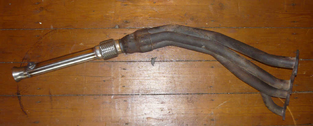

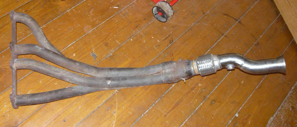

I did mine (all be it in a four branch manifold) slightly further back than that, basically after where it has narrowed down at a similar point to an oe fit cat downpipe.
First go as above;
This was too short to mate up with the standard cat middle box I planned to use so I modified it further;
As fitted;
As you can see, I fitted it quite a long way back so I had quite a lot of pipe to play with.

Thanks for the pics Graham :) I've offered the exhaust up again, and moved it quite a bit further back. Luckily only a small hole to weld up! :D
