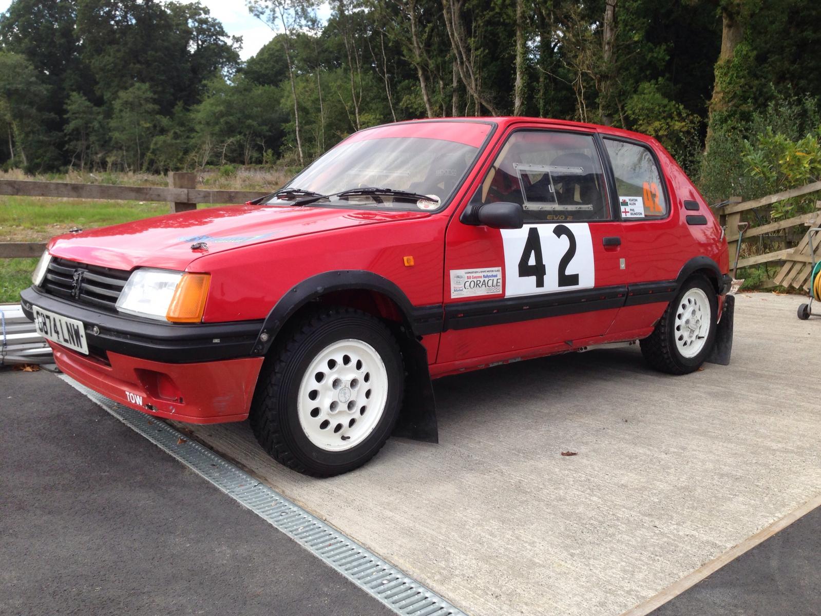

Below the car after a day testing at Sweet Lamb,
Very pleased and excited for my first event.
Fortunately it was a Tarmac car so there's a heap load of gaps to
Seal.
You would think it's just done a Dakar #dust!!

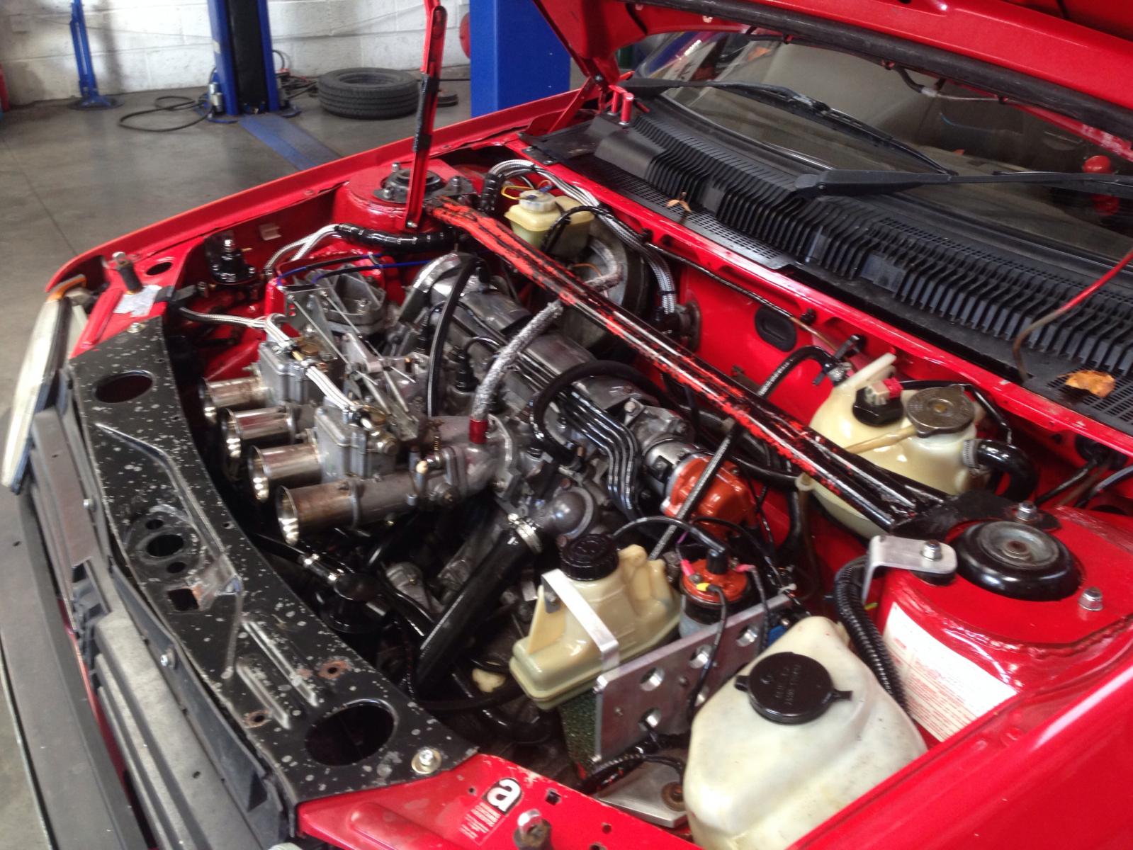

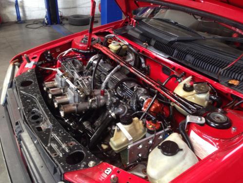

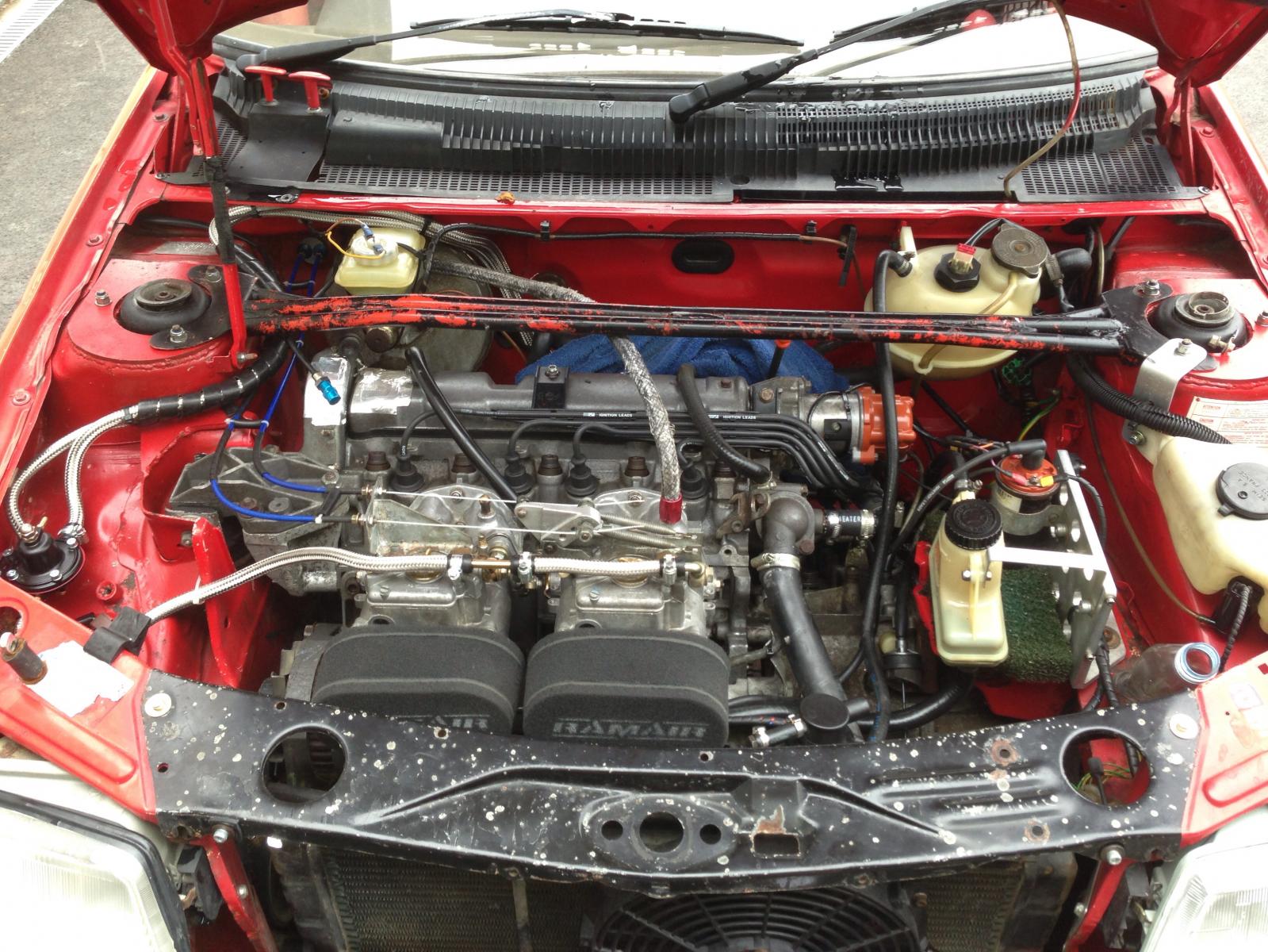

As it's running on carbs it was setup with an
Inline fuel pump.
This was removed and I'm now running a standard
Fuel pump with a pressure turbo pressure regulator.

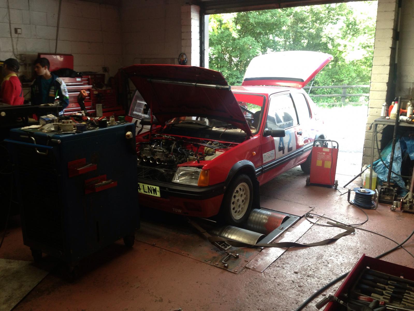

Added with a full setup of the carbs and a rolling road day.
Money well spent as it's now running like a watch,

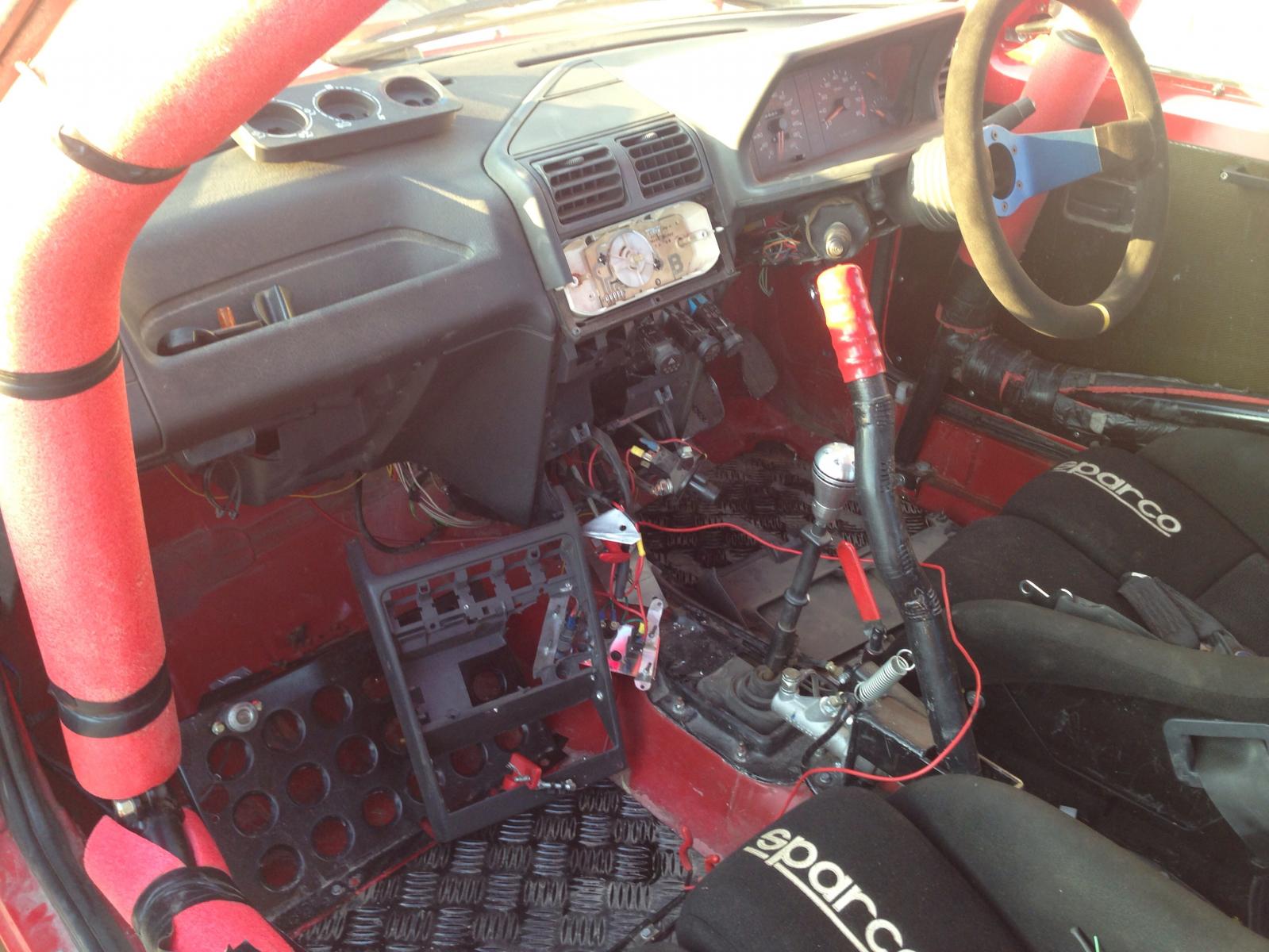

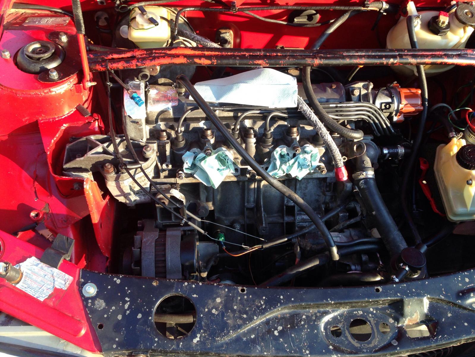

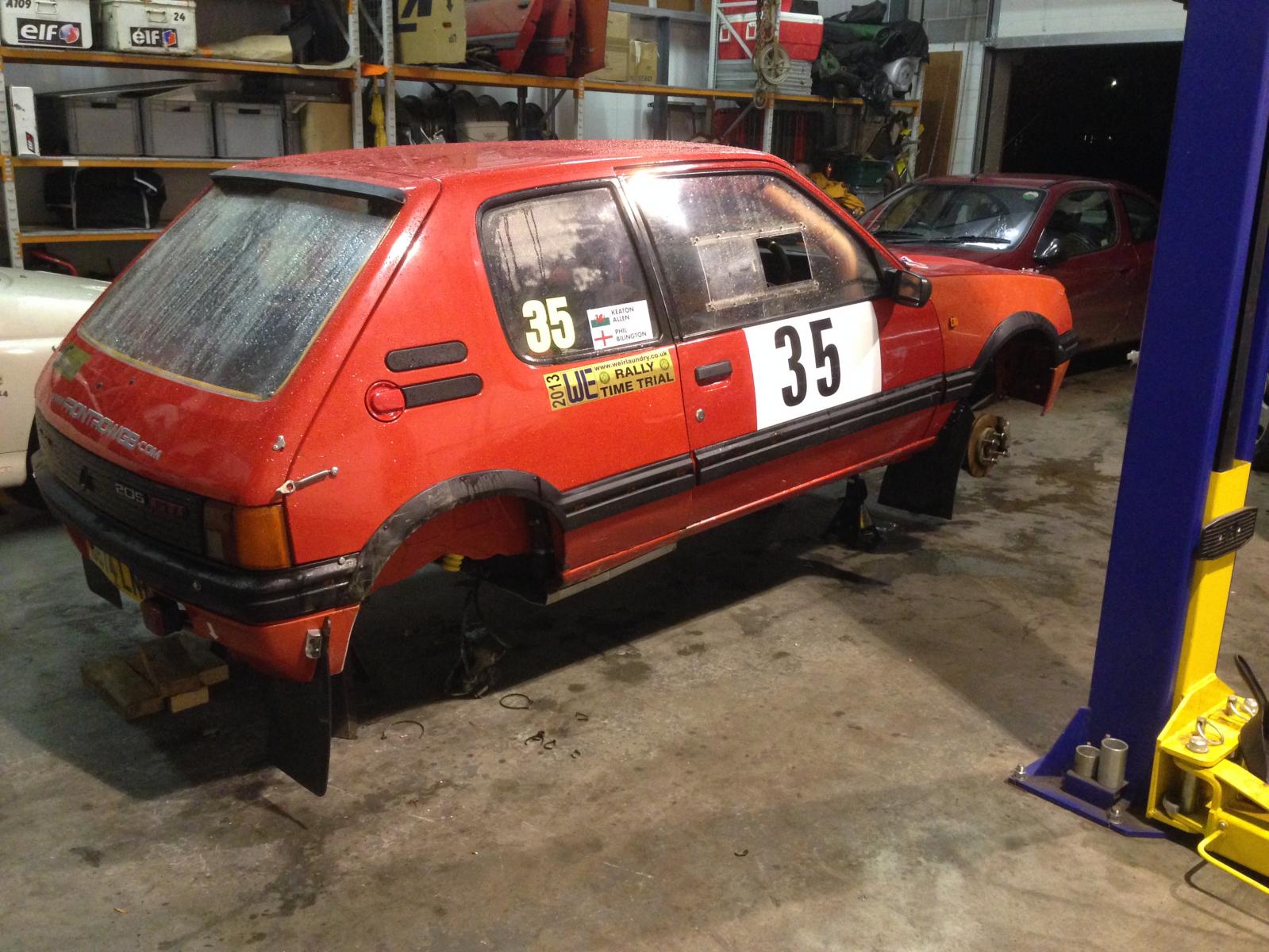

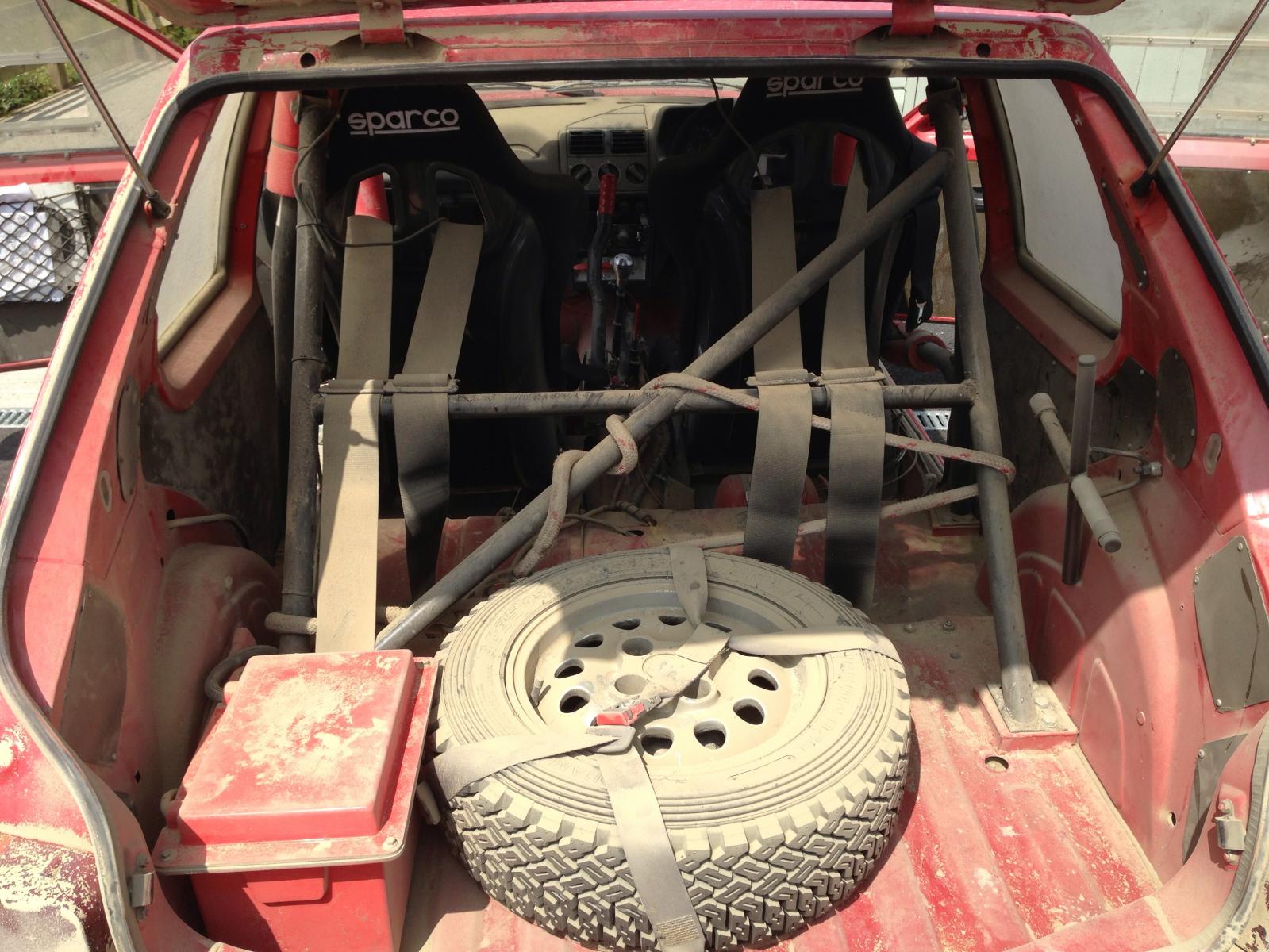

Some stripping out !!

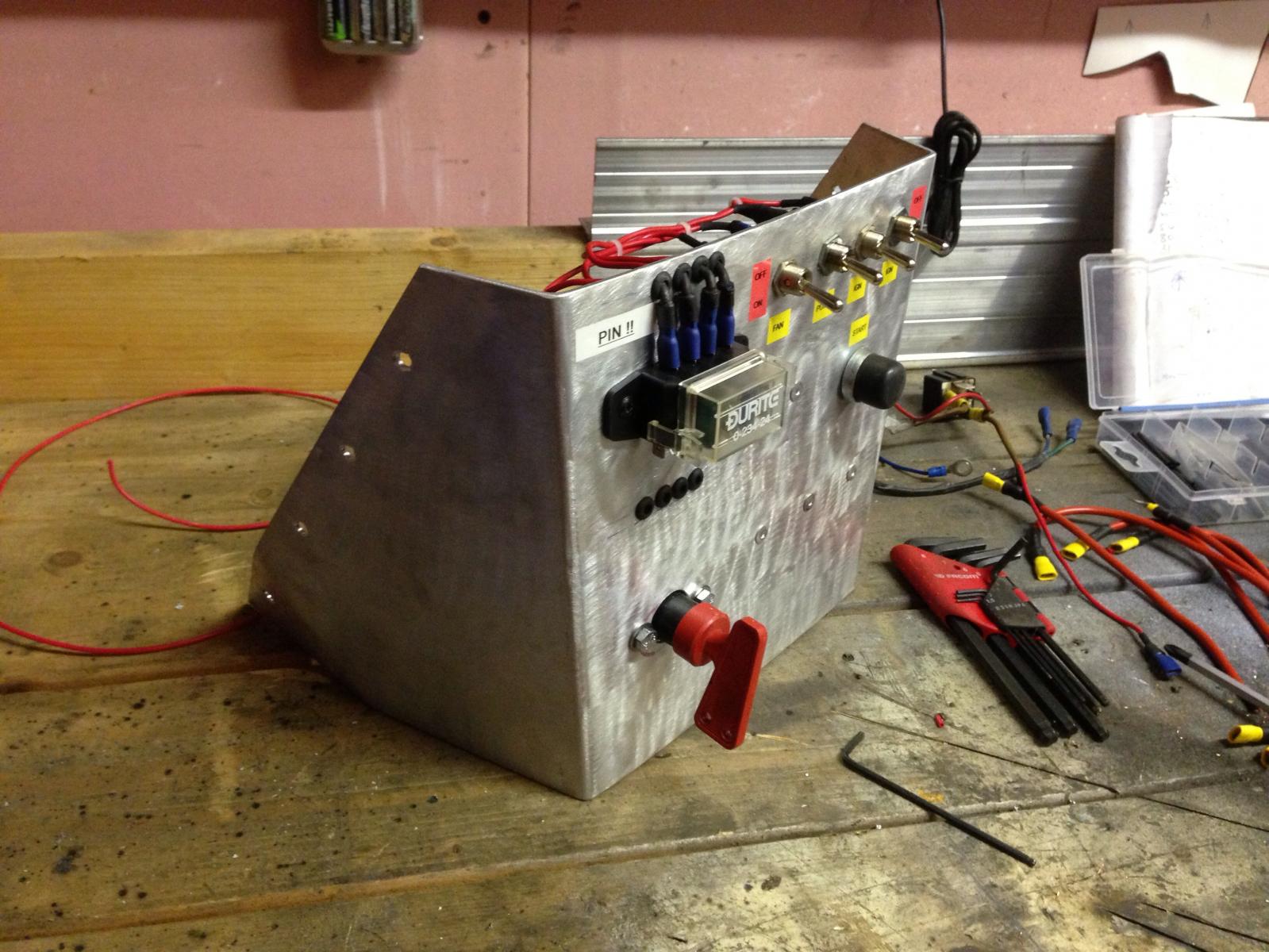

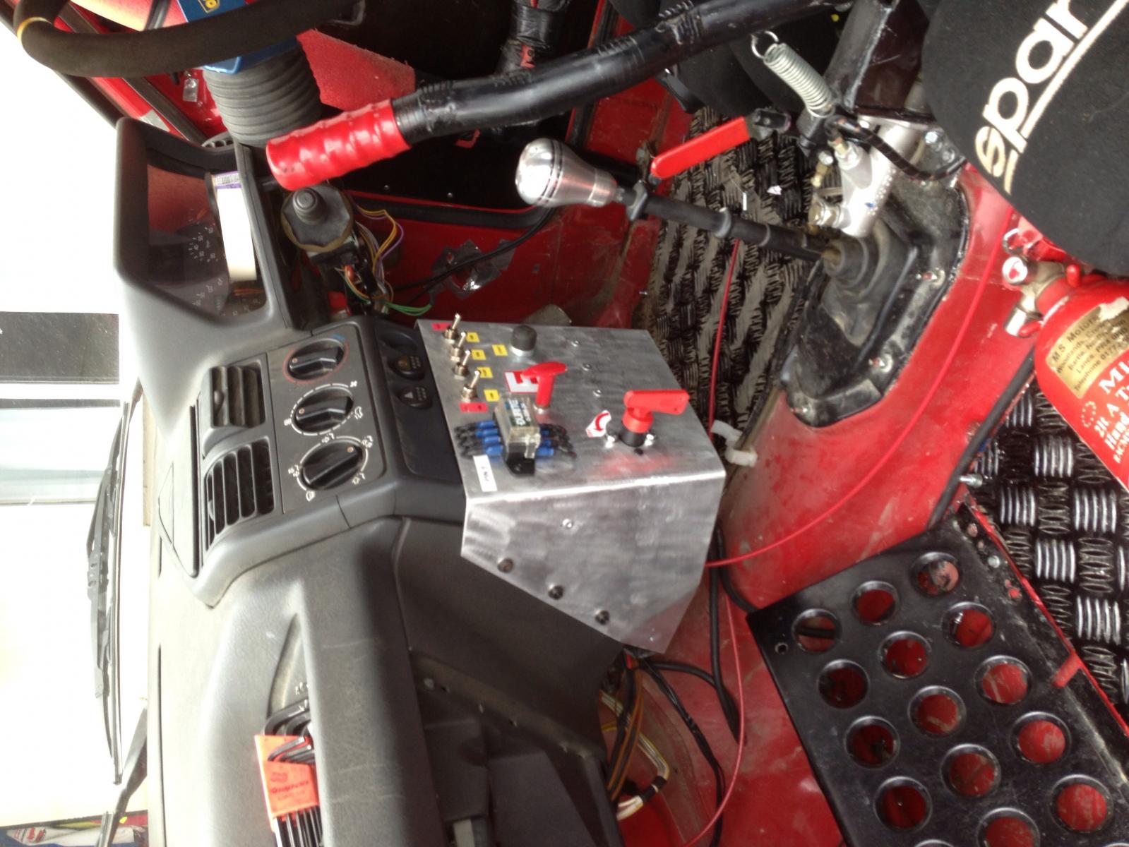

Shocked to find house cable running through the car!! Rele?!
Thought I'd make a new switch panel. Bit of work but very pleased.
Carbs back on and rolling road day!!
All ready for the next rally!!

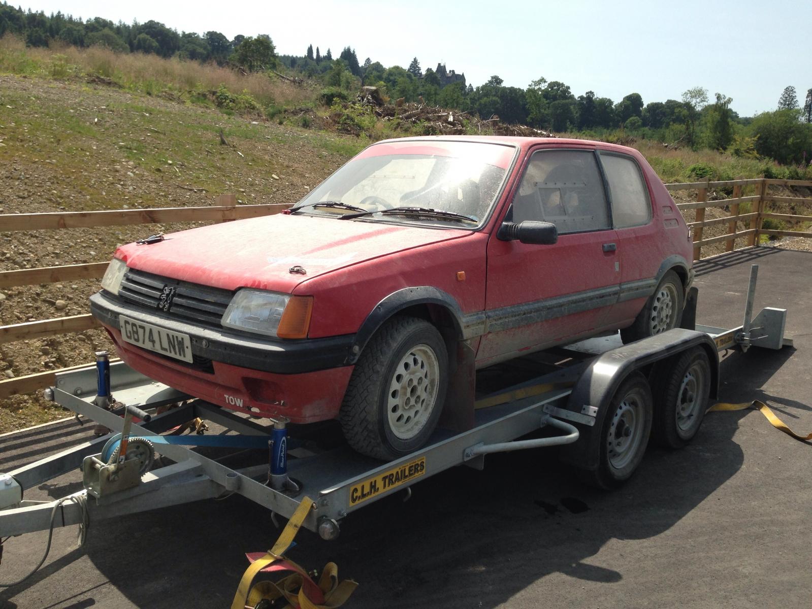

Keaton

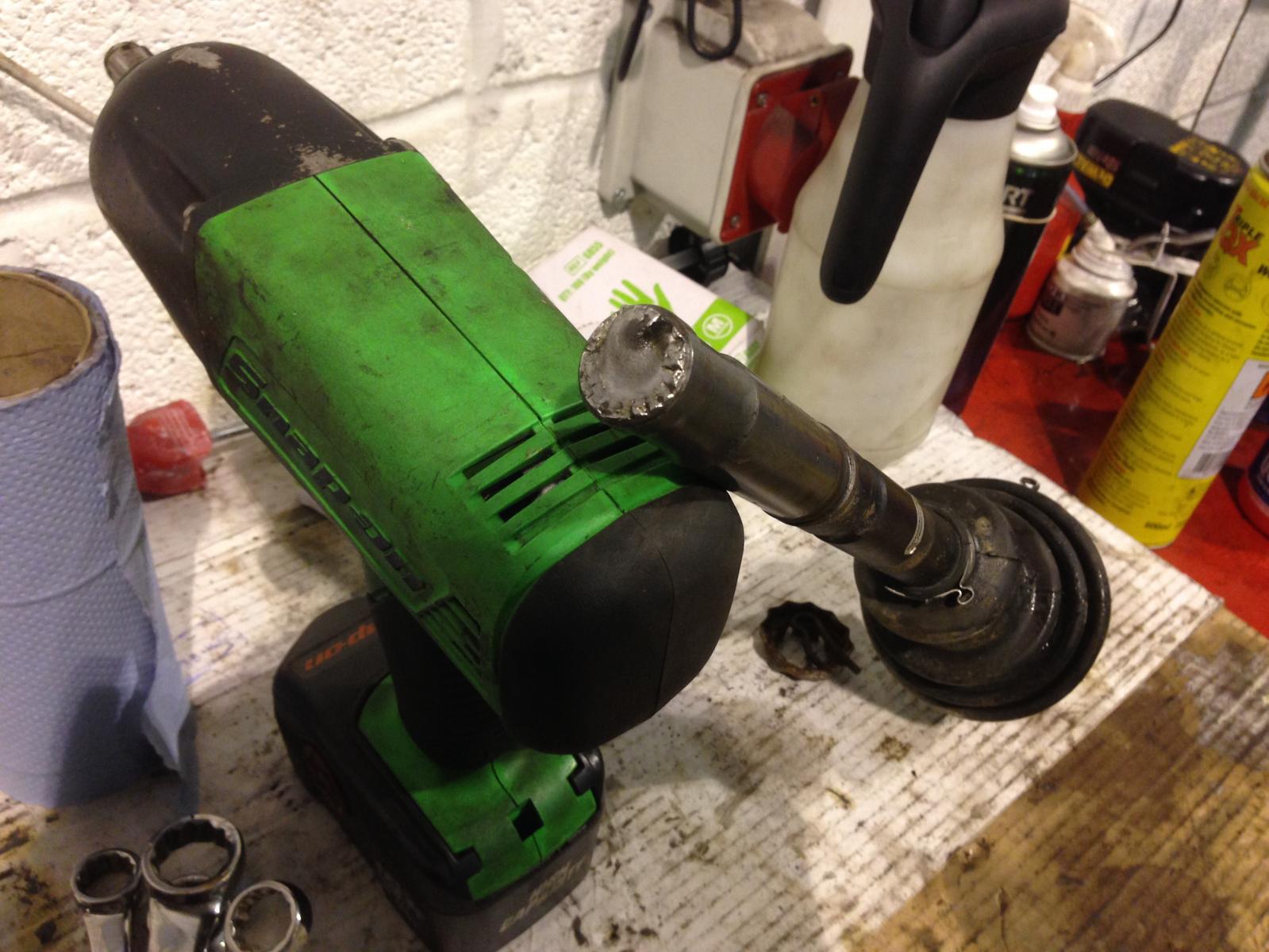

Yet again, didn't finish my second rally due to snapping a shaft.
this has now lead to me making some improvements to the car.

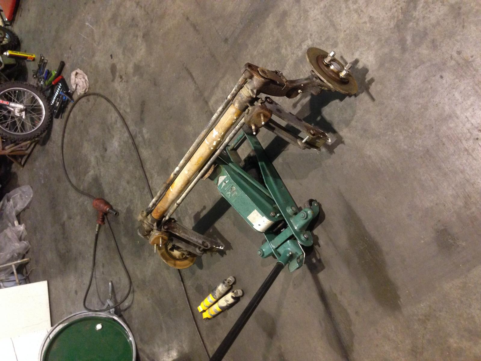

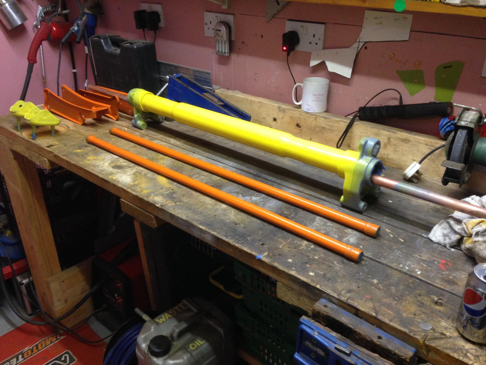

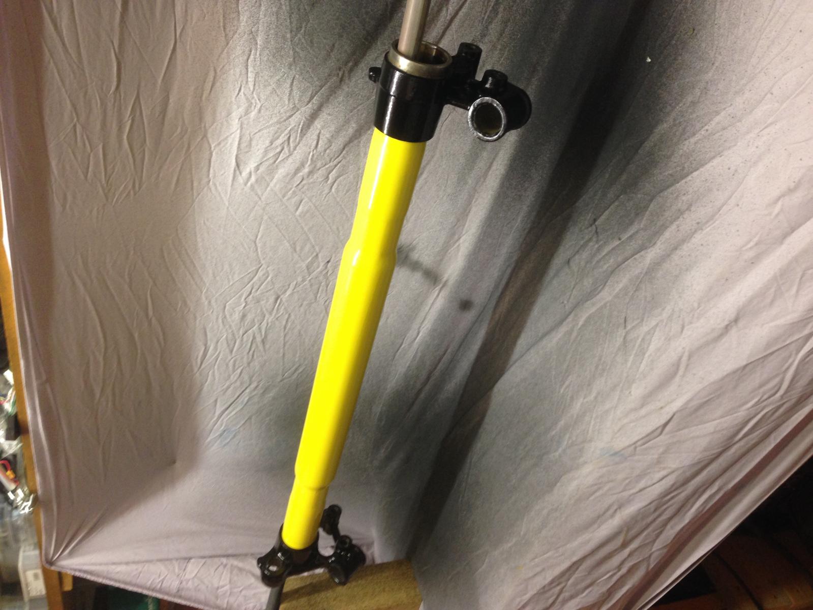

rear beam is off and im currently rebuilding it and raising it back to the correct height.
suspension and top mounts ordered ( AB MOTORSPORT )
custom made drive shafts ( Colin Satchell engineering)

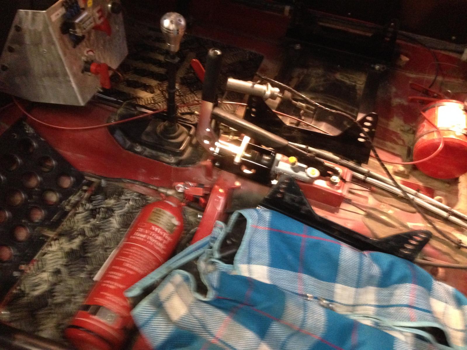

new hydraulic handbrake to do away with the huge thing it currently has.
then test.. cant wait!!

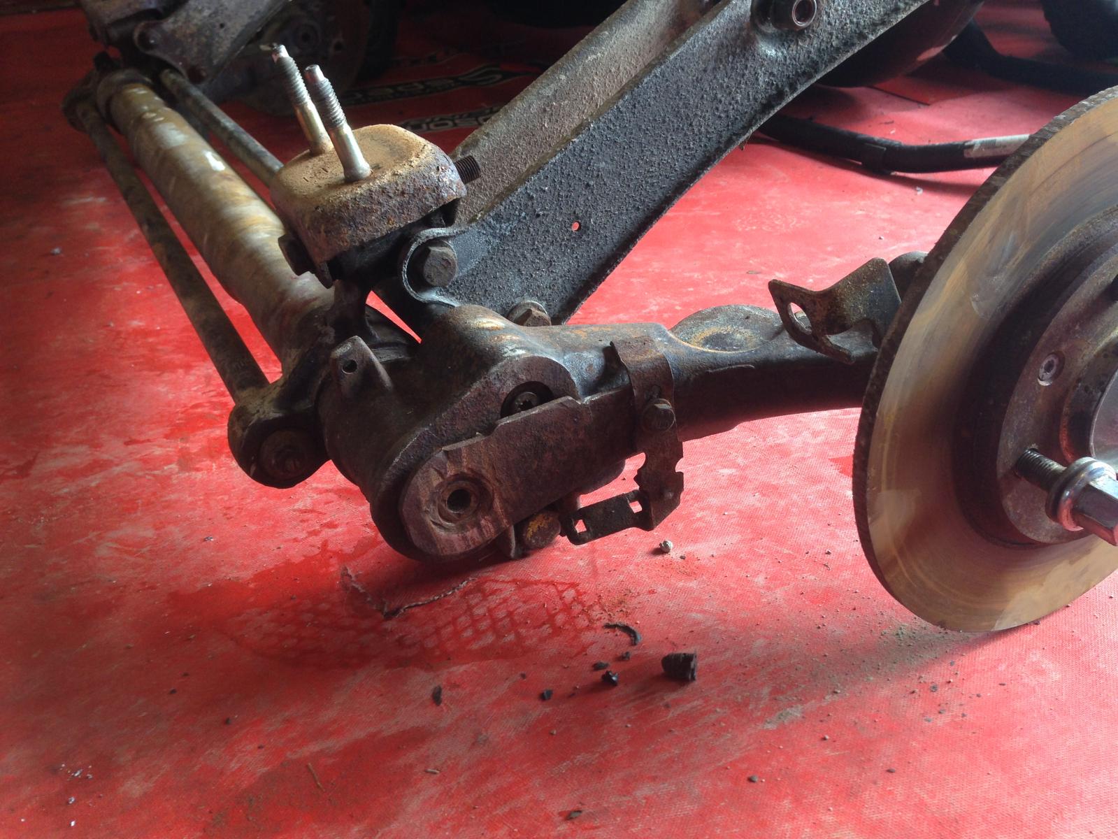

the culprit that has caused me to do all this work.
beam off ready to strip

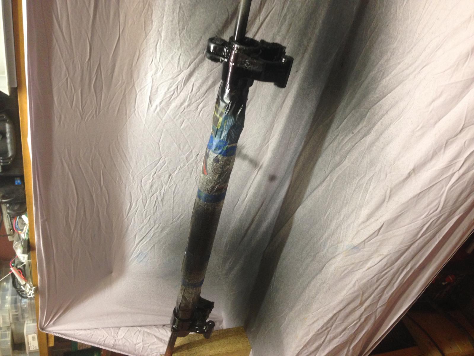

all stripped and painted.

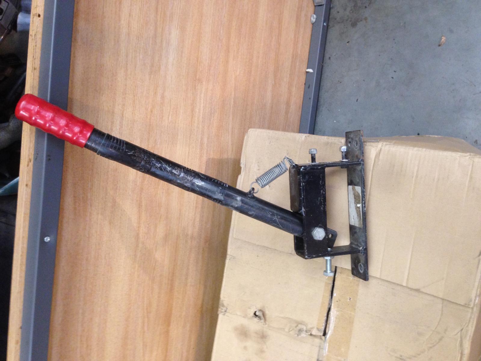

out with the monstrosity of a handbrake and in with the new. (not connected)

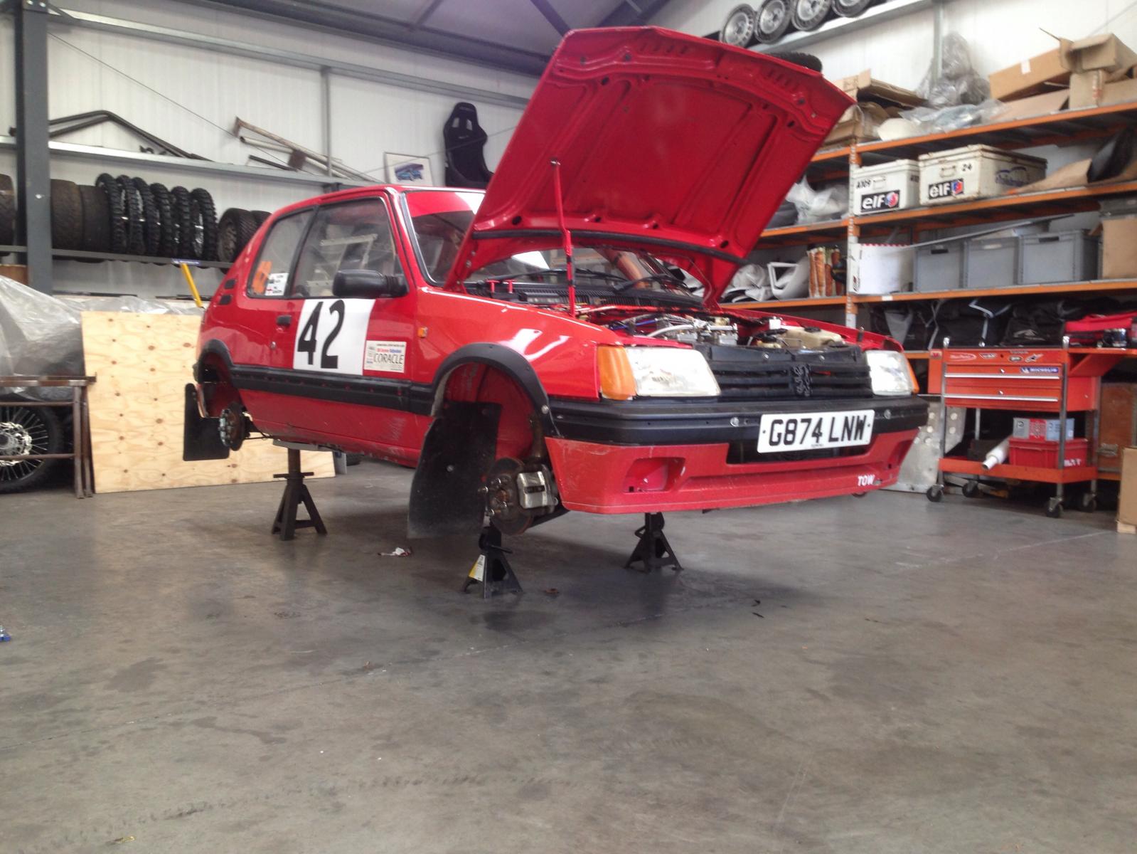

car now looking sorry for its self.
I'd see about getting that old handbrake lever fitted, those little ones are pretty useless on 205 calipers :lol:
Keaton
ohh no way. i was thinking of extending my new one.
would that work?

jdt
standard driveshafts are fine but you must keep off full power on full lock.
Check the plunge by undoing the hub nut and seeing how far the driveshaft will push in (no more than 20mm I think) ans same both sides - if not move engine / box across by slackening mounts. If too much plunge then use 309 shafts
