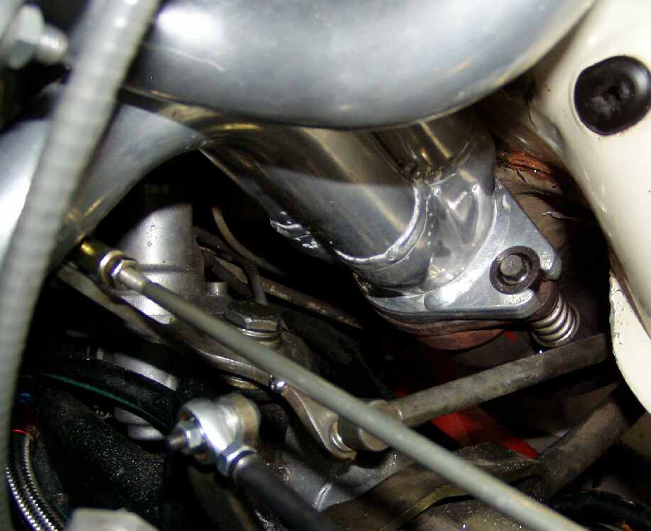

While stainless steel would stand up to it better, the effects of wrapping a mild steel exhaust can be pretty horrid...
Here's a pic stolen from another thread.. (it's probably a low budget manifold but you get the idea)
I'd stay well away from it to be honest.
