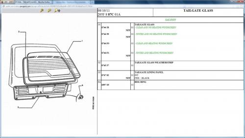

As random as this sounds I have an empty boot lid and a glass unit.
How do I out them together..? Is there a rubber or is it just stuck in with mastic..?
Slo
It has a rubber seal same type as the windscreen. Servicebox showing as £27.70 from main dealer if you can still get them.
Daviewonder
Its bonded in mate.
Paul_13
Ditto ^
Bonded in
The rubber trim is just cosmetic, the glass is bonded as has Daviewonder says.
I got a new rubber trim not long ago so they should still be available. In fact I ended up with two, I'll try to find it and list it in for sale later.
MiniGibbo
Thanks guys..!
Ill keep my eye out for the 'for sale adveer
2052006
How does the rubber trim / weather strip fit in around the glass? Can it be fitted with the glass in place ie. already bonded in?
Also just called the dealer. £27 for the weather strip, still available from the factory, apparently.
