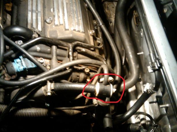

hello
i'm wondering if a brake vacuum amplifier (4575.19) on s16 could be replaced by a normal fabricated 'T' joints..i realized that the original parts acts like an actuator to the electro valve..whats missing is this original part replaced by the fabricated one...without the one way valve
i would appreciate if someone could explain about this
cheers
you can still get those new, they are used on the gti6 engine as well, I may even have one I could post to you if postage is not prohibitive, but you haven't updated your location field, are you on the Death Star?
As to the effects of running it direct, there's no reason you can't, but you may get a pulsing effect at low RPM.

welshpug..
thanks for the explaination on the thing...i really appreciate it
