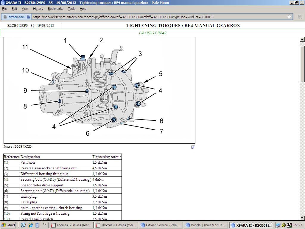

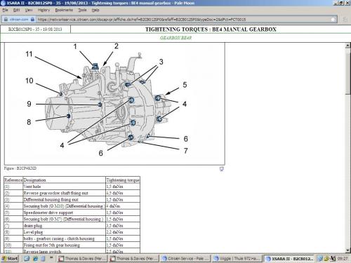

This is BE4 citroen specs, can't find BE3 listed anymore.
S@m
And....

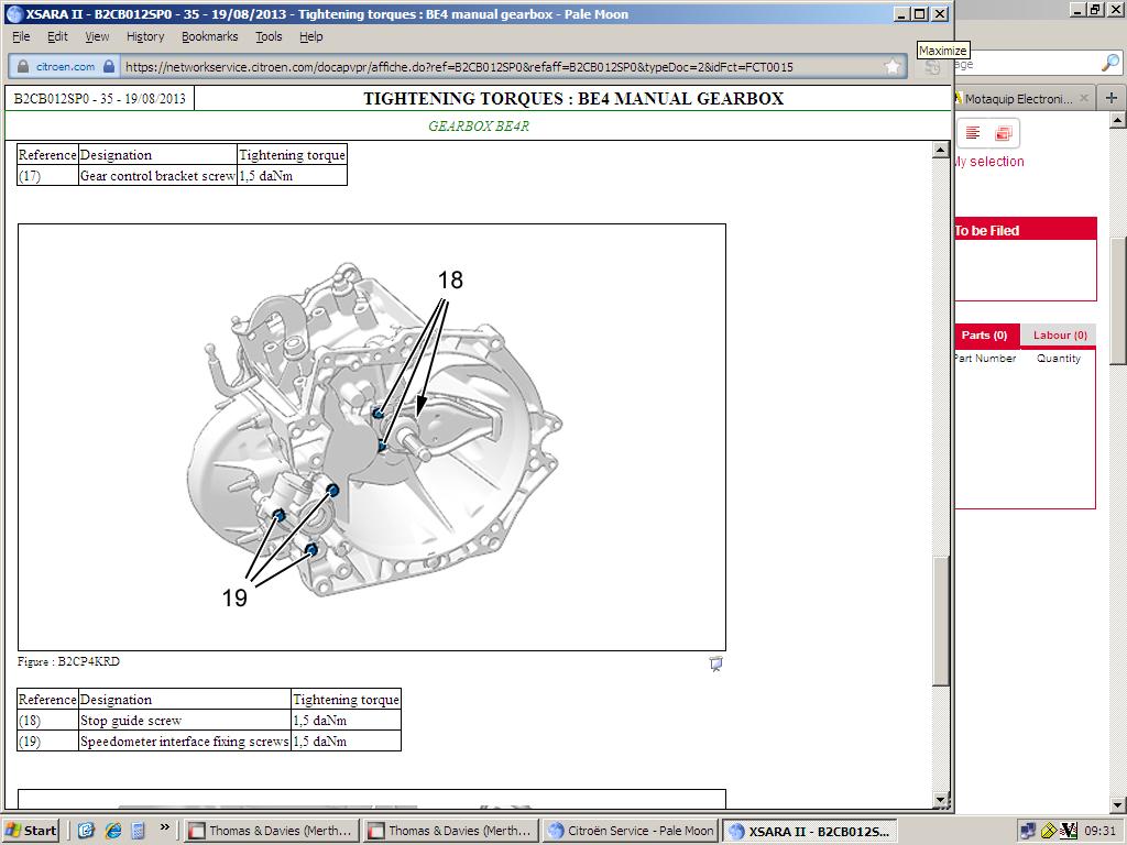

Thanks Sam for the useful diagrams as it is bolts 3, 4, 6 and 19 which I was after. I have also learned that 1 daNm = 10 Nm (well I assume so anyway!!)
S@m
Yep, for some reason all the torques are in daNm on cit service. No probs on the diagrams. :)
