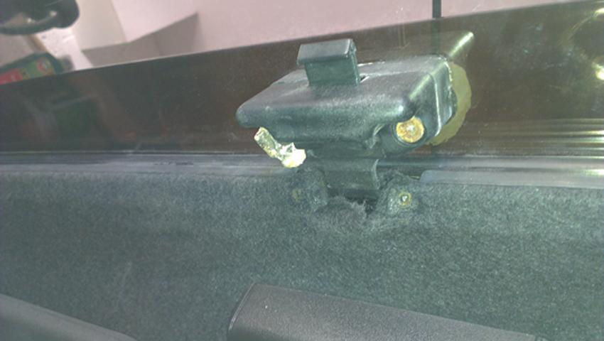

chipstick
Here's the bit that's missing.
E5FA9B67-BAE9-4A18-8E62-BE1FC2DA7376-193
Apologies for the delay :)
JamesE
Ah brilliant, thanks for that. Just got to try and find the piece now lol...
