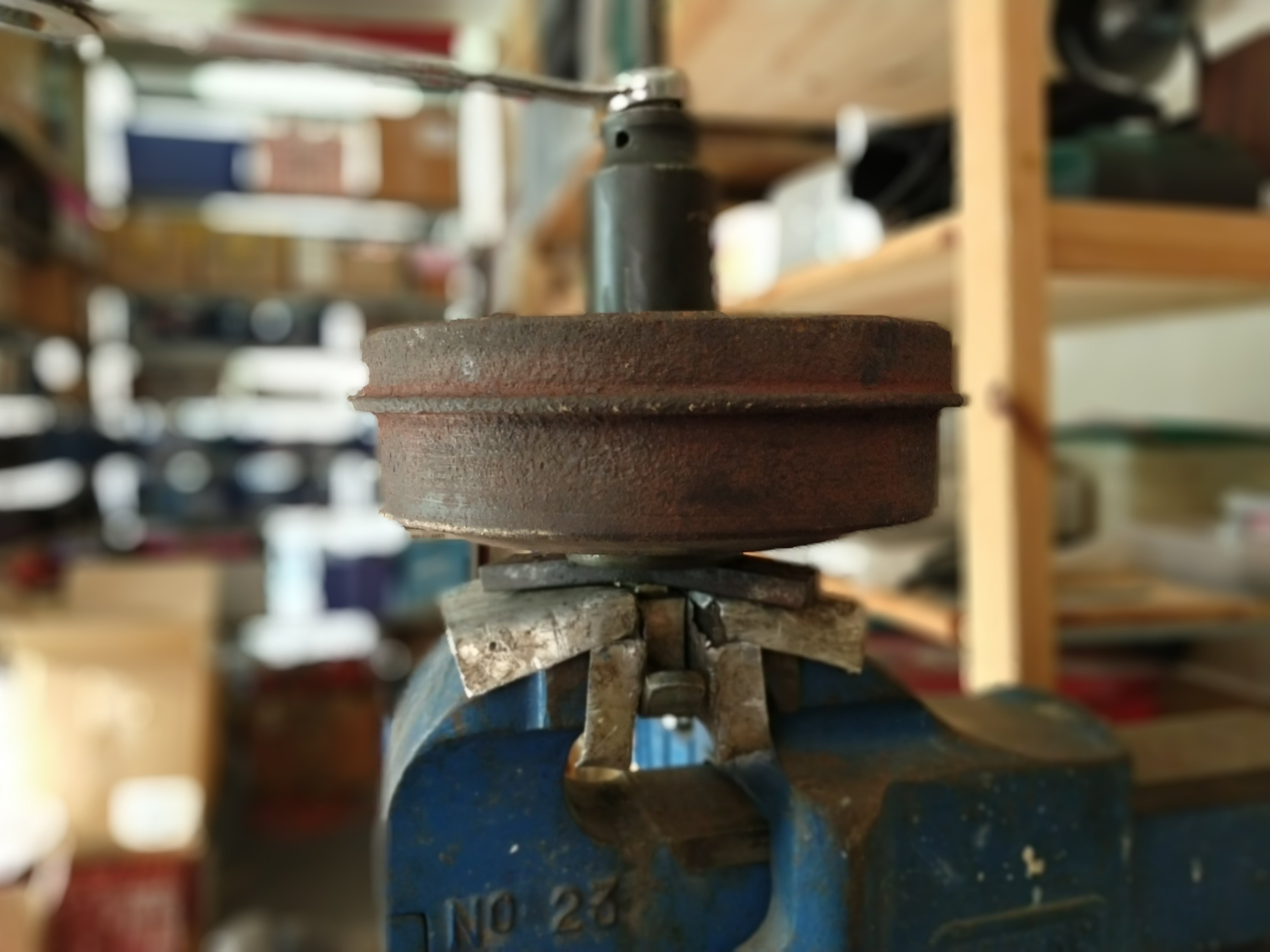

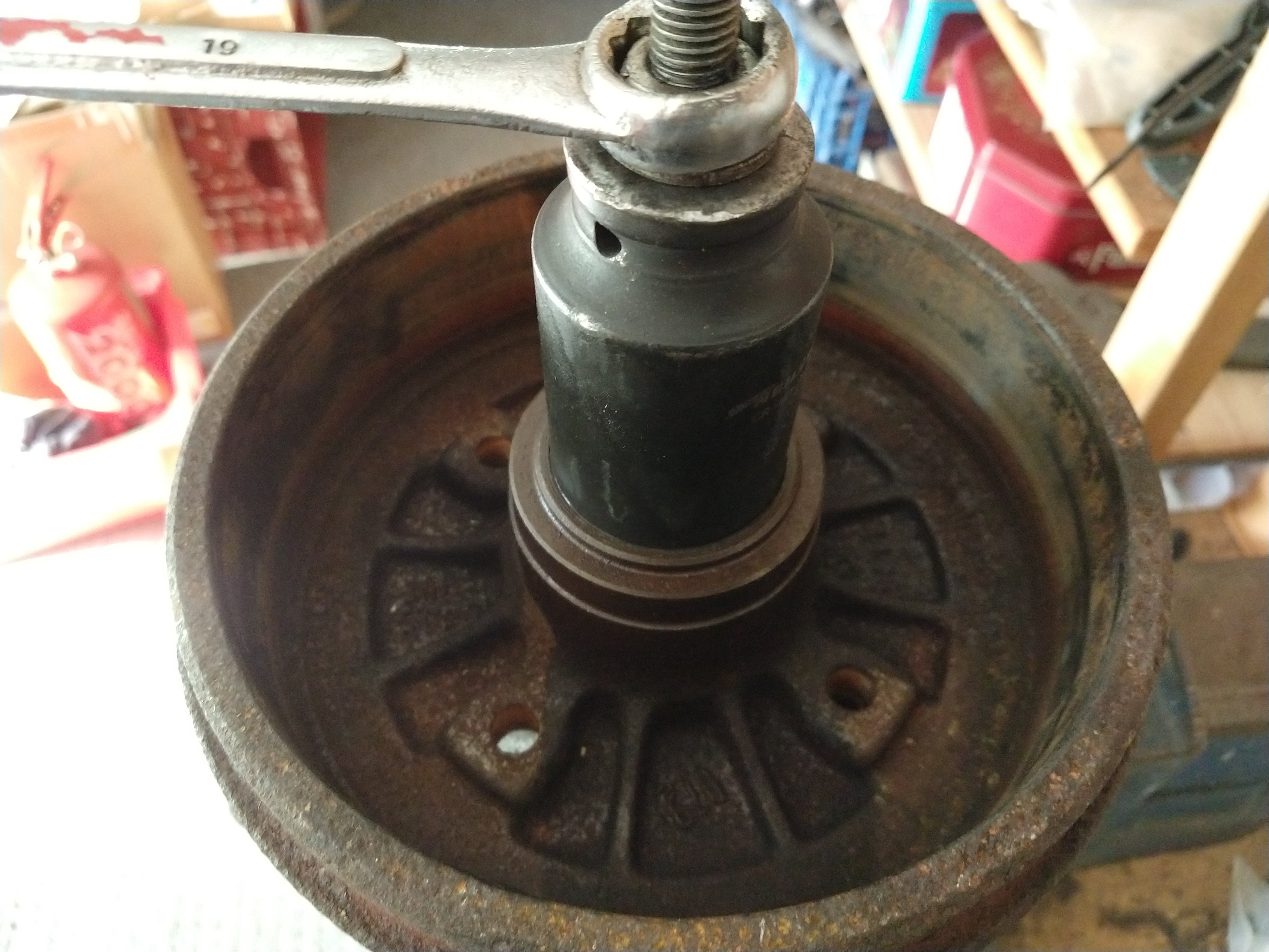

Tom, I think I am in this same position - With some help from Mei, I finally got a very stubborn circlip out, but both inner races are stuck in the drums and I have no access to a press.  I have tried making up a 'puller' from a spring compressor - see photo - but it won't budge.  I want to try what you suggest - but am confused over the references to welding the inner race (which fell out in pieces).
Edited by ArthurH
Typo
Take it to someone with a press, its as easy as that.
