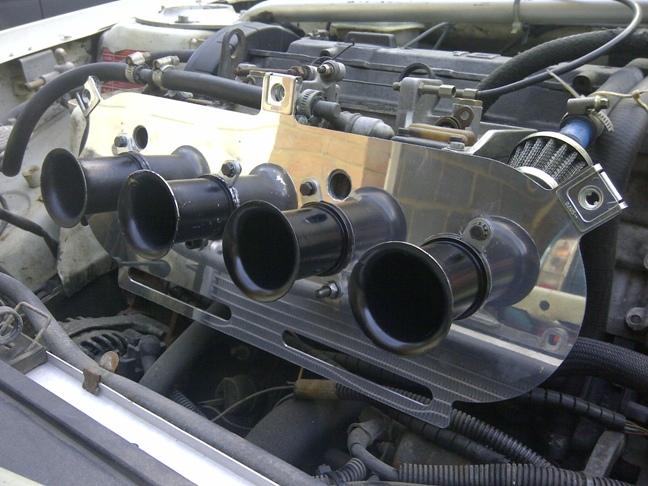

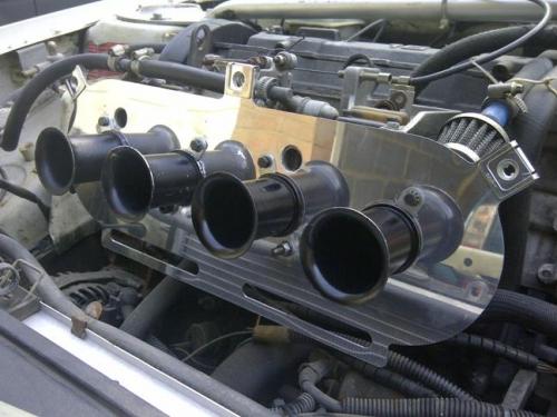

I have finally gotten around to bolting on my new filter and 60mm rampipes, assuming they improve airflow over not having any rampipes, have people found the fuelling/carb settings needed adjustment?
It’s in need of a RR check up reasonably soon, but just checking if people have had issues when bolting on rampipes.

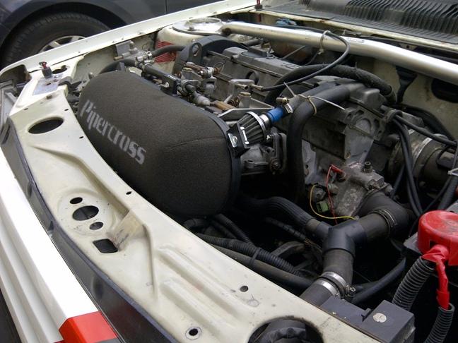

The filter just about fits behind the slam panel
make sure you have enough space from the trumpet to the filter.
fliprio
60mm trumpets, 90mm internal space, I think they recommended 19mm clearance, so 30mm should be fine

Plenty of room for a huge filter with some mods :-)
