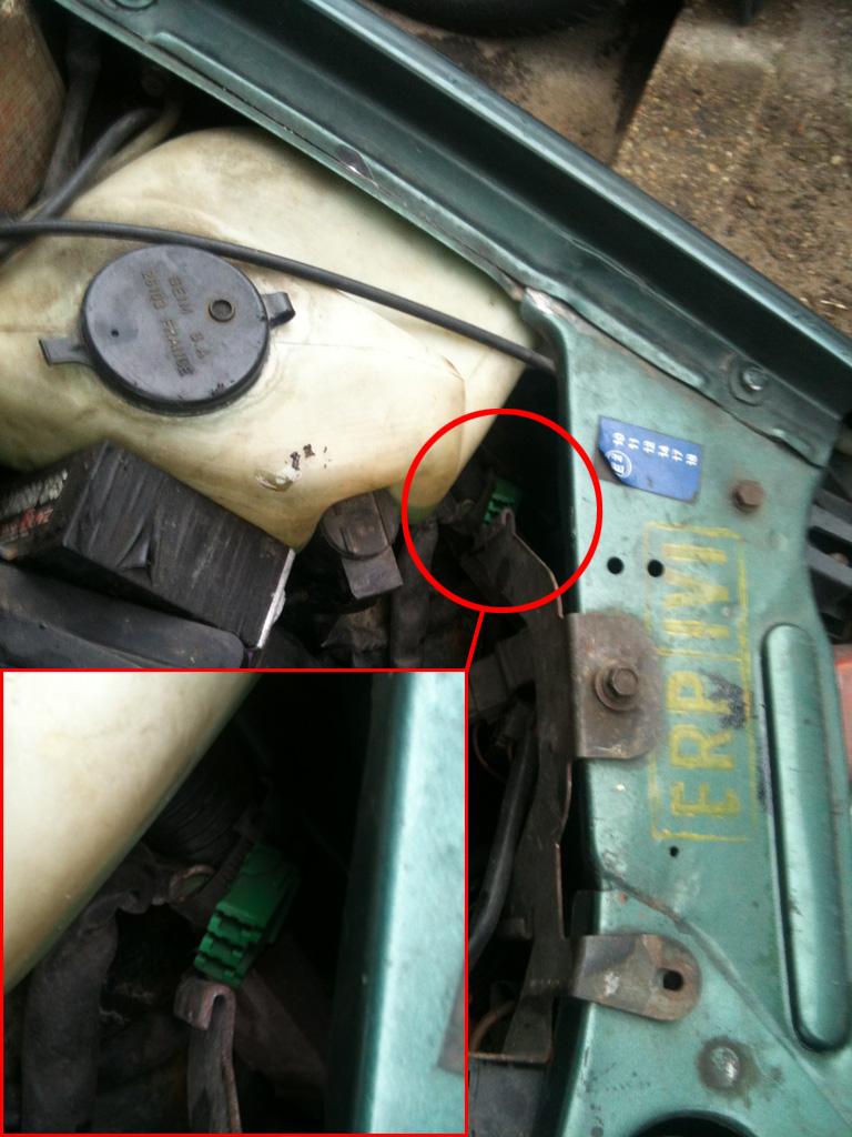

I am having some trouble with my TU3M engine on my 205 roland garros. The check engine light goes on and off every now and then, so I'm thinking reading the fault codes off the ecu would be useful. I found some info on that in the heynes automative diagnostic manual but that was just some general info. I'm sure some of You guys have done this and could point me to the right direction :)
The manual says peugeots have a green two terminal self diagnostic connector somewhere in the engine compartment. It's supposed to be somewhere along the left or right inner wing. I've tried looking for it, but the only green connector I've found is this one (in the picture). I'm not sure if this is the one? It looks like it has three terminals but it actually has only two of the three wired. So I guess this could be it?
Next the manual says one should connect terminal number 2 to ground and put the ignition on and then the check engine light would flash out the fault codes. The connector in the picture of the manual, of course, looks totally different from what I've got here (assuming this is the right connector) so I'm not really sure which terminal would be "number 2". Wouldn't want to short circuit anything here so some help from the more experienced folk would be great :) Thanks in advance!

I did find the correct connector later on, and it all worked well. The problem itself - I guess it was just something in the memory of the ecu.. it just so happened that i'd disconnected the battery and kept the car that way for a day or two before i actually did the diagnostics procedure so i guess all the error codes were gone form the memory. I did get the codes 12 and 11 which say "star/tend of diagnostics". Never got the check engine warning again after that though.
The procedure is really simple, just as described in my initial post. And it is kind of fun to talk to your car so to speak :P
I am attaching the pic of the plug. Since my car is LHD, the plug will probably be on the opposite side on an RHD vehicle. It should be on the passengers side of the engine bay though, sticking out with any other wires comming from the ECU to the engine bay.
