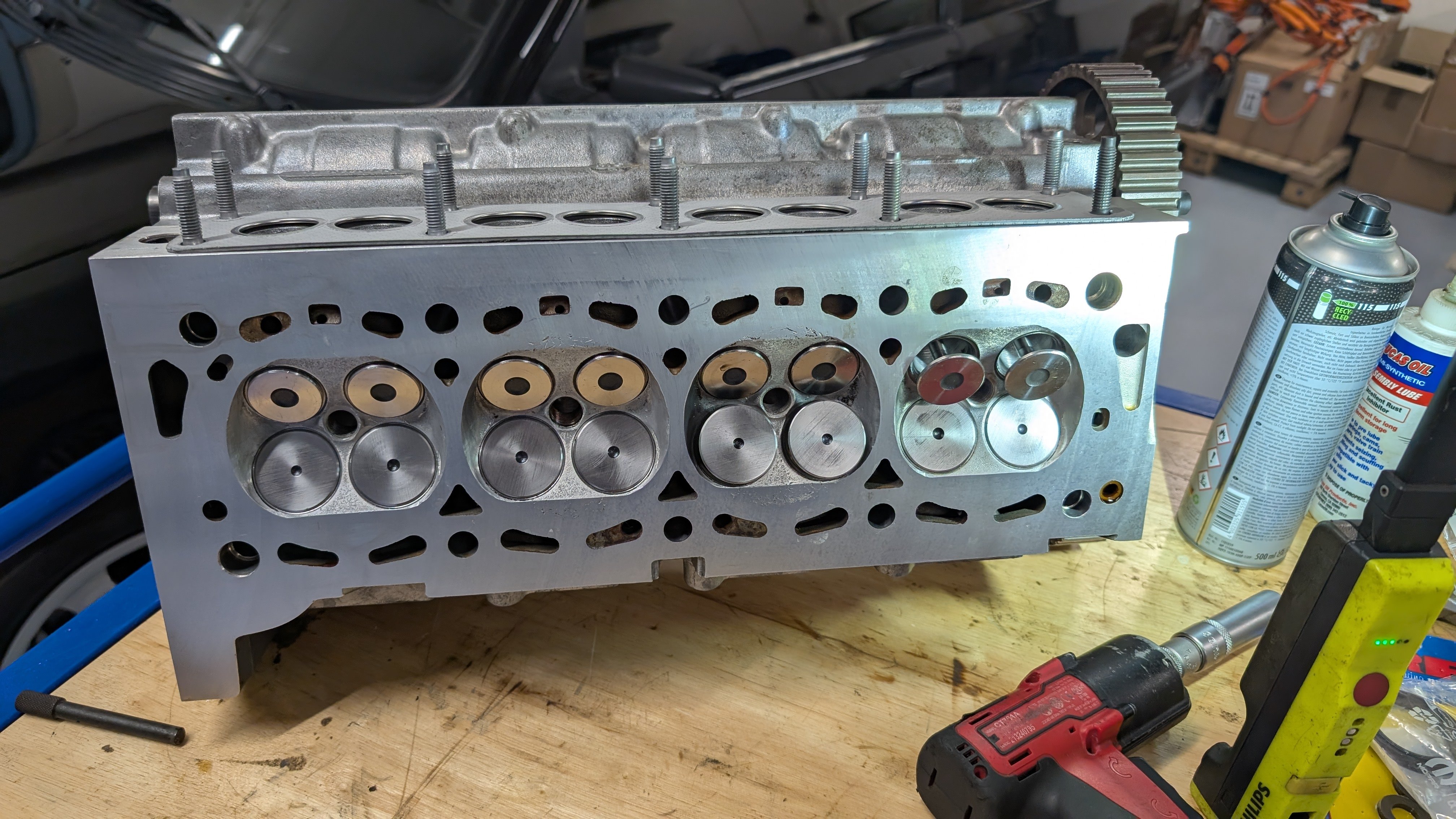

Trying to have my rods sorted out! Just ordered (2 days ago) a set of 285 mechanical piper's, verniers, double springs and caps and mechanical tappets directly from the uk! They said 5 working days to machine the blanks, and they'll ship everything together! I'm installing a set of intake valves sinus +1mm performance (stock exhaust as the bigger ones don't seem to make much of a difference) and have the ports machined out and head flow benched!
Will probably be using a set of JE k20 pistons (cuz JE has the lightness, gas ports, which I think it's awesome, and can make them in 18mm pins) -6,3cc dish and 159mm con rods to compensate for the lost of compression height!
All in all, what power do yo uthink I'll have? Were talking, fully programable ECU, ID or Deatsch injectors, stock loom, wide band, stock exhaust and 60mm with resonator and PTS muffler, and stock intake (ITB's are in a near future I hope). Hopefully this combo serves me well! I might me able to adapt a bigger throttle body tho! :rolleyes:

You still need to do a dry build and check the valve clearances, cc the head and piston, you would hope it's unlikely but it's easy for small errors to occur which can lead to disappointing results or at worst catastrophic failure.

Hey welsh! OH YES!!!! For sure! No way I'd be building this engine without cc'ing everything! Head, pistons and check for valve clearance! Then I'll choose the gasket accordingly! I'm hoping I'll get upwards of 220 bhp! That'd be awesome!

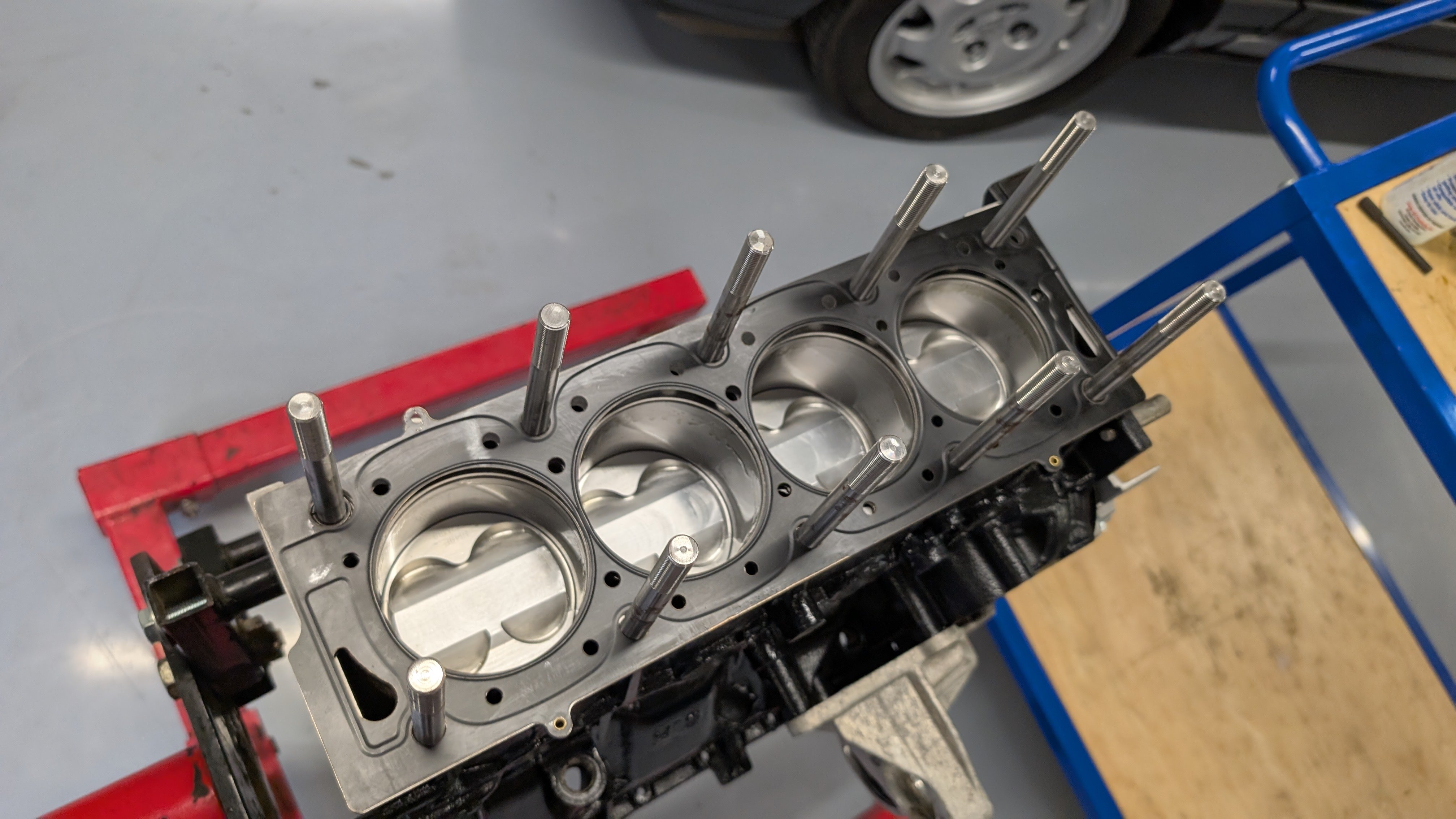

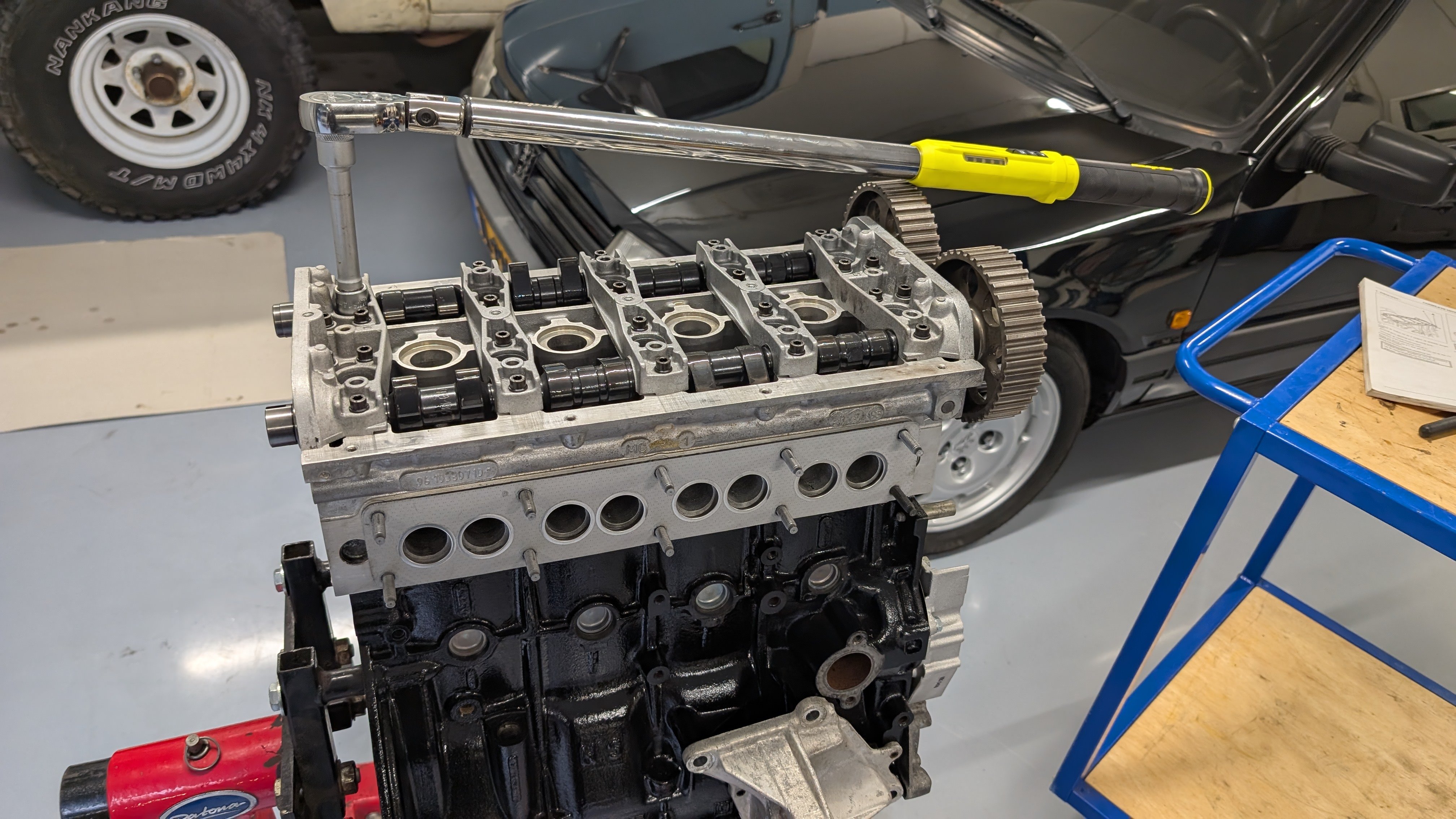

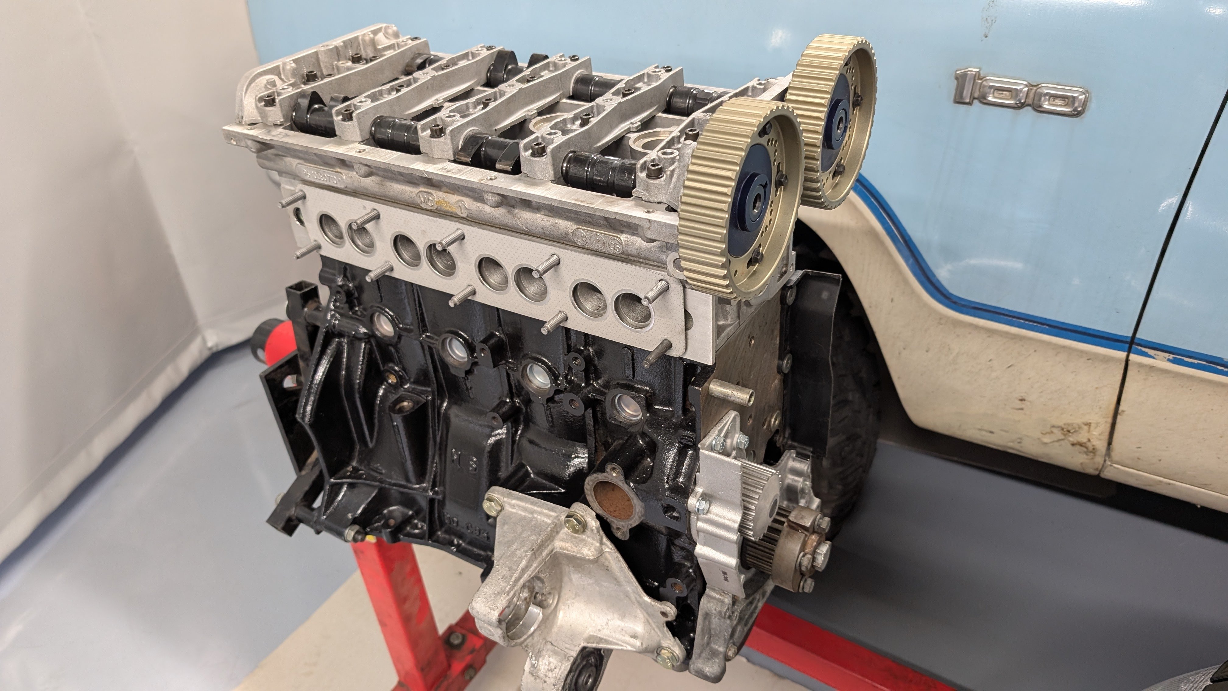

jonathan_steenbergen
Made some time and head is torqued down:D
