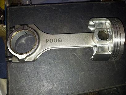

this pic highlights why custom rods should be used, see the gap at the side of the conrod!
B1ack_Mi16

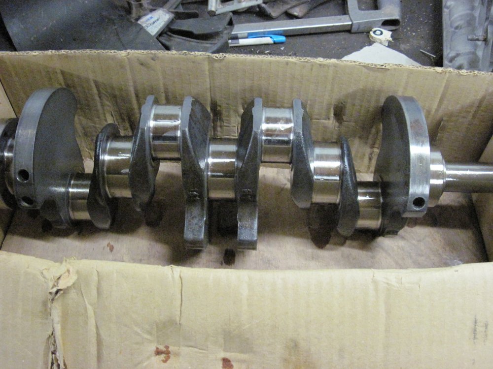

Yes. XU11D crank has 26mm wide rod journals, same as XU10J4TE engine has orginally. Most other XU engine has 24mm wide ones.
Custom conrods are preferred as now you need to piston locate the rods as on the 1.9 Mi16 engine.
The honda pistons (if same type as I got for my 2.2 T16 apart from the dish) won't be tight enough to allow for piston locating the rods anyways, they are also conical in the wrist pin area so would need machining flat in case of piston locating them.

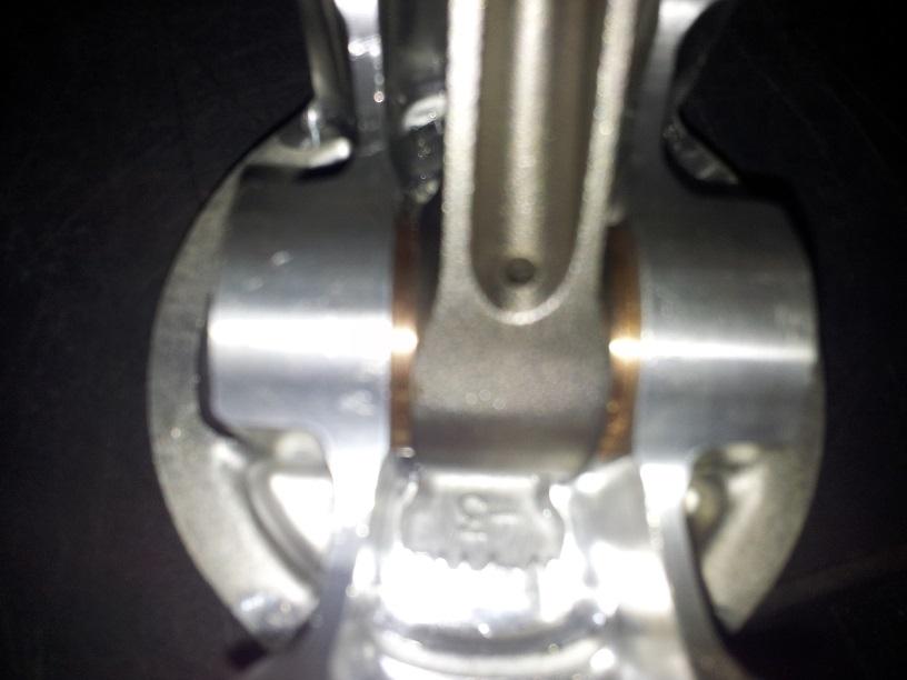

pip470
I also have made spacers either side of where the conrod sits in the piston and slides over the gudgen pin making it piston guided. Yet to test the engine but its quite similar to yours. I have forged pistons and rods and going for a compression ratio of 13to1. Good look with your project.
pip470
Heres the pics.

Con rod in big end 24 or 26 wide?
B1ack_Mi16
Probably 24mm, if not no reason to use the washers to centralize rods.

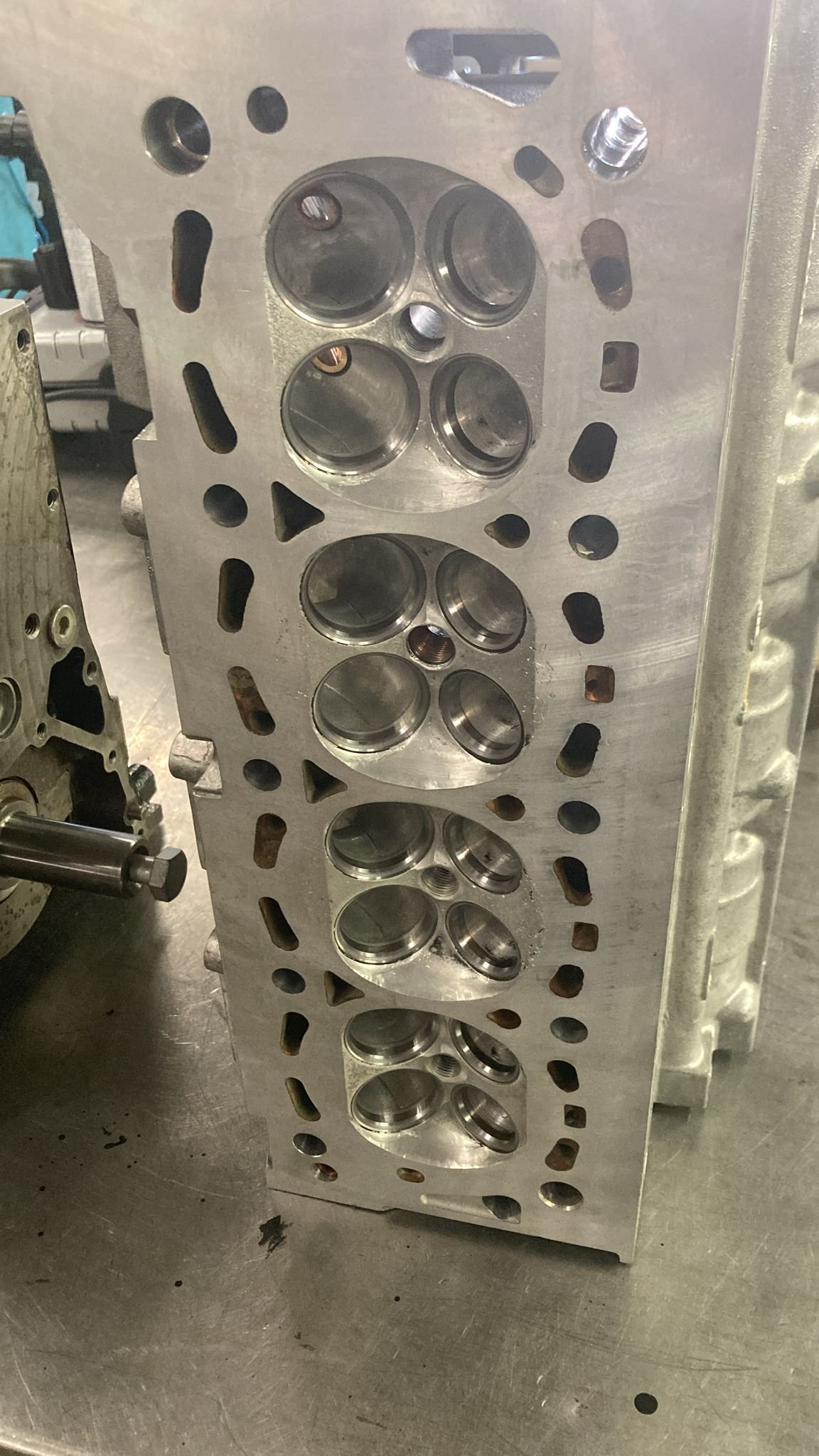

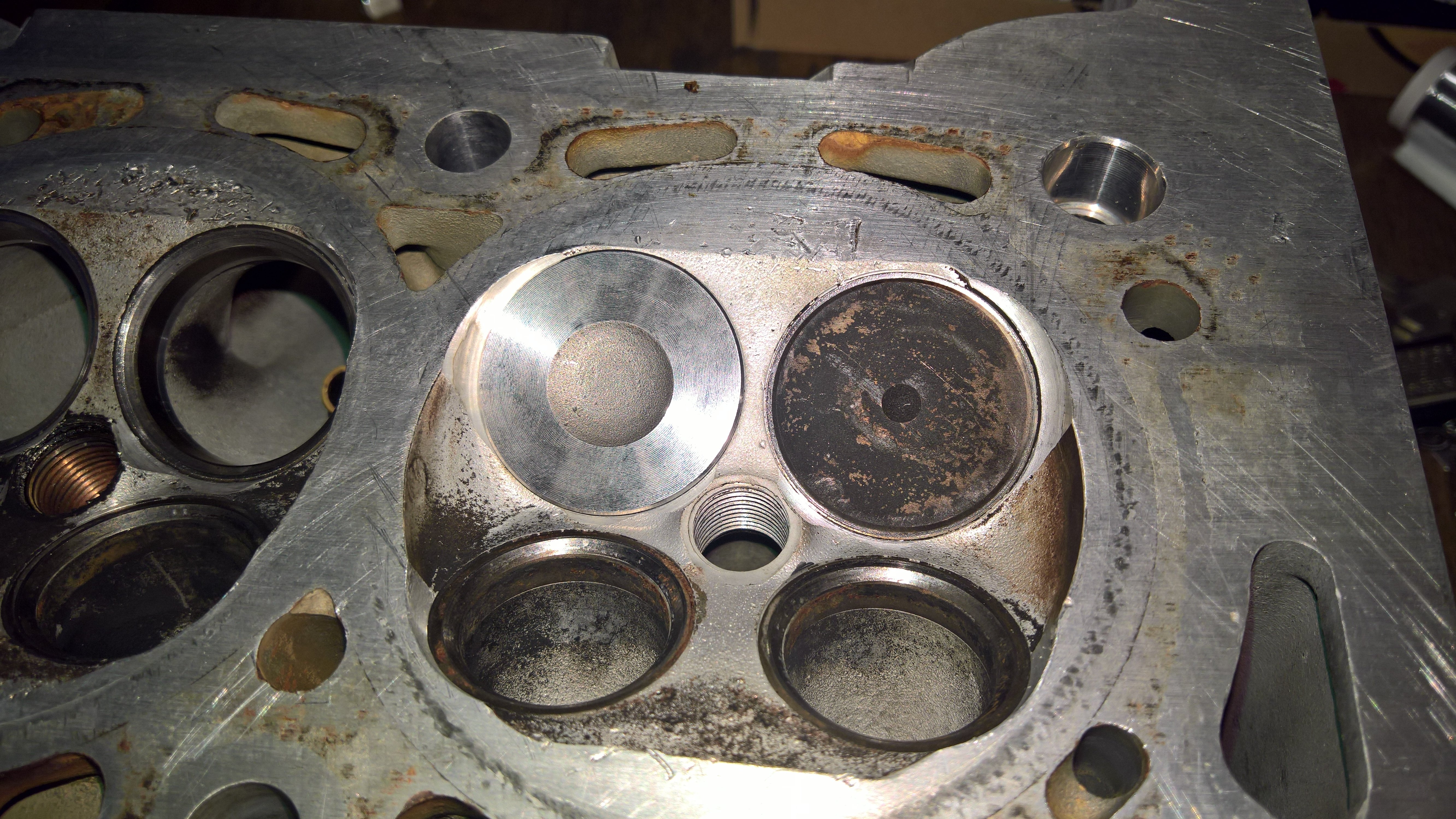

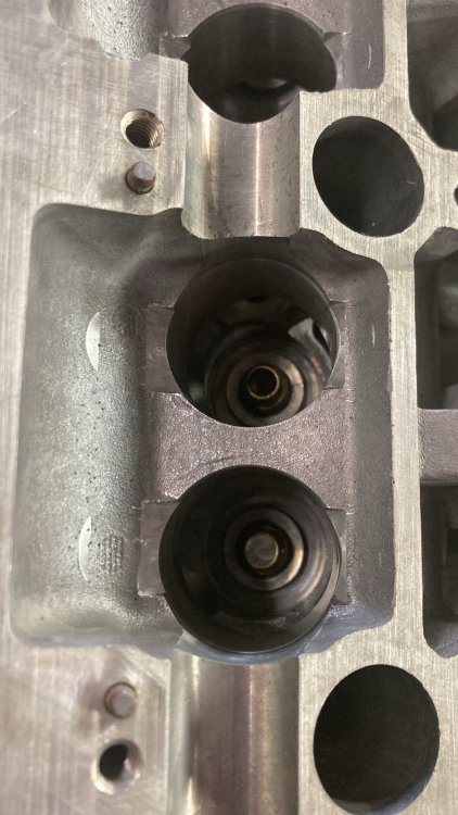

Now working on the cilinderhead,
He has already been machined near the valves so there is more space for the air to come in :D
Now I have to make a nice whole by hand and when this is done i know how many cc they have become and then I can order the pistons.

PEC made for Wossner turbo conversation piston Little to much space on piston pen with the 88mm H22 Wiseco pistons.. so gonne make the clearance right with bronz bushes.

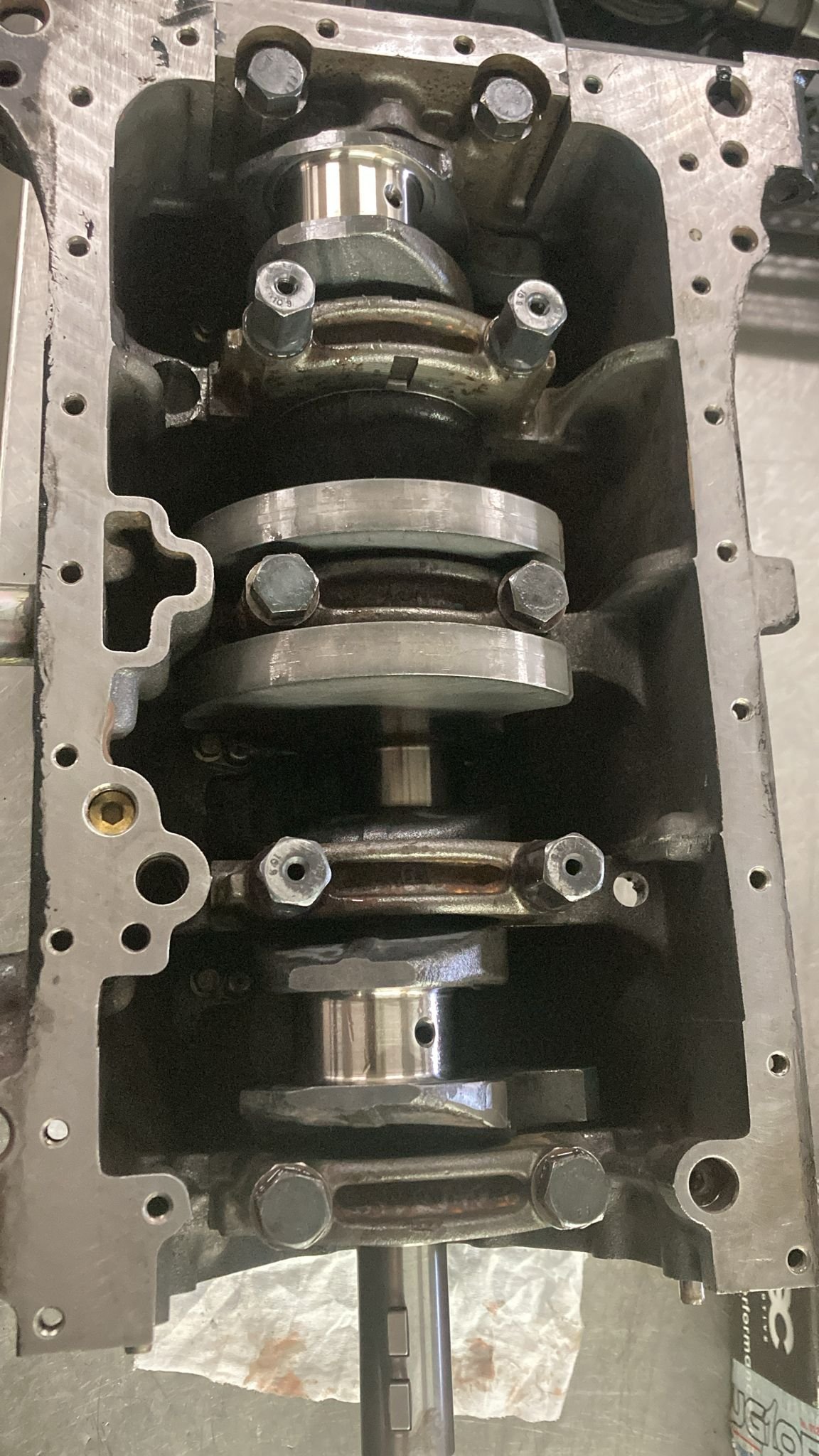

Also need to shim the rod in the piston because of the wide space there. Like as few mm's now. Dont want then to run in to the radius of the crank bearing space.

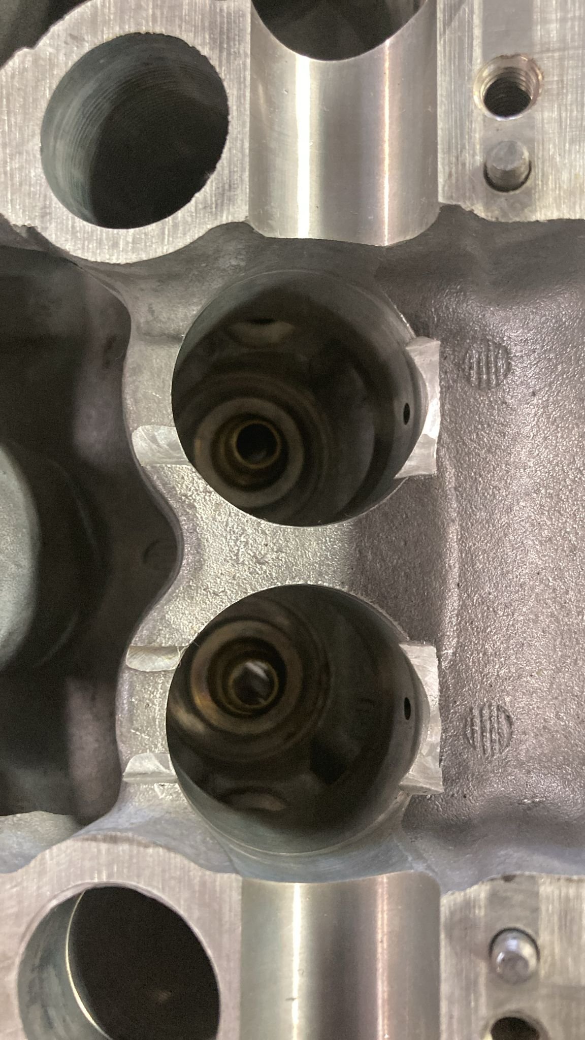

Head almost ready. Ordered lashcaps for setting clearance of the mechanic lifters. Mounted crank for shimming the pistons.
Pics :⁠-⁠)
I made eight, identical test lash caps from aluminium for shimming those lifters. You never get them right the first time.

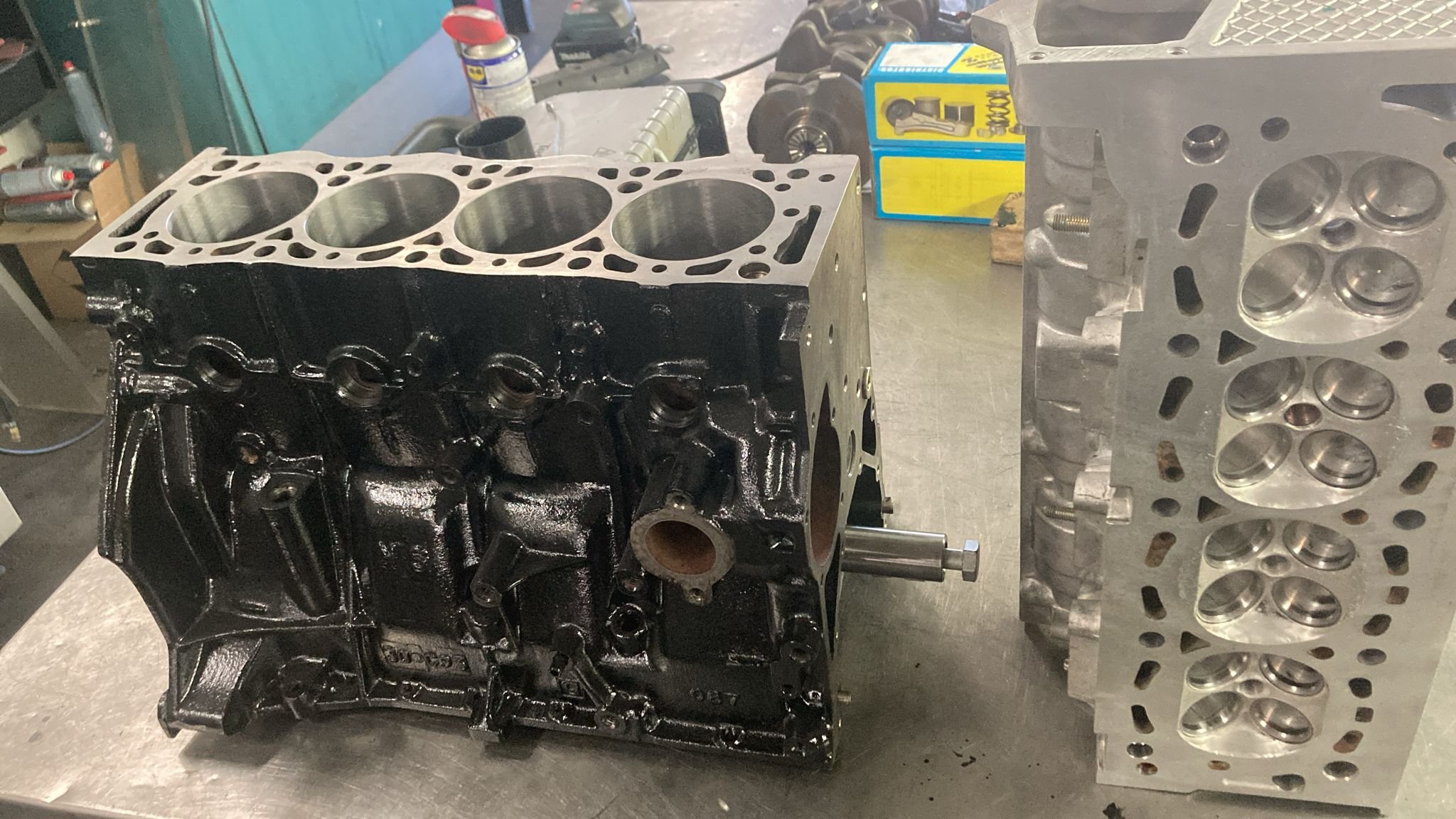

But bottom finished, head ready for now.
Hope to have the blue 309 out of the shet soon en let the engine bay blasting and painted.
Meanwhile finding time to make the engine complete.
Ecu will be KMS, also will be going there when finished for the making it run.
