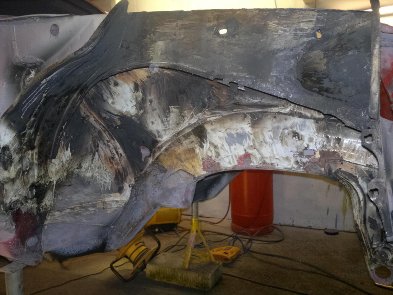

weldings done just a few minor bits to tidy up flapping welds etc. as for the arches they are all finished now all in primer.

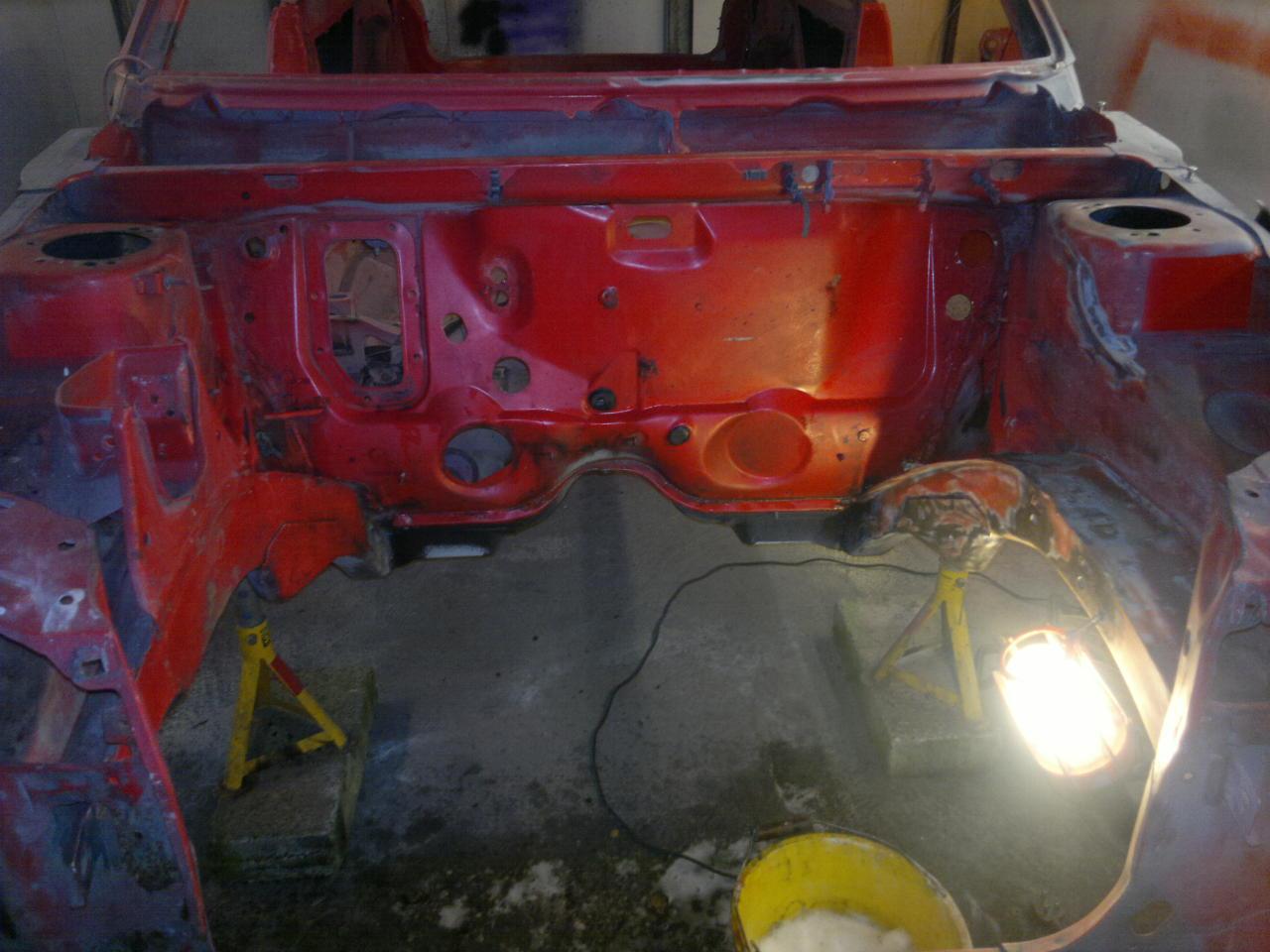

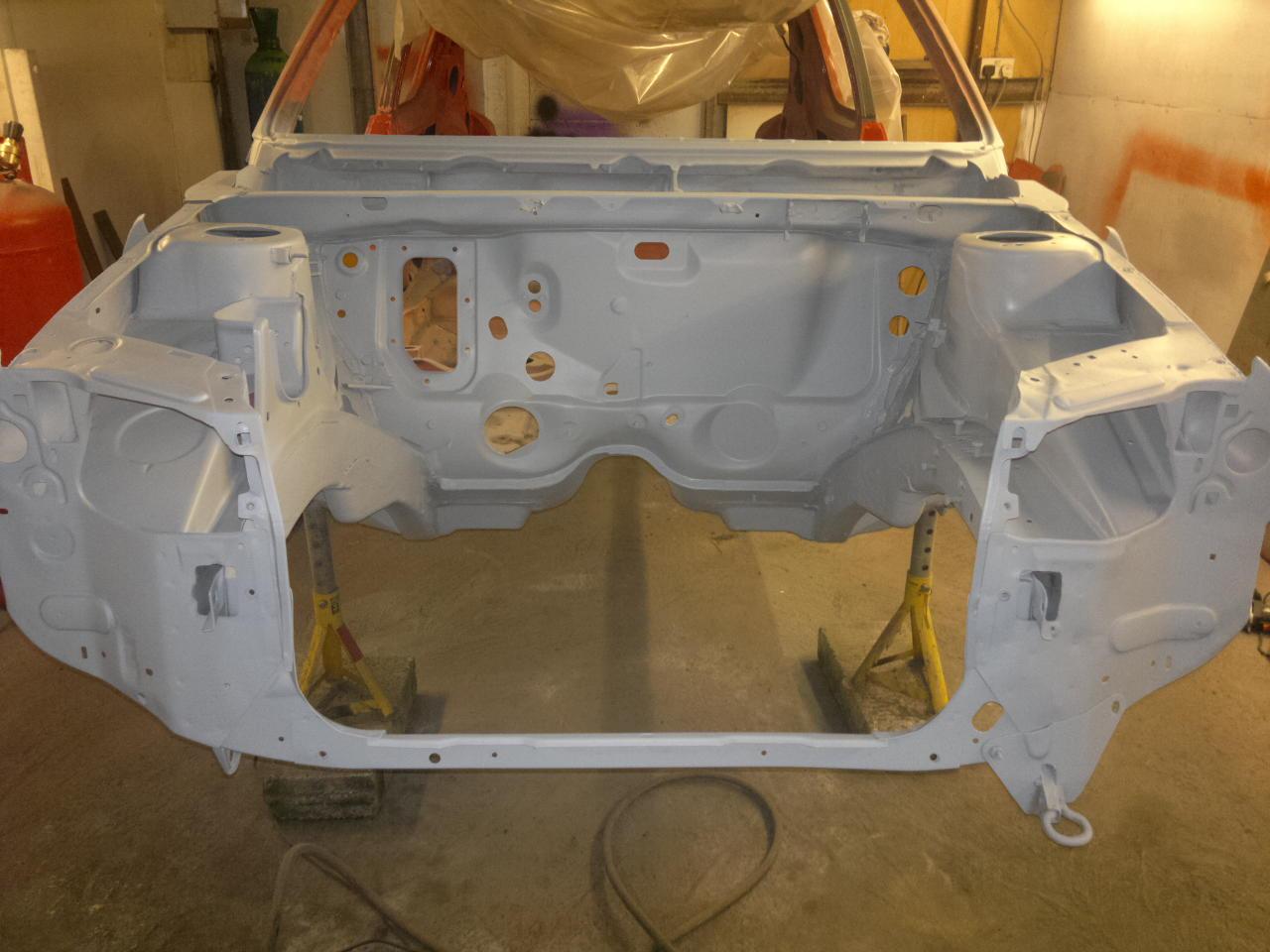

the engine bay has had a little work ,good old clean down and degrease. i then keyed it all and gave it a coat of barcoat to be 100% sure i get no paint reactions.
this stuff is magic for engine bays ! that was then followed up with a good coat of 2k primer
made a minor modification in the engine bay i have given the front chassis legs a coat of stonechip, as only the arch side of these are done factory standard, the underside and bay side chip and corrode as they have no protection.

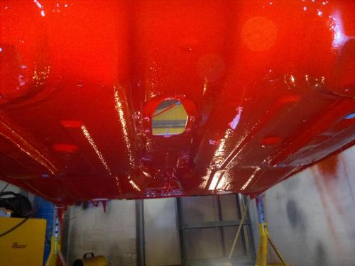

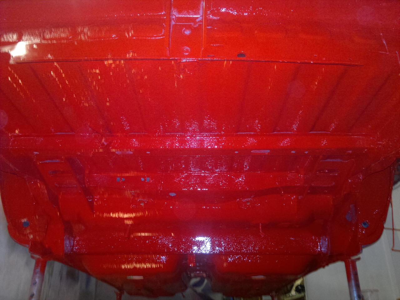

ok so i started up again with a few bits and bats the other day. I have glossed the entire underside of the car, this will give it more protection, ease of cleaning and better moisture run off. I have also painted the inside to a finish too. Many people wouldnt bother to do either of these two things as 1: you dont see the underside of a car and 2: the only bare metal part you see inside is the boot pan. But if a job is worth doing its worth doing properly !
