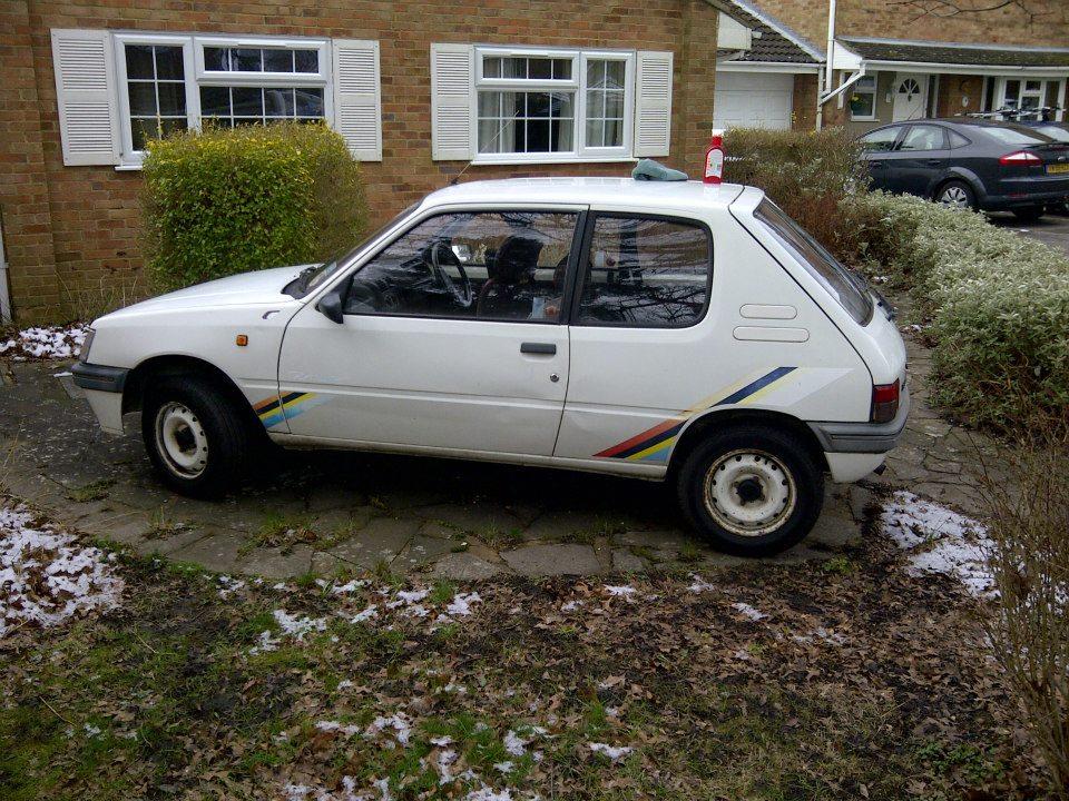

A friend has recently gotten himself a modern car and decided to pass on his 205 Rallye to a good home, namely my driveway.
Its got an MOT and tax and mechanicaly seems in good condition, bar a slight starting electrical problem.
Now, what should I do with it, tidy up the bodywork, replace the stickers and paint the wheels, or make it into a French Rallye replica? In terms of resale value, does keeping it orginal make it worth more?
bodies on a TU2J2, wheelarch trims, decent suspension, retrimmed gti seats in black cloth, xs or gti instrument cluster.
job done :D

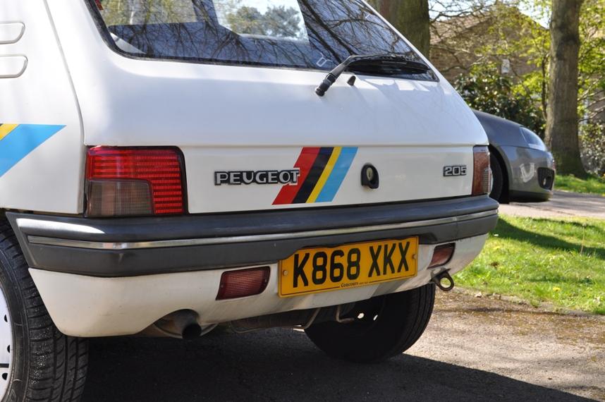

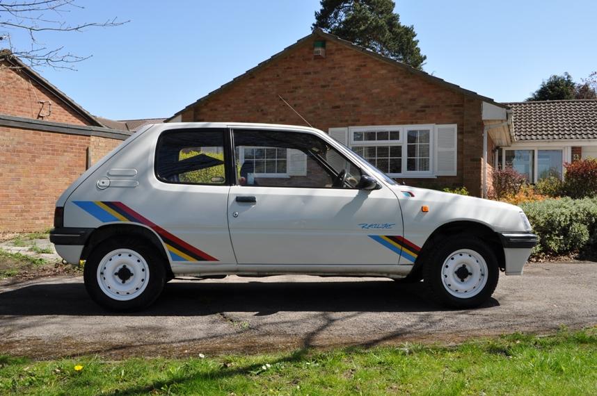

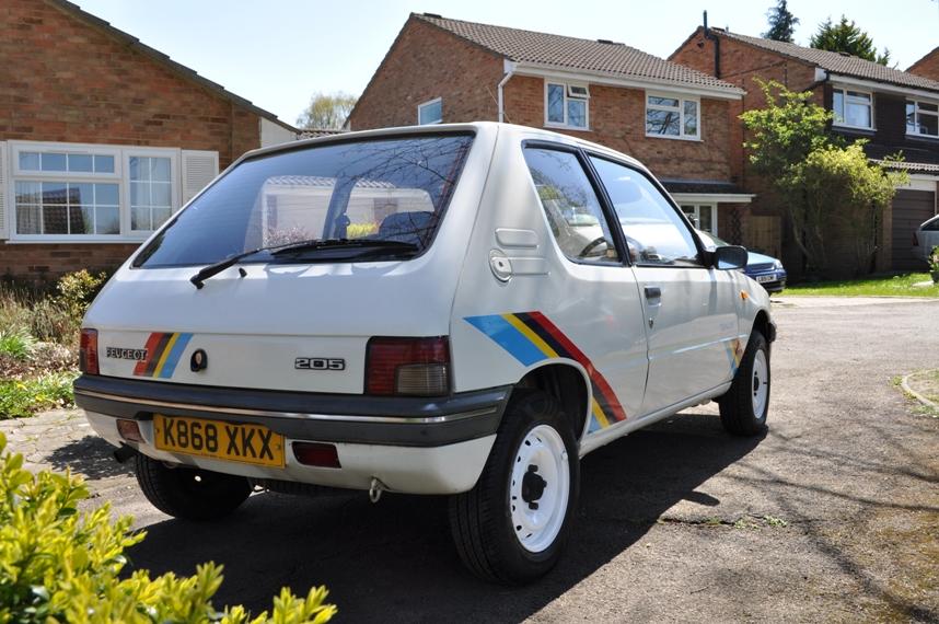

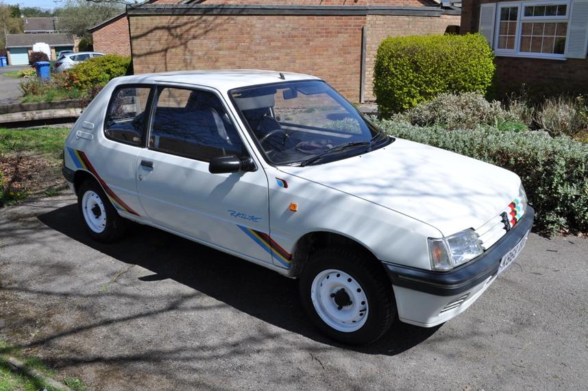

I finally finished off the stickers over the weekend, looks loads better than the picture at the top of this thread
fliprio
The rear quarter and bottom of the doors have been repainted, with a colour matched rattle can and lots of sanding with 1500 wet and dry, followed by cut/polish
fliprio
Just the seats need finishing off now and curing a starting problem :-(

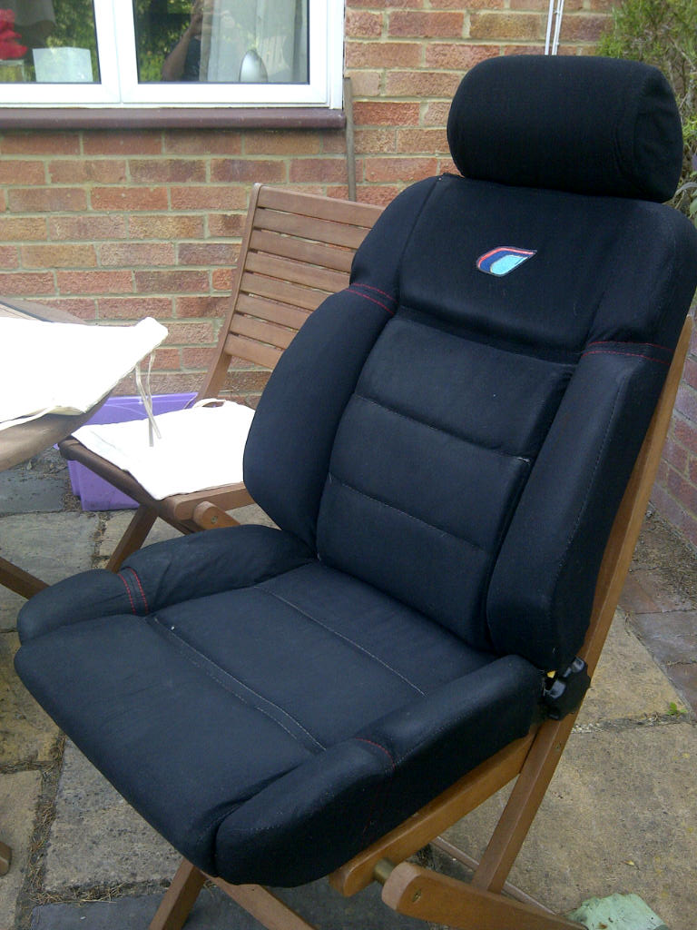

I've been making a bit more progress on the inside.

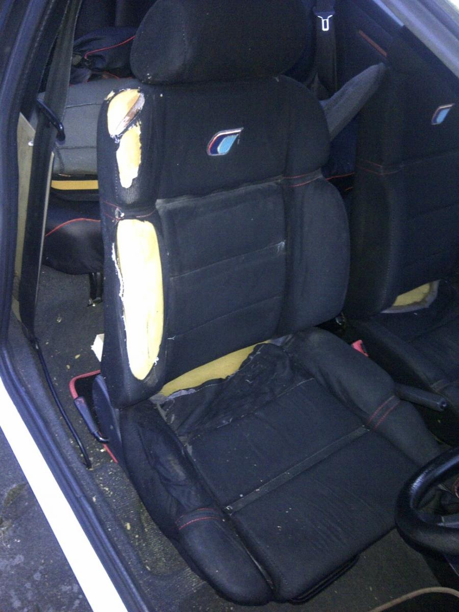

With the help from Dave at https://205gticovers.com/index.html I have repaired the drivers seat
It did look like this;
a fair bit of time with the sewing machine and welding up of the broken frame and it looks like this
Pleased with the result, now on to the passenger seat
