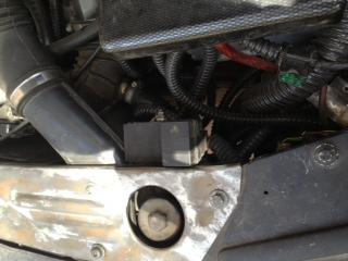

Heating Problem After Replacing Coolant

Switch on radiator wires connected - even changed the polarity.
Took them out to see if there are any cuts.
Bridged them - heard relay clicks - but no fan.
Fan gets into action when pressing the AC button so it's not fried.

UPDATE :
Checked the fuses in this compartment (by mistake :) and there was it . 30 AMP fuse blown.
