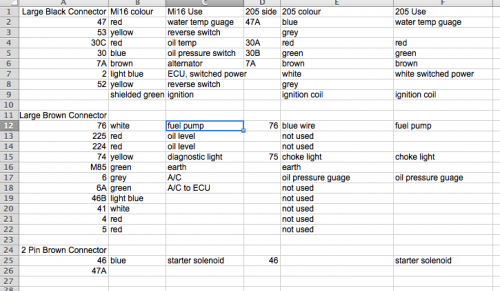

Can somebody please tell me on a Phase 1 205 how many and which wires am I looking to splice from the 405 loom?
Obviously there are the two mentioned in the thread above for the Fuel Pump and the Tacho, as I understand it the Fuel pump wire is going to come from the box on the passenger side inner wing, and the Tacho is coming from the 205 Coil pack? Is this all that is required??

Earlier cars only have a single brown plug under the dash, and a separate gauges + ignition loom coming through the bulkhead under the expansion tank on a RHD car.
Depends how early yours it, it might have all the relevant wiring on the n/s chassis leg inc the Tachymetric relay, in which case disregard the mention of two brown plugs, though the wire numbers and functions still remain applicable.
You are correct in that there are very few required just to make it run, then there's the ancillaries and gauges of course.

Use all the phase 1 engine bay wiring and then just connect the fuel pump, Switched live and rev counter up
For this I like to get the matching black and brown plugs from the Mi16 chassis loom, with 150mm or so of wire attached. I then splice into the 205 loom near the coil, giving a complete plug & play professional installation. The starter solenoid plug/socket is the same as 205.

I'd remove all the Mi16 loom sensor's and as said use the car's sensor loom which saves joining any wires, then it's a simple multi plug to join the Rev Counter, Fuel Pump, Switched Live over just under the header tank, Plus the Mi loom does not have a oil pressure fitted to it.

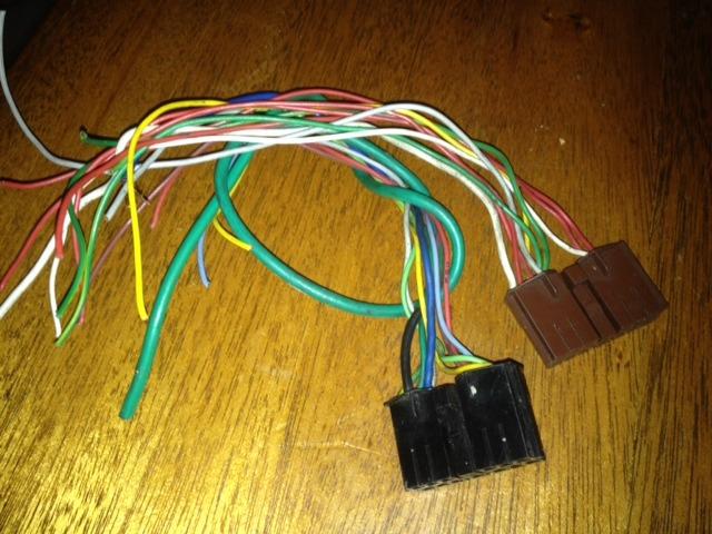

Unfortunately I am still not getting a spark or fuel! And I think the issue lies with the 405 loom. We have gone round the engine and plugged up all the available plugs til there is no more connections left around the engine, but we still have a number of loose plugs, which I had assumed were not used on the 205 (The likes of air con and power steering?)
However after a bit of testing on the 405 loom we found that between the switch live that we spliced and the relay that it goes to there is a Brown multi plug, that is not connected and after hours of looking we have no idea where it should go, here is a picture of the plug;
http://i18.photobucket.com/albums/b116/adirtjumper/0E844A43-AB98-4D9A-ADE5-24A256E69A05-9991-0000041C3FED3163_zps9c812b1f.jpg [/img]
http://i18.photobucket.com/albums/b116/adirtjumper/3F2AB3B5-FF18-439B-80E1-650E5E042B9F-9991-0000041C3D5FC738_zps39b8abfa.jpg[/img]
Can anybody tell me where this belongs?

Coil?
DGTi
I am using the old 8v coil, will the Mi16 loom plug up to this the same, or should I have an Mi16 one?

why are you doing that?
I would use the mi16 item

Miles
That's the issue, The Mi coil needs to run off the 405 loom as if I remember a switch live runs thru there too along to the ign amp, Without seeing the wiring having 2 systems side by side will not work, there is no Power steering plug either, the ECU is too clockwork for that
