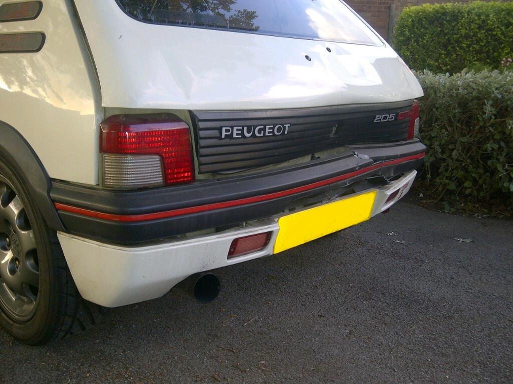

A rear end shunt back in August made me have to think about keeping or writing off the car and taking the cash or getting it repaired. Final decision was to repair it and at the same time grab a copy of the blue book and look at the specs for sprints/hill climbs.

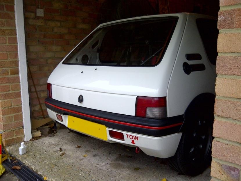

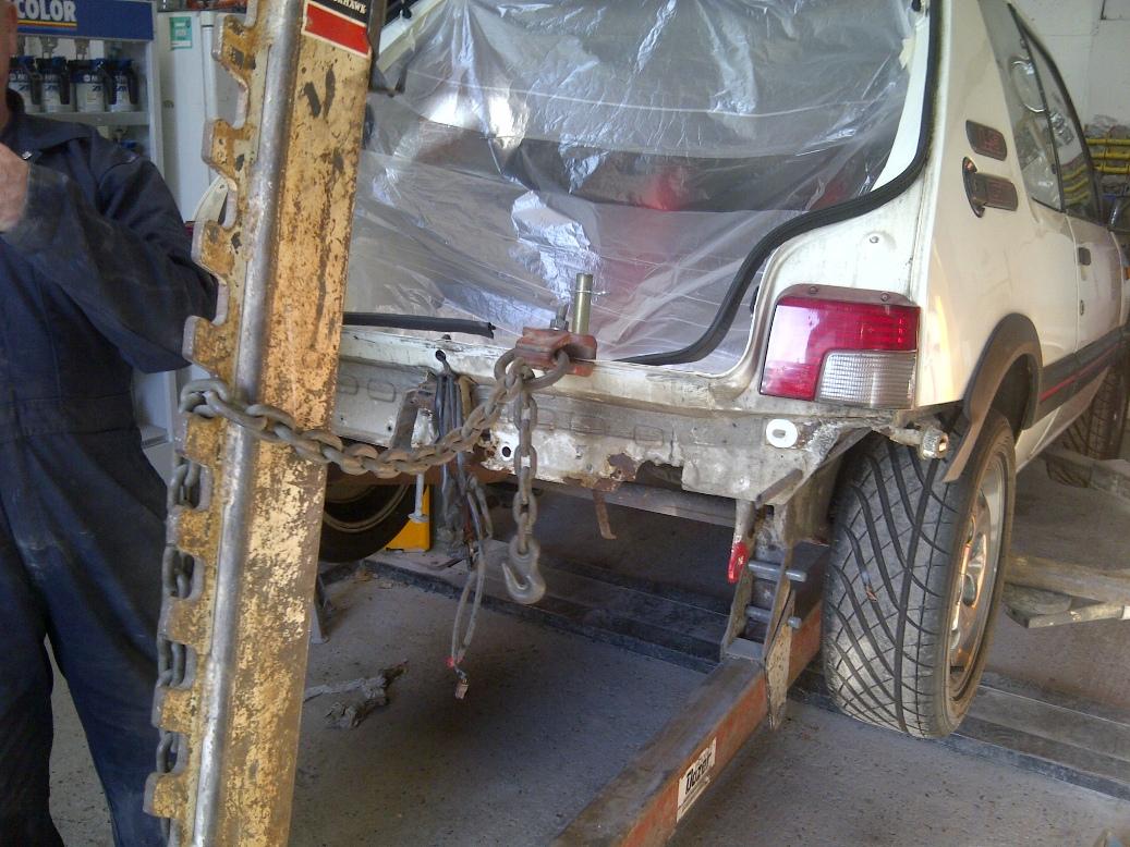

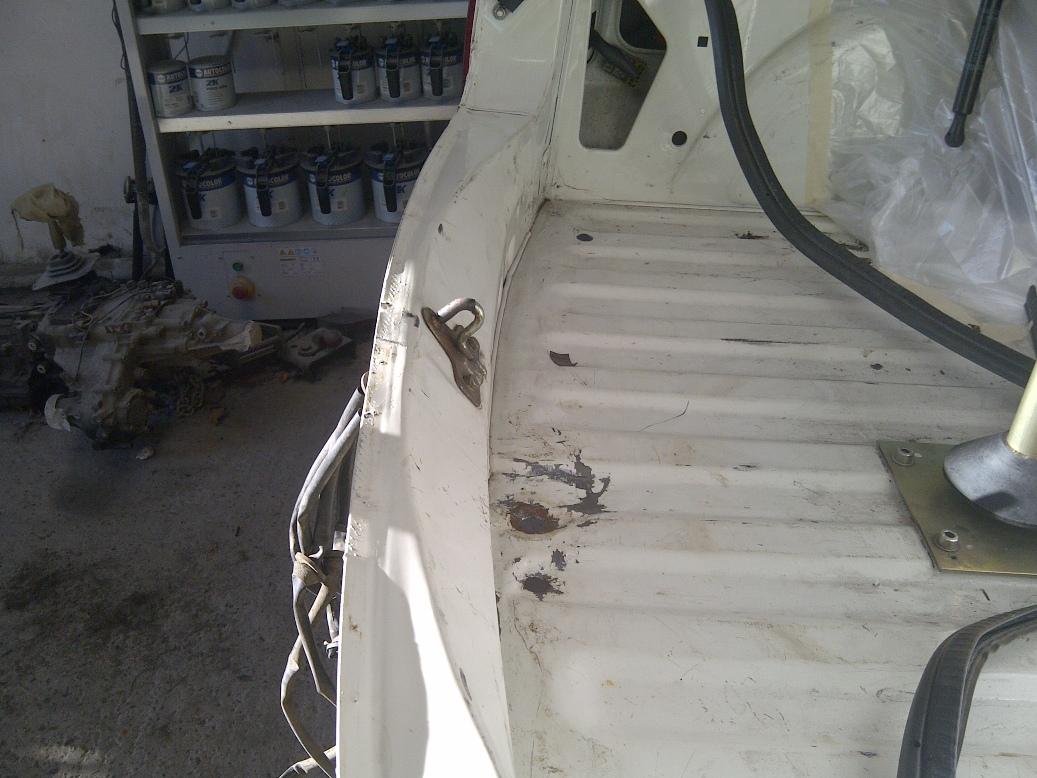

First is to repair the back end. Most of the floor and rear panel pulled back out quite nicely, quite a few local places wanted to charge a small fortune to cut the whole rear end out, but it’s fairly straight now. A few brackets and bumper mounts needed re-welding.
New bumper and mounts were put on, I decided to go with a smooth tailgate, and it had to be re-sprayed as finding one in the same white was a pain

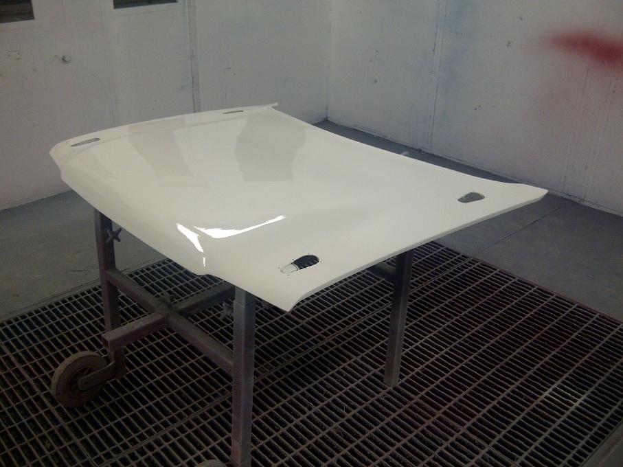

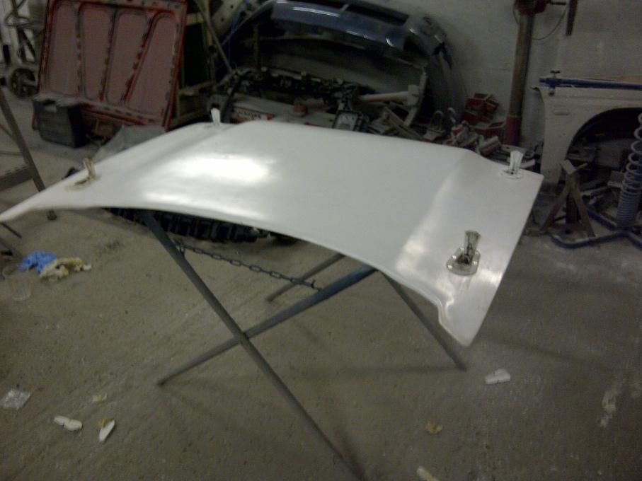

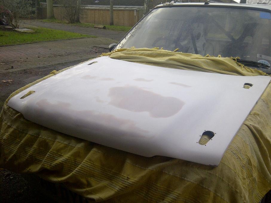

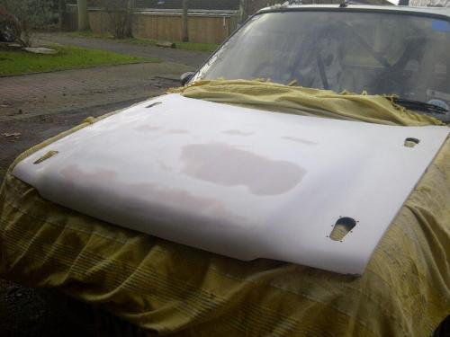

The original bonnet was never very good and had to be raised as the manifold sits the twin 45s at a strange angle. Despite the recommendations not to, I got myself a Magnum motorsport humped bonnet. As per everyone’s advice the quality of the bonnet was c**p, it had what the guy at the bodyshop described as ‘fried eggs’ all over it and was very thin. With the 4 Aerocatches, the actual fit on the car was quite good
The bonnet needed some major filler work, but to stop it cracking, some aluminium rod was fibre glassed in on the underside to strengthen it up

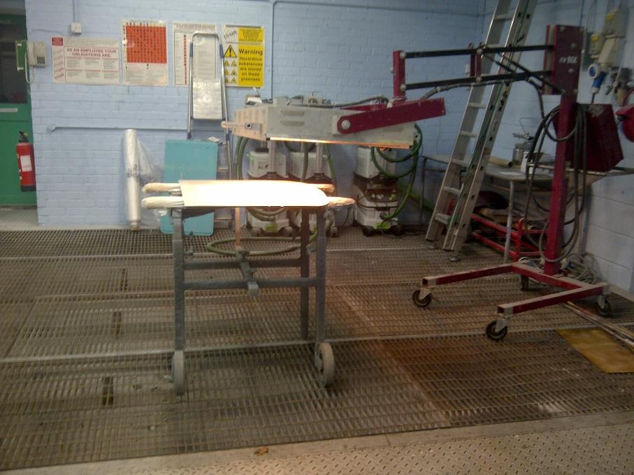

Finally, I had a go at spraying it myself, first time doing it and in 2K it looks quite good, only a small amount of orange peel in the centre which will come off with a bit of compound.
I also did the sunroof cover panel while I was there as it was just a bare bit of aluminium before, just using an IR dryer to make it go off nicely

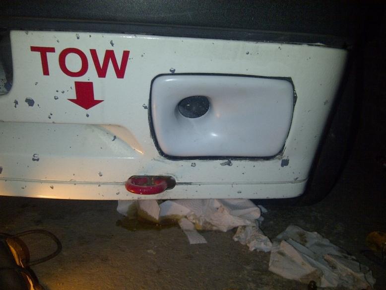

I got myself some bumper vents from Xcross racing in Basingstoke, they fitted into the bumper nicely, but the hole is on the wrong side, the bumper has some metal plates behind it in this area so you can’t get any pipe work onto it. They were kind enough to give a full refund.

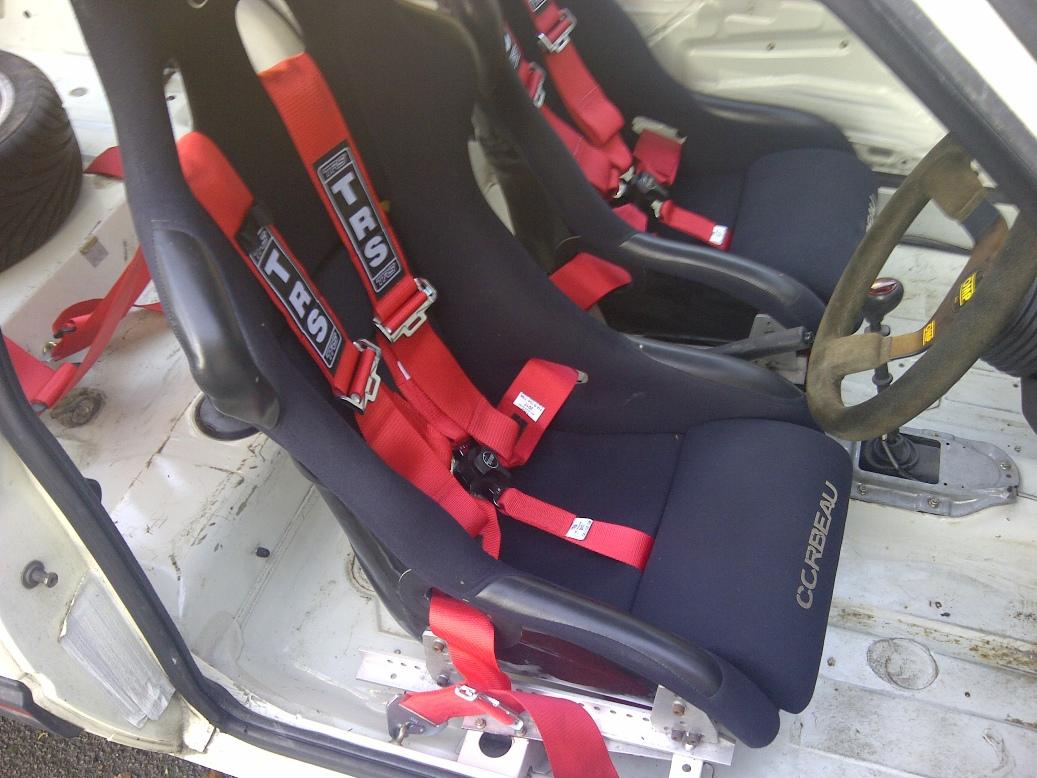

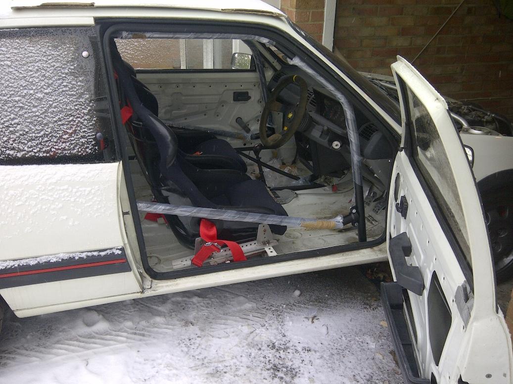

Harnesses in, got a great deal from Rally designs, £85 each with free postage
I need to find out how a remove the crotch strap for using it on the road
fliprio

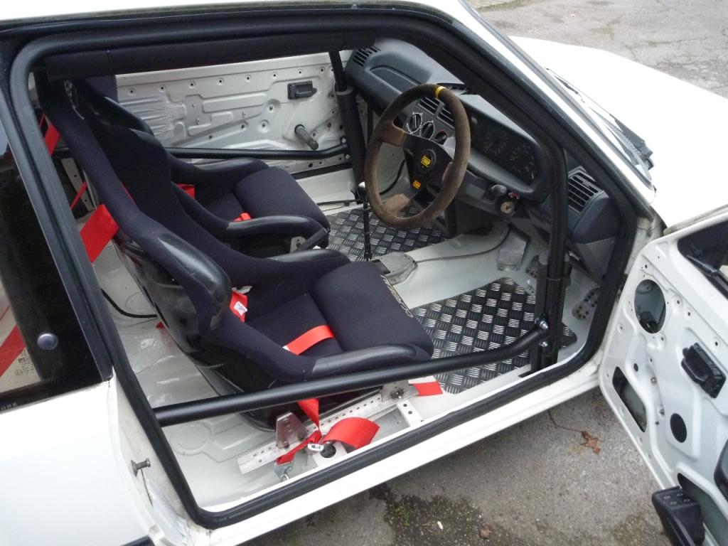

Trial fit of the roll cage, Andy Baker at AB motorsport sold me the front section only which was useful, it was the last one left from any of the SD distributors and would have been a 2-3 month wait otherwise!

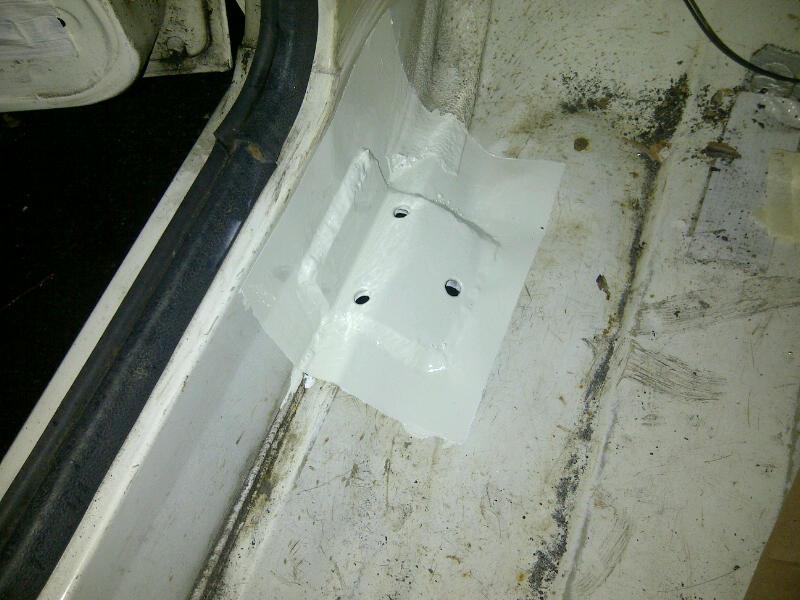

Roll Cage mounts welded in, I think I will need to paint the rest of the floor, the 2K brushes on quite nicely

Looks good ! I'm considering going with a smooth tailgate on mine. Is that an auto bonnet you've got there ?
fliprio
cheers, i wasnt sure about the tailgate at first, but I kind of quite like it now.
No its not an auto bonnet, its a Magnum motorsport fibreglass bonnet supplied by http://ramsport.com/ the hump is at the front as apposed to an auto bonnet where its towards the back

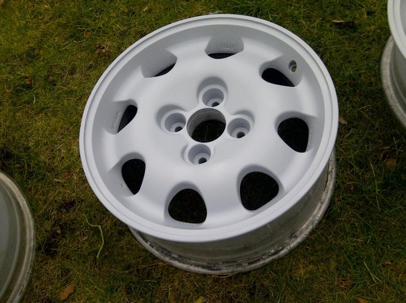

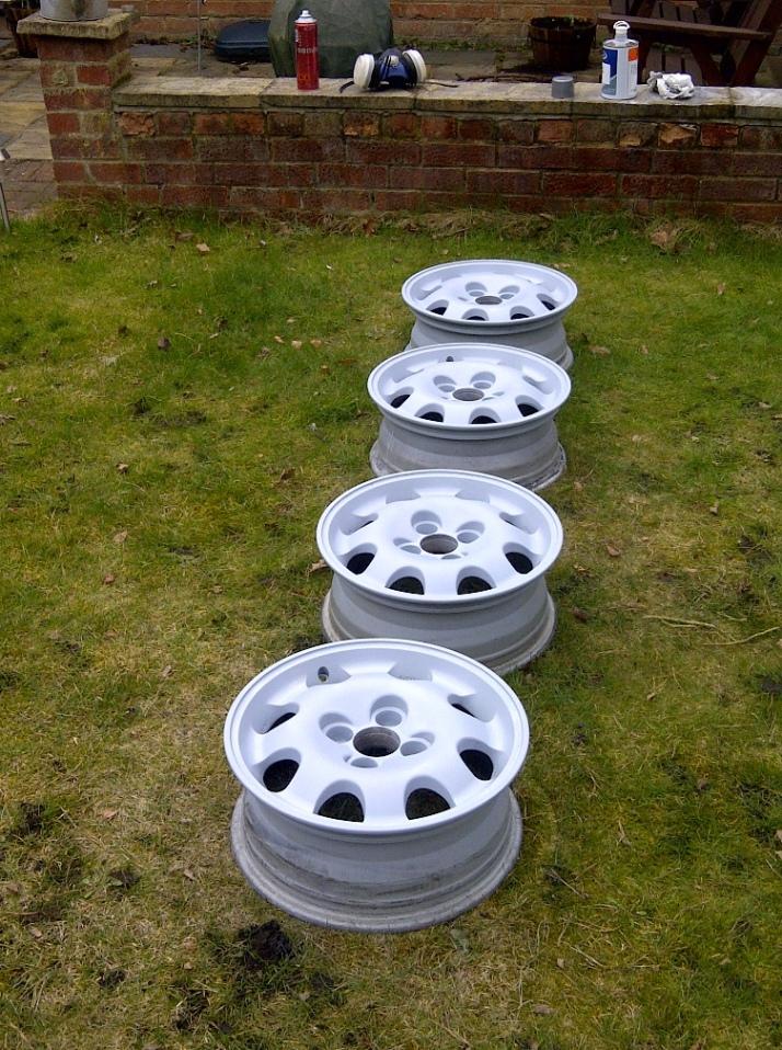

Refurbing some 1.9 alloys over the weekend to go with the A048s, most of the curbing marks have been filled or sanded out.

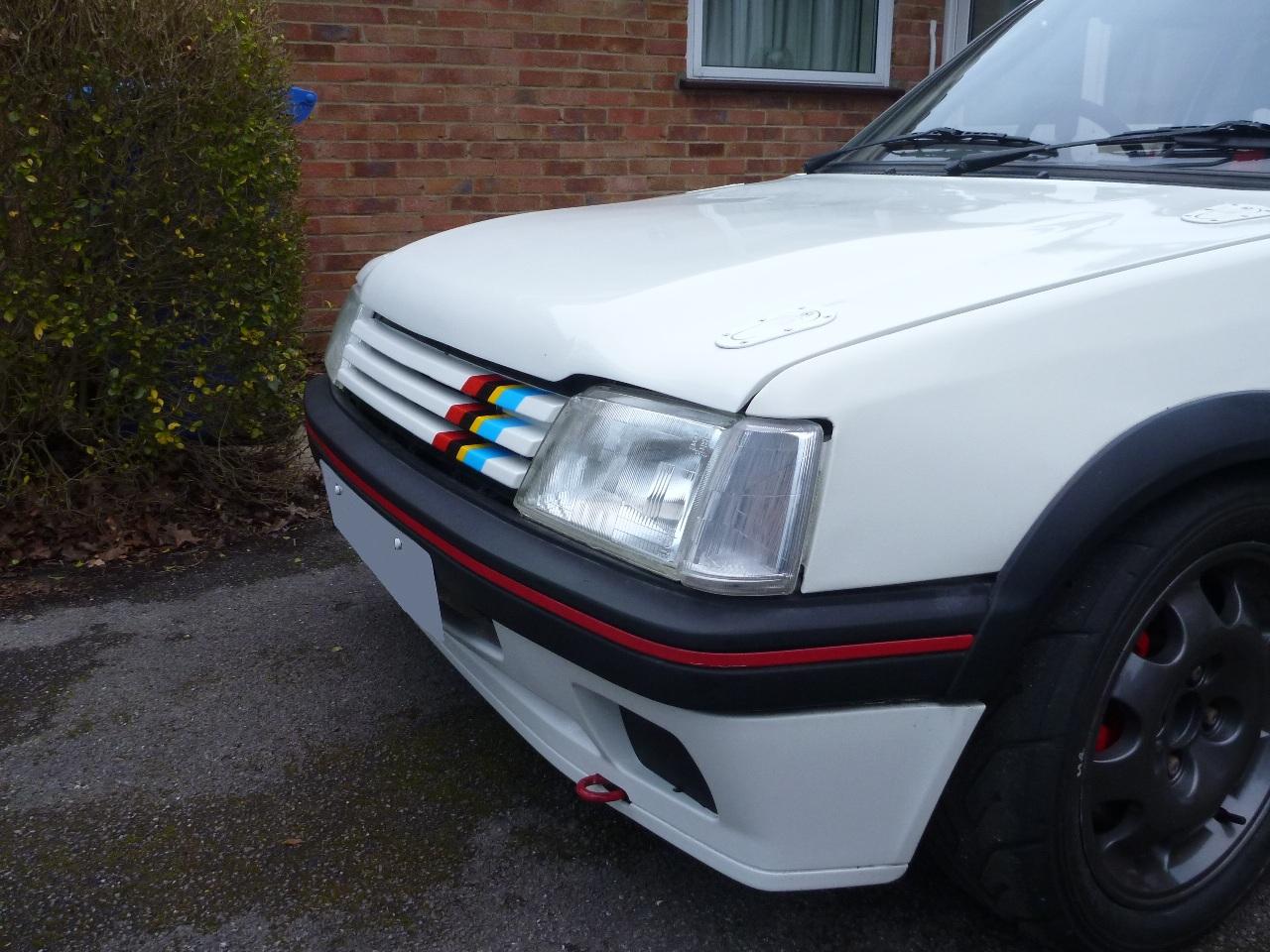

Front end finished off
fliprio

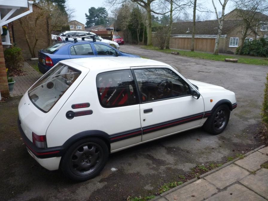

new badges and wheels finished off
