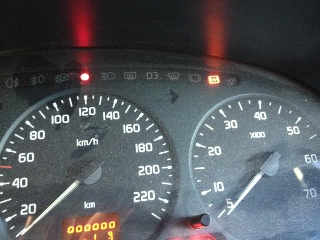

Hi there , A friend came to me today with this Megane Coupe 1998.
He disconnected the battery for few minutes and after connecting it back , the car didn't turn on anymore. there is this round red light that keeps flashing (normally it flashed few times and then turned off)
We tried a lot of things, disconnecting the battery again , waiting hours and hours. still nothing.
there is a spark and the starter turns but car doesn't. \
What went wrong?

My girlfriends old Clio had the same issue. I looked up the icon that is illuminated on the far right of your picture. It was something to do with the immobiliser. Hers turned over but didn't spark. I locked and unlocked the car again with the fob and it worked fine.
omri617
U mean the orange lighted one ?
The key fob in his car is not working , there was a mess with his car and he disconnected all things related to the alarm system
The one that bothers us , is the flashing red dot

The flashing red dot is the immobiliser light, it should flash when the immobiliser is armed and come on solid then go out when the ignition is turned on. If its flashing constantly while cranking or the when the ignition is on it indicates an immobiliser problem in which case your going to need the renault diagnostic software to find whats wrong.

With the immobiliser light if it flashes fast then it is a key fault,if it was on constantly then it is a fault with the immobiliser,is the key infra red?

when entering the code , the orange light shown above flashes few times and nothing ..

The immobiliser light is the red dot led in the centre the orange light you keep refering to is engine management light
