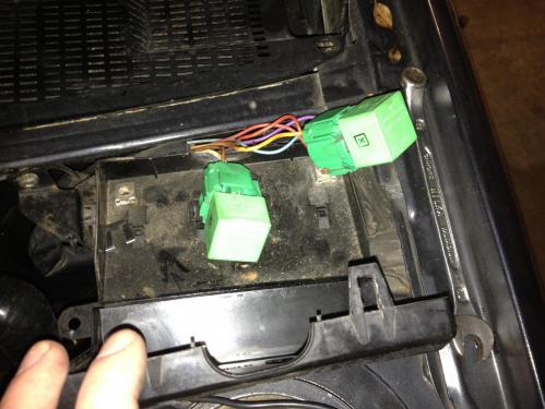

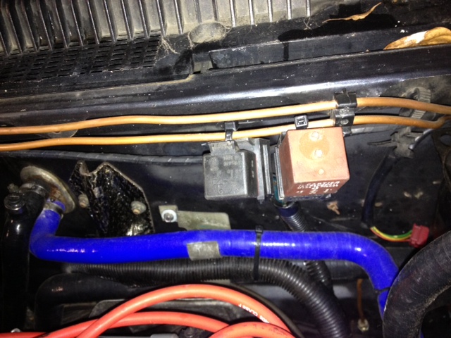

i have 2 relays in my bx16v loom that i have no idea what they are, any ideas? iv even taken them to a few shops and cant get a match for them anywhere
photo-3.jpg[/img]
and these 2 are on passenger side in a black box next to upper strut (205 loom)
photo-2.jpg[/img]
i wonder what the top 2 are mainly to try and figure out my no spark problem, i keep reading about relays but these are all i have and not green 4 pin 25 amp ones

as for the black and brown one... god knows but its part of the bx 16v loom ??

The ones in the black box are for the dim/dip headlamps, and the air compressor for the horn. Of the two on the BX loom one is for the fuel pump, the other provides power to the injectors.
I'm pretty sure all of them are just normal 4-pin relays, so you should be able to buy them anywhere.

ok thanks a lot ryan, its just so hard as i can not read the the writing on the relays them selves and cant seem to find anything about them in the haynes manual.
il repace them both if i can get a hold of them from somewhere
