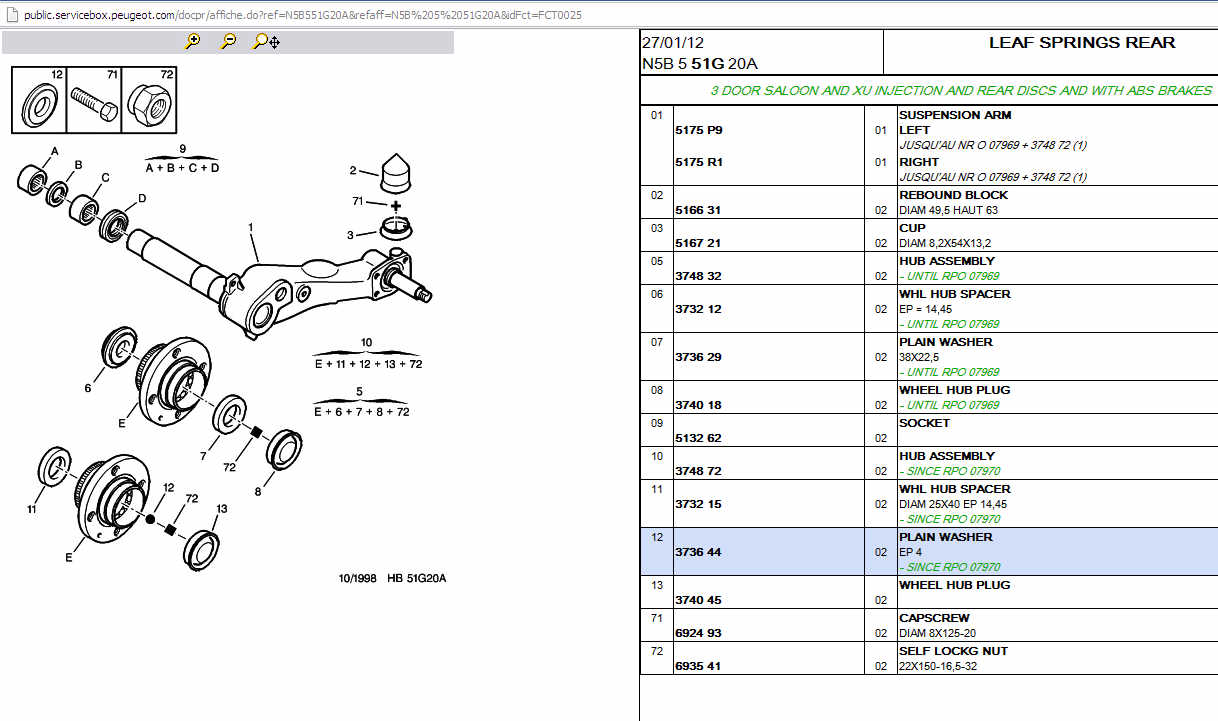

Where do you guys get the bearings and seals from? ive checked ebay and they quite expensive or is that just what they cost?.
eBay is generally parts from the dealer with the sellers mark up added.
Just buy them from the dealer, and note that the 306 "kit" is cheaper than buying the bearings individually for 205's. Part number all listed if you do a search.
NFS
Thanks and generally. how much for a set? or is it listed with the parts numbers? i will do a search now thanks
I've just checked & a set is £21.34, part number I have is 5132.62
