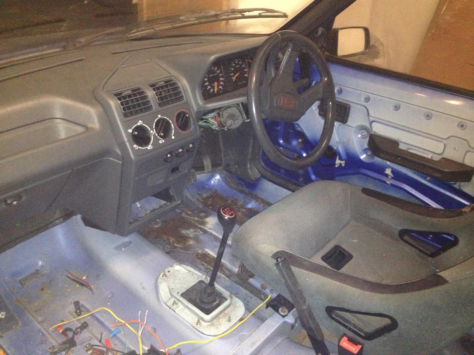

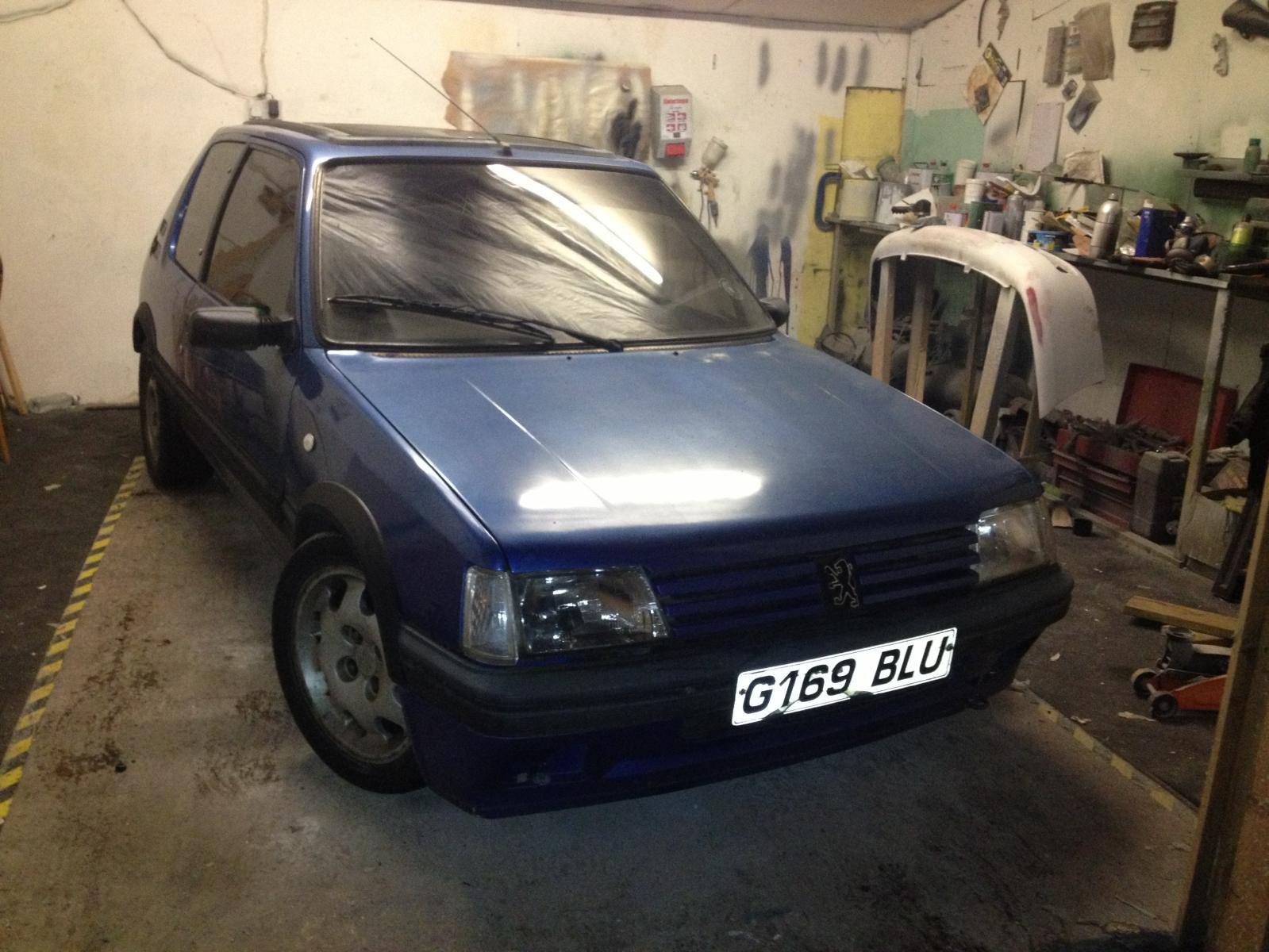

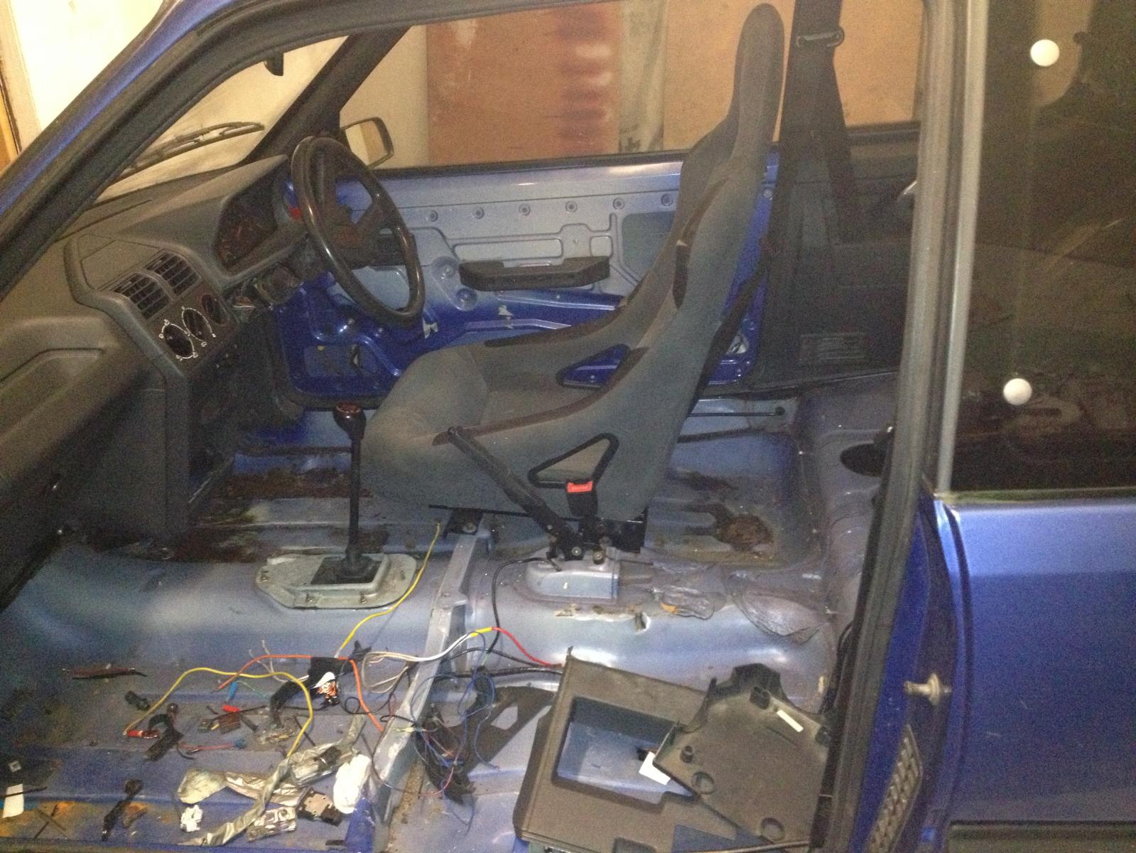

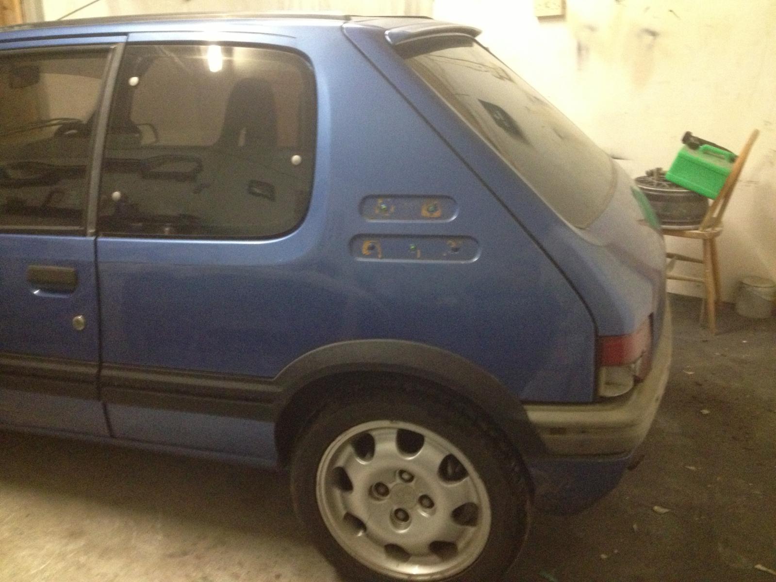

Hi, i have been popping up on the forum here and there, but i have finially managed to get my hands on a 205 GTI.
as it stands at the moment it its striped and track prepped, (not so good :( )
my plans are to restore the complete shell. either keep the engine or put a 1.9 back in.
current spec:
2.0 8v turbo engine
larger front brakes (not sure what they are yet)
completely stripped
future spec:
all exterior trim replace.
all interior to be put back in
extra sound deadining
intercooler (if i keep it)
Tesstuff
It looks Miami blue to me, I can see any stripes :wacko:

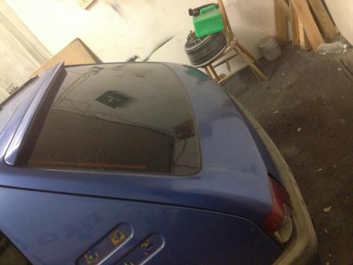

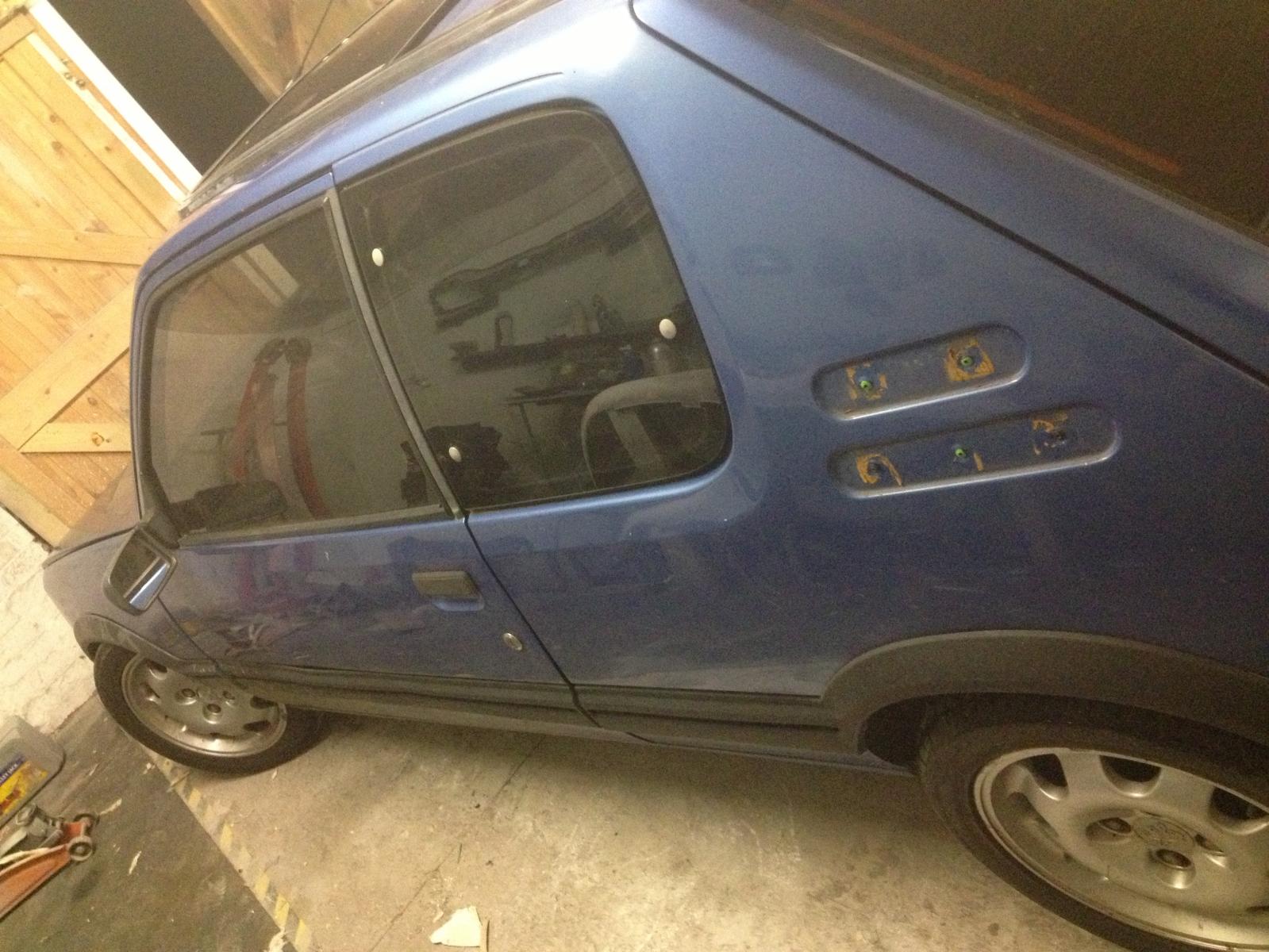

Will get some better pictures at the weekend, im trying to get some interior parts together, one fantastic member of here has offered me some seats already.

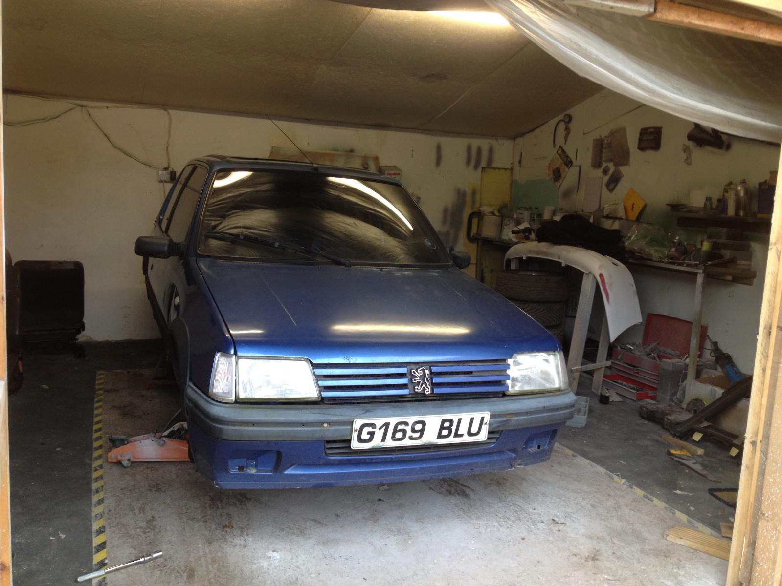

Right, i managed to pick up a set of front seats of a memeber on here (JRL) thanks, spent saturday day stripping the car to unearth any hidden damage and all in all pretty impressed, i will let the pictures do the talking.

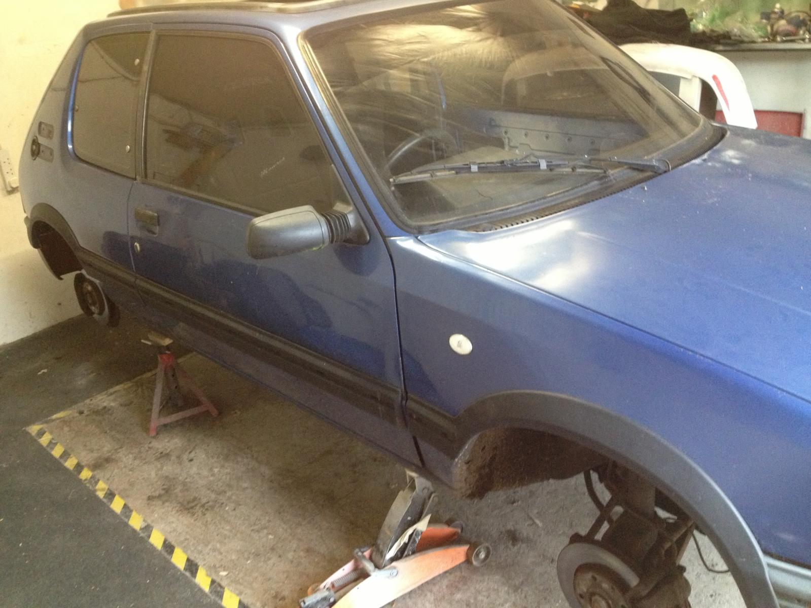

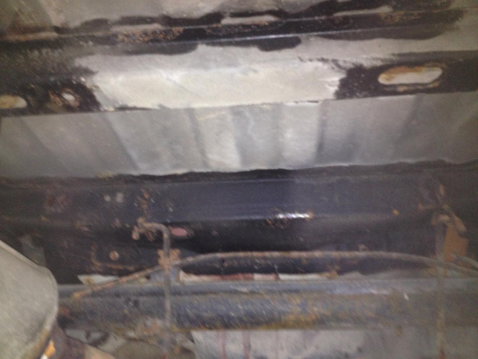

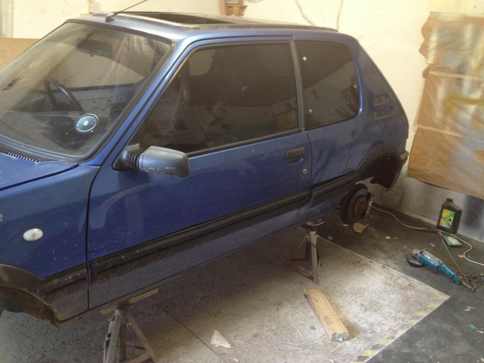

First job was to get it up on axle stands so the underneath could be treated, a good friend of mine is trying to convice me to take everything off and tipp the car on its side onto an old mattress so the treating can be done easly, but im not conviced that it wont damage or buckle the shell

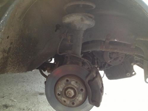

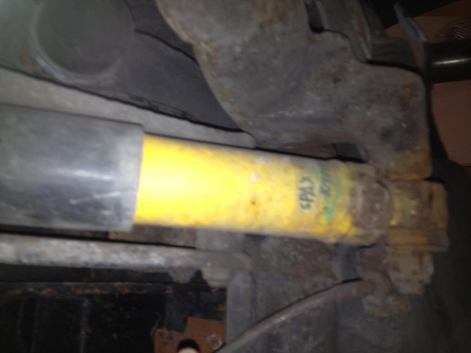

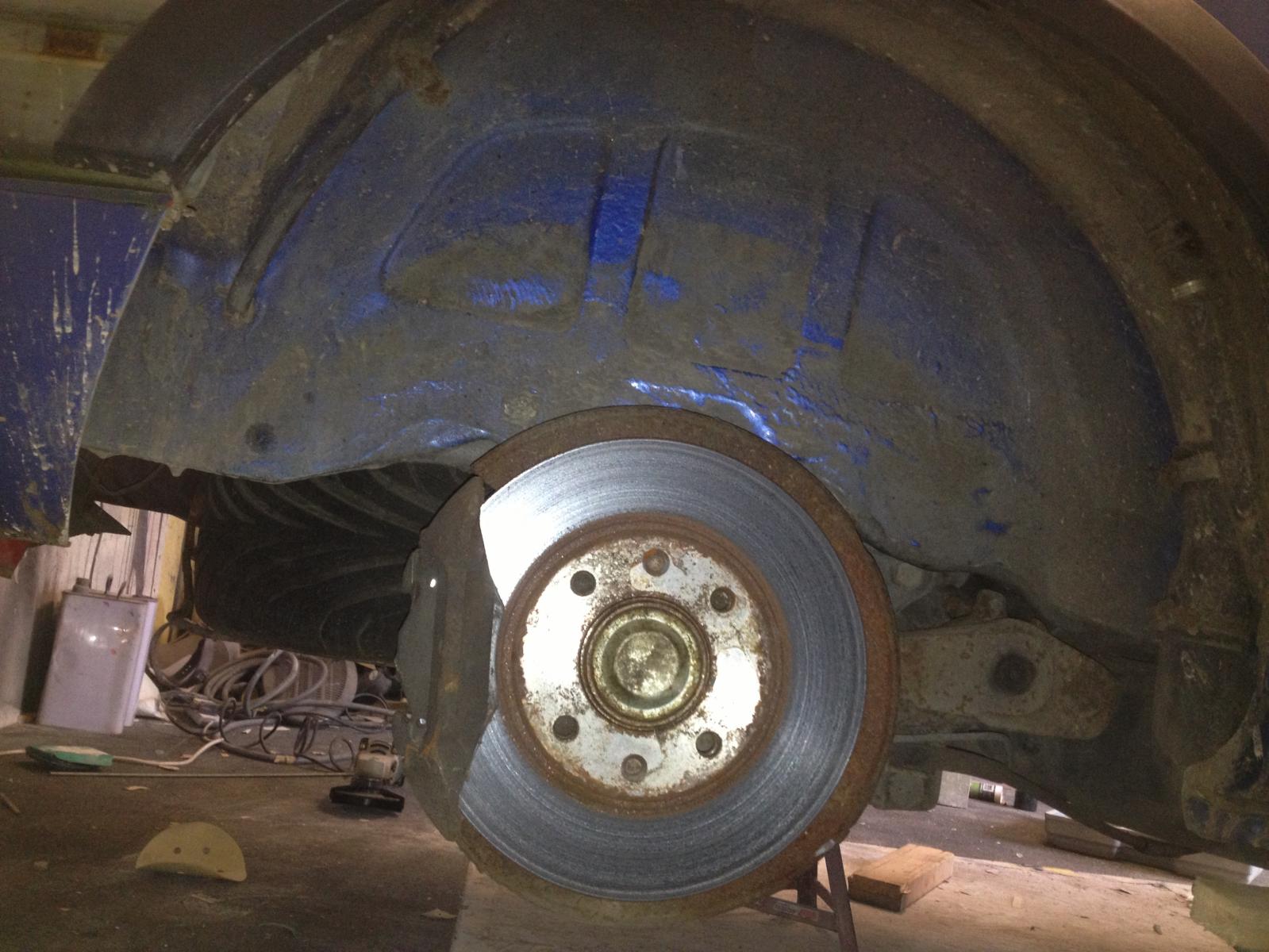

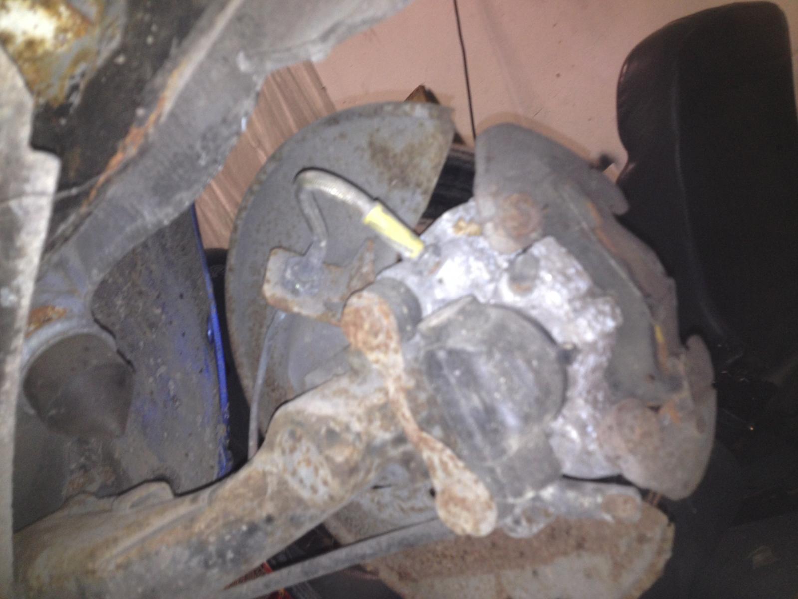

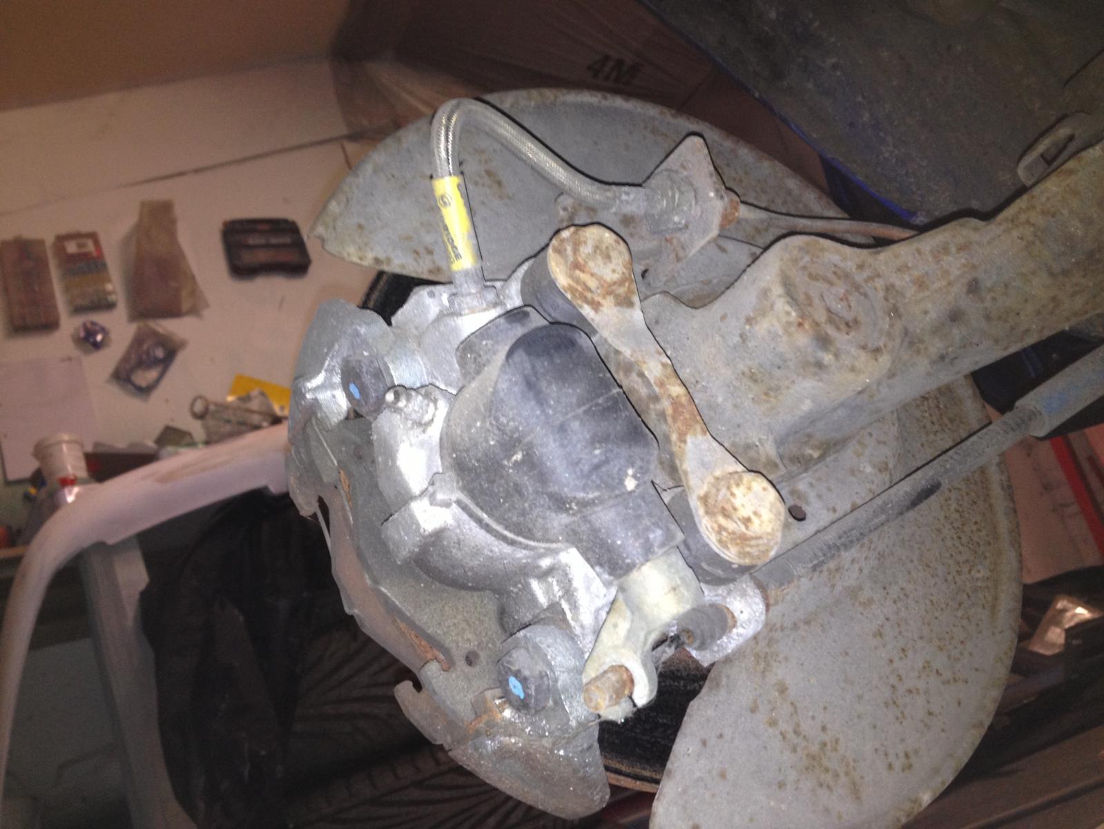

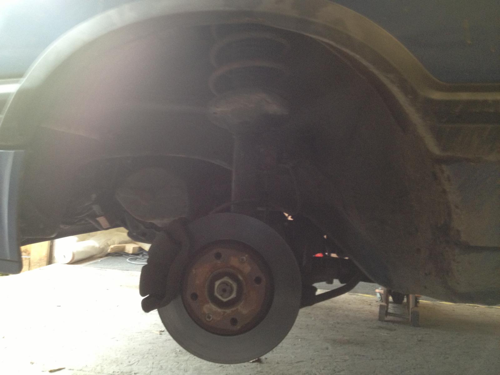

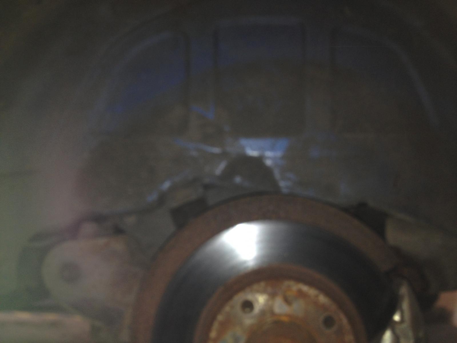

Next was to check the under arches which were surprisingly good :) looks like i have blisten shocks and springs and spax ajustable rear dampers

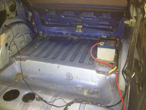

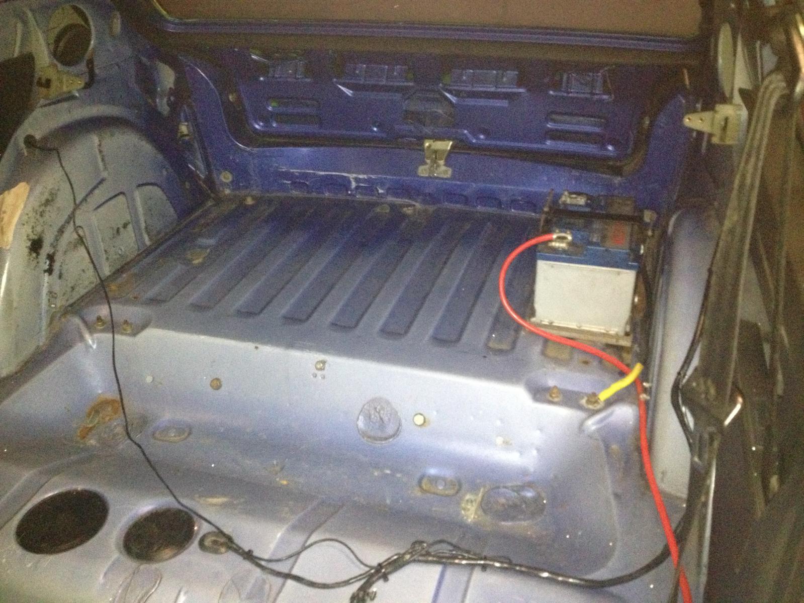

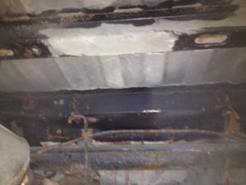

Next was to check under the boot, looks really good and by the looks of it someone else has treated it before in the past.
someone also kindly put goodridge braided hoses all round for me :)

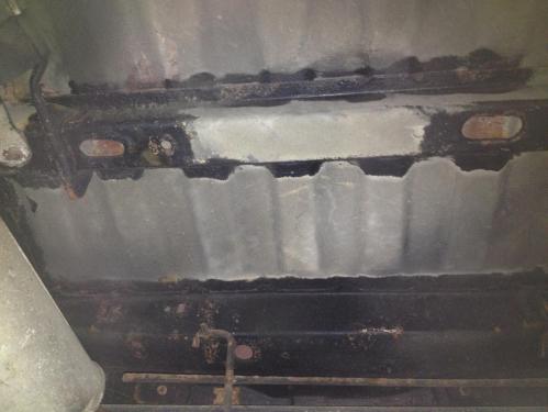

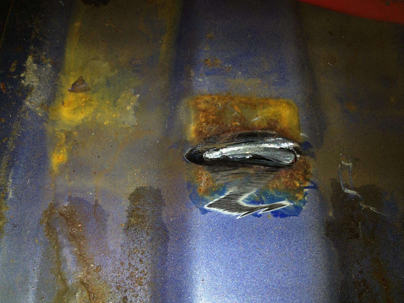

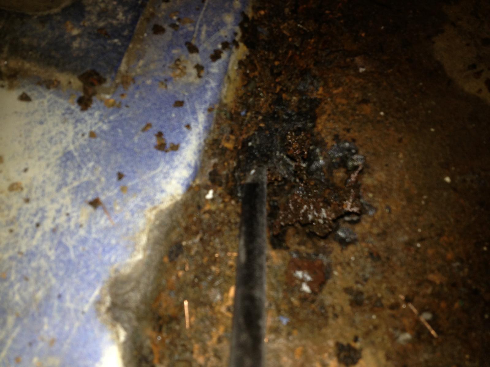

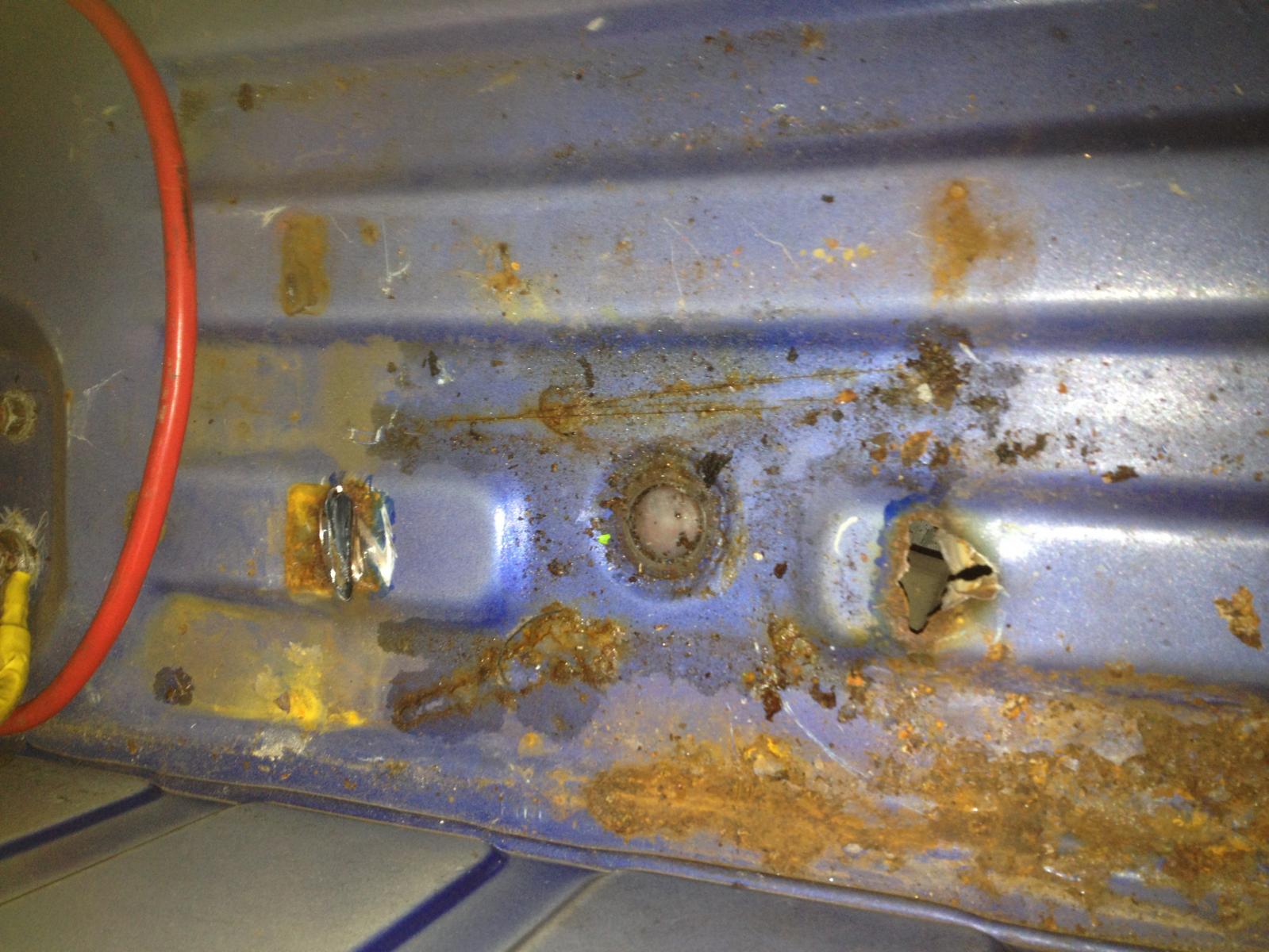

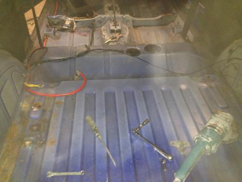

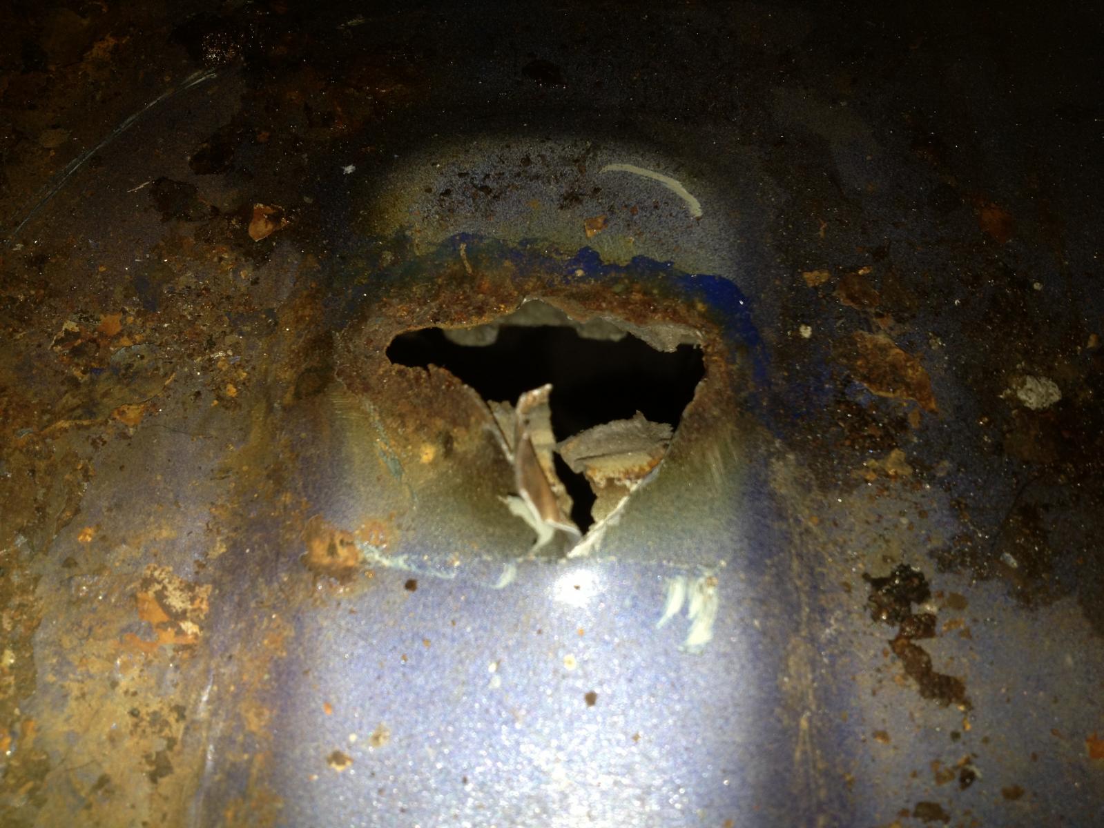

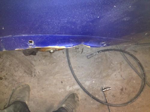

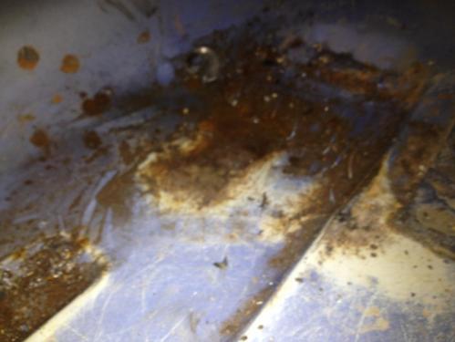

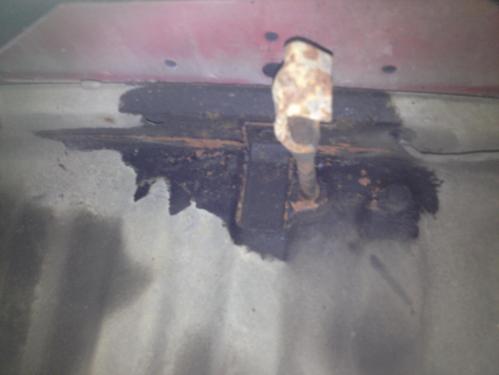

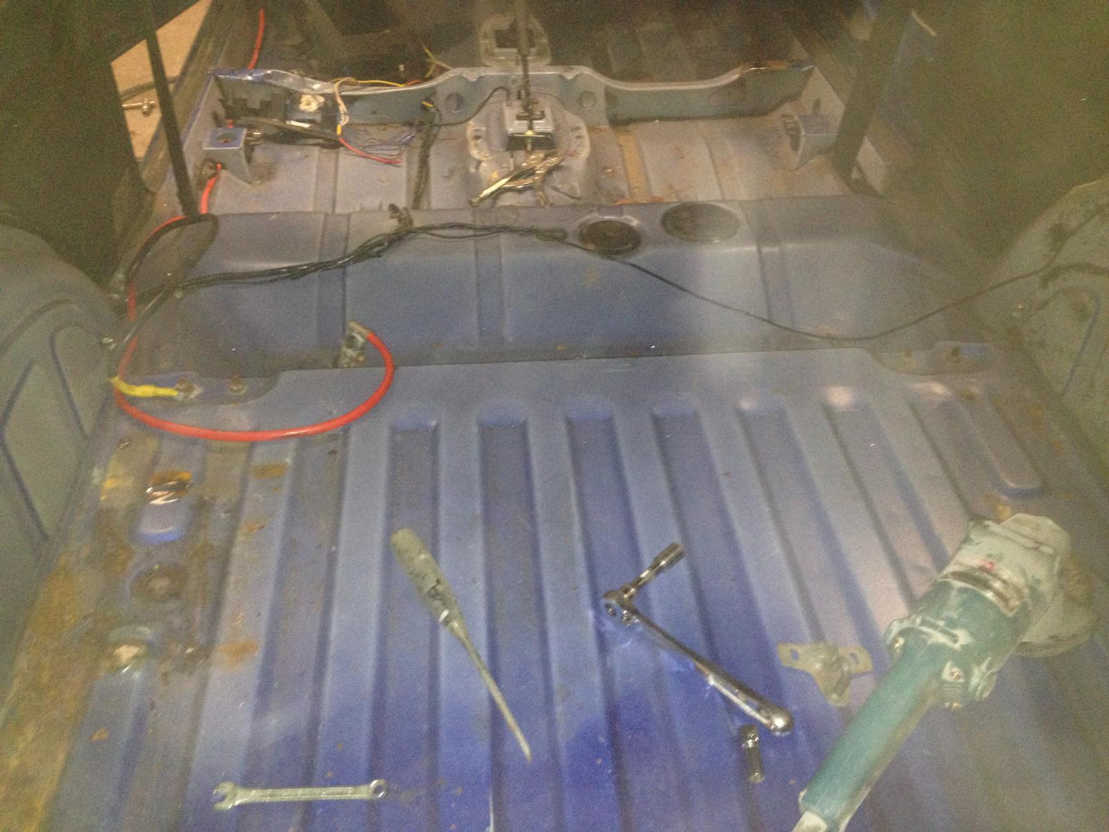

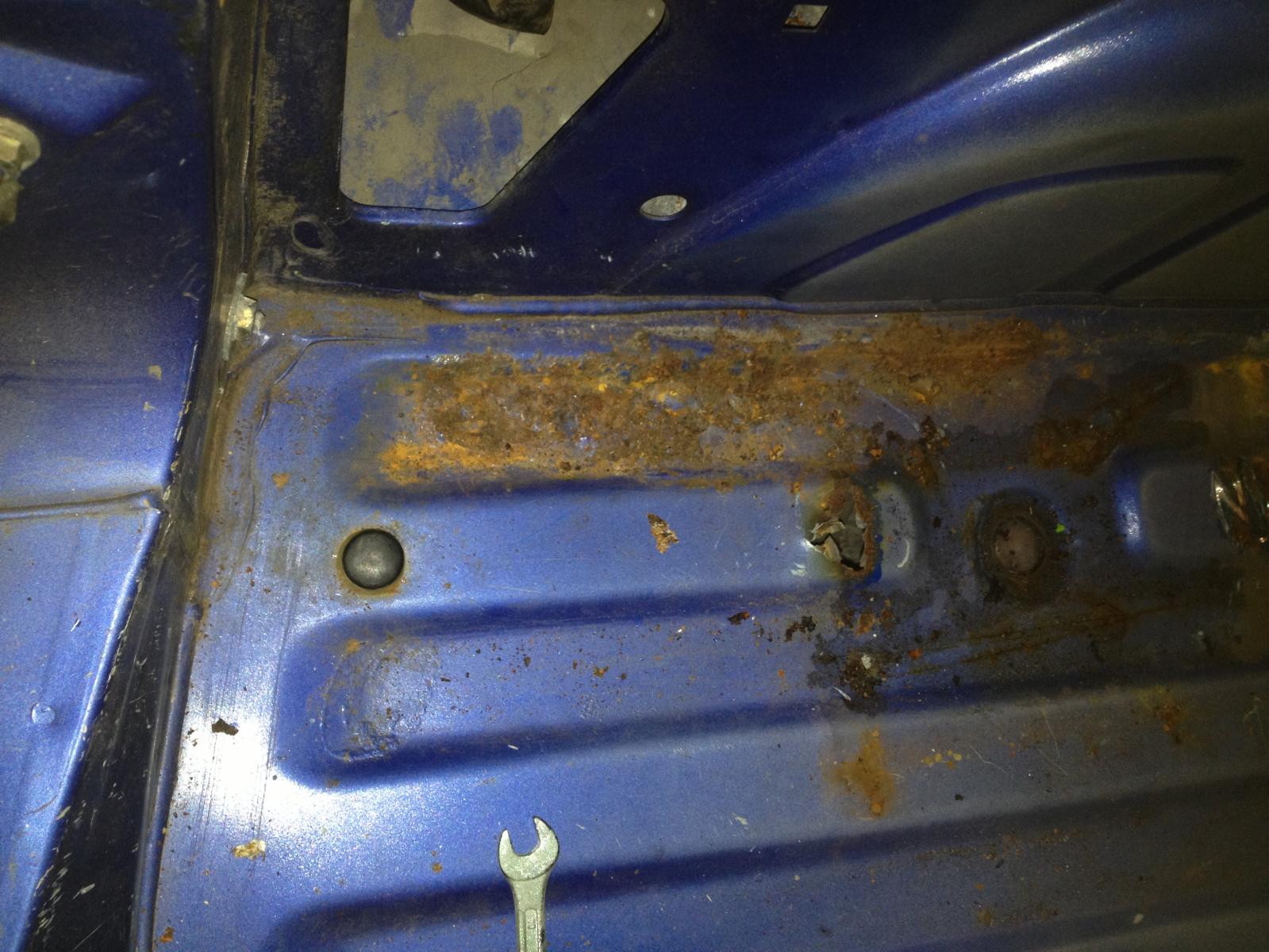

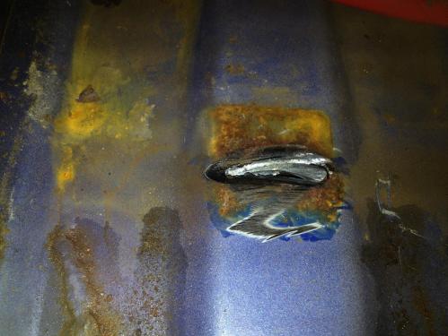

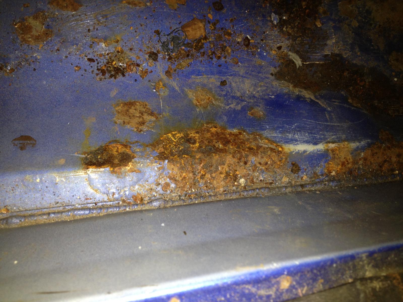

Time for the RUST! really was not bad at all, some twit decided to weld the battary relocation frame to the boot floor so that caused two holes getting that off, but the metal underneith it is still strong. there was only 1 place where the rust had actaully gone through and that was on the drivers side foot well its the size of 5 pound coin. heres the pics

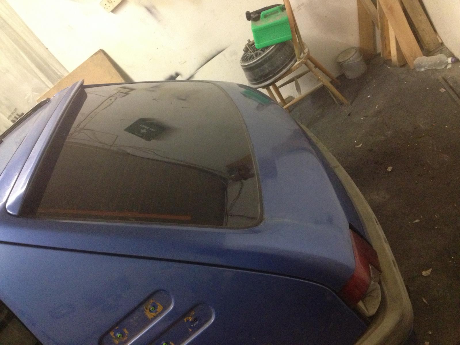

some boy racer stuff lol

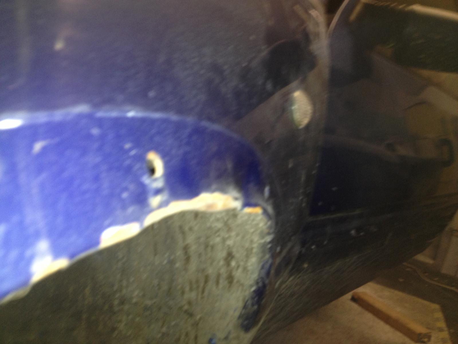

resault of lowering the front to much, cheers previous owner!

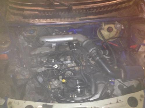

Does anyone know if this is the correct engine mount to be using on the 8v turbos? it seems to sit really close to the rad.

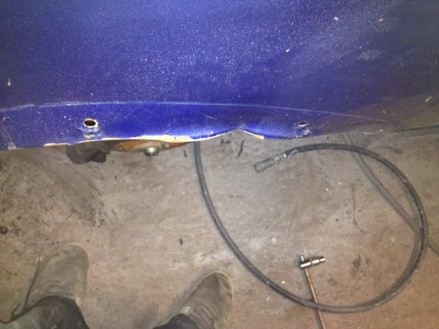

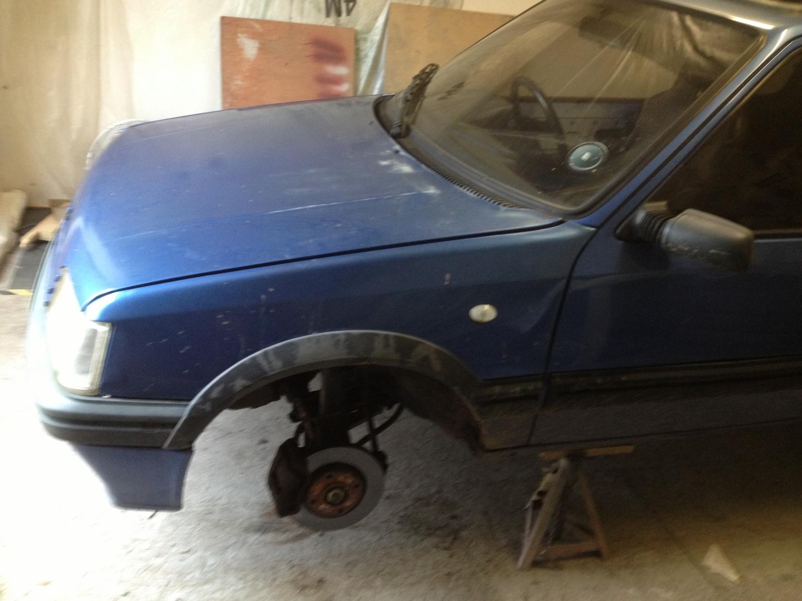

i then decided to tackle taking the wings off, and it appears that the passengers side wing is orginal as it was still stuck on with sealer. this was my first attempt at removing a 205 wing and i was going to replace it anyway but here is how it went,
some help from my pup aswell.
Edited by NFS
NFS
Finally got it off lol
and here is what it looked like when i got it off
But the sealent was doing its job, as there is no rust what so ever
infact this whole side see good :)

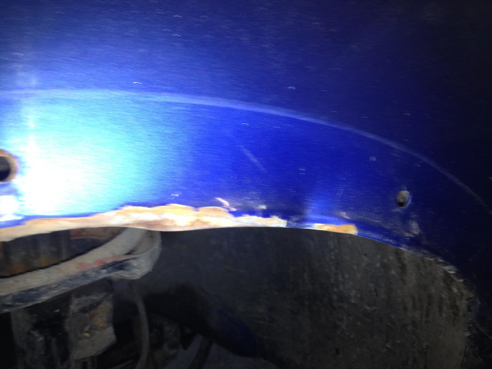

And then it was to the other side that just came off with ease as it wasnt sealed down as it must have been taken off in the past, its rusty but nothing too bad at all just a clean up :ph34r:
so it looks like i will be replacing that part of the front.

Spent Wednesday night removing the rear beam, degreasing, wire brushing and applying rust treatment. This was a messy job lol
Firstly got the rear beam off.
Then realised that by leaving the engine in and it being on axle stands, when you remove the rear beam there is no longer enough weight at the back to hold it down, (the panicy moment where you have to jump on the boot opening to hold the car down lol)
This actually wasn’t a bad thing as it gave me a huge amount of room to work on the underneath.

So spent Saturday day rubbing down the underneath and after reading through a fellow members resto thread it was suggested to remove the petrol tank as I was originally going to leave it on there, and I'm glad to say it was a good choice. Took all of ten minutes to drop and look what lurked behind,

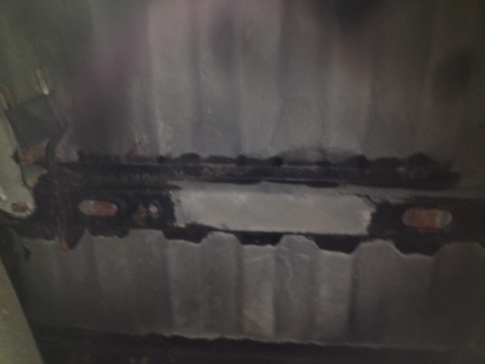

I also degreased and applied underseal to the wheel arches so its fully protected in the future and hopefully reduce the road noise inside the car.
Edited by NFS
NFS

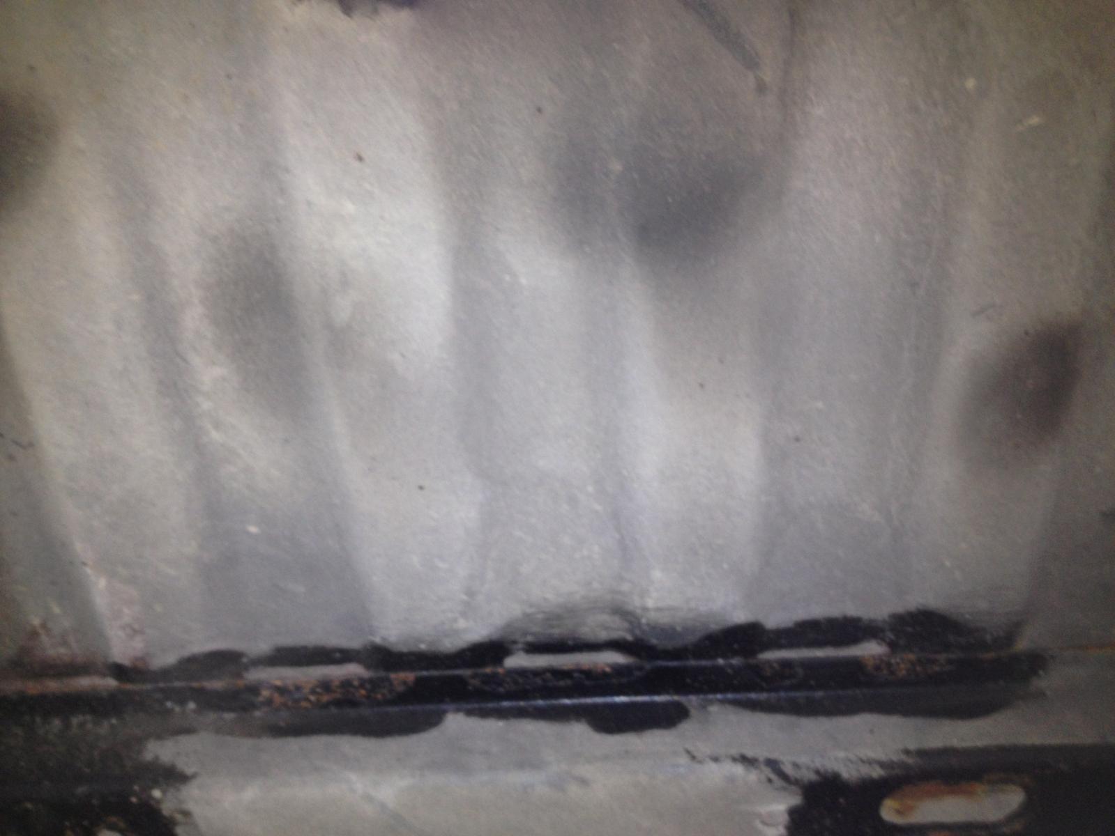

Also applied underseal to the underneath, its only 1 coat at the moment, I'm putting another coat on this week, to make the thickness and coverage,

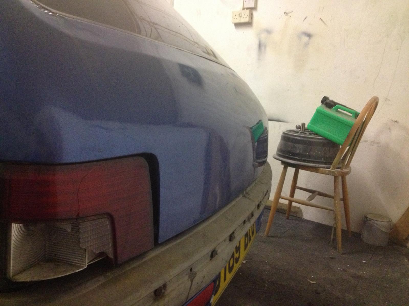

also can any guess whats missing? came off with the bumper
The cut out from underneath, just need to buy a welder now to finished this bit off.
