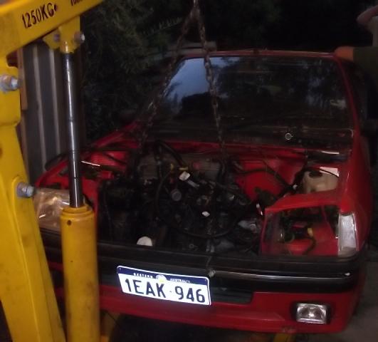

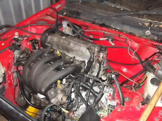

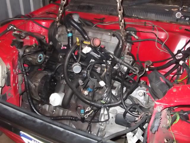

Hi All,
An update at last. :) Just got the engine/transmission in today. It is an XU10J4R (RFV) with the gearbox described in the post above.
The gearbox did not want to mate up to the engine, we had to pretty much pull it together with the bolts that hold it to the block. Does that seem normal? It seems to spin alright.
Here's a few pics:
calvinhorse
Does the clutch arm feel like it's engaging and disengaging the clutch? Does the engine turn over without nasty noises from the clutch end?
205Mi16Mick
Sort of. It's very stiff and it doesn't feel like it is overcentering if you see what I mean. I.e. progressively getting stiffer then getting softer. There are no wierd noises coming out of the bellhousing.
