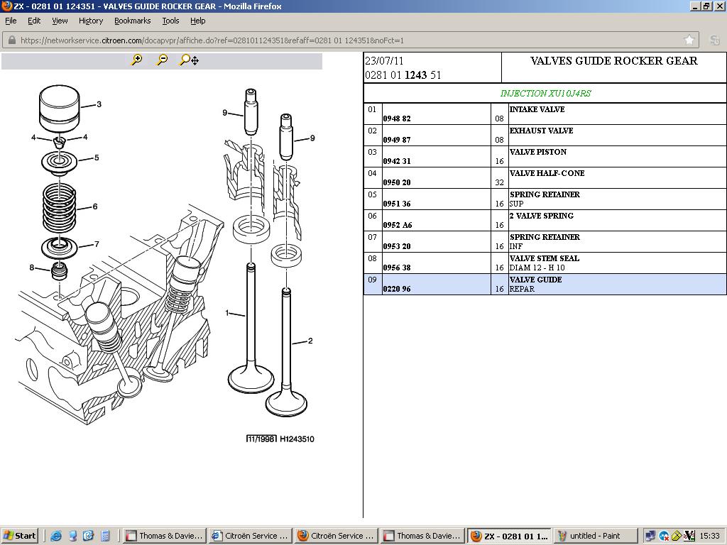

S@m
If you want a more representative picture go on citroen service rather than servicebox. Its a lot clearer and shows all the parts nicely. (in this particular case - usually its the other way around!)

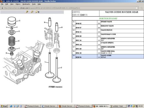

Here we go;

S@m
Servicebox is Peugeot - and the diagrams differ wildly so i always check both for obscure things. In this case the citroen diagram is better.

Here's a typical XU10J4RS valve arrangement.
The lower spring seat, i.d is circa 11.3mm, chamfers out to 16mm on the bottom, 13.2mm o.d inside the smaller spring, 19.3mm inside the larger spring, 28.3mm overall, steps go 1.3mm, 3.4mm, and total height is 5.3.

S@m
:lol: I like how the 'typical' gti6 valve arrangement shows a severely bent valve - sounds about right!
