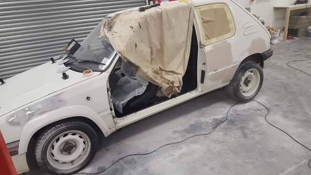

Quite a lot has happened to the car over the Christmas period. It started off by hearing that a family friend had started his own bodywork garage and was looking for work to do 'in-between' jobs.
I have never been happy with the finish on the bonnet and there was a bit of rust coming just below both rear windows and on the passenger door so I took the car up for a quote. After a bit of talking and deciding that if I was getting those bits done the rest wouldn't look as good, I had it booked in for a full re-spray! I didn't plan on this but the opportunity was too good to turn down!
5a3a8c7570b60_FB_IMG_1483457503703_zpsksdghv371.jpg.f9a63c52938732c22b16b3931aa352a8.jpg
Looking very bland in plain white!

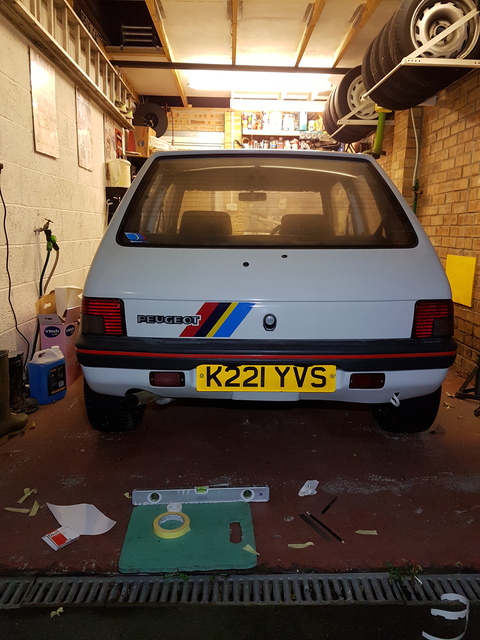

Putting its new rallye bits on.
Got more stickers to put on and the inside needs a good clean after a lot of dust got in. Very happy with it though!
