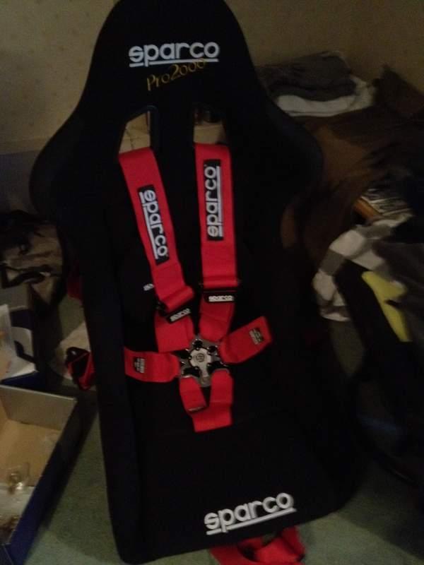

A little picture of my seats and harnesses

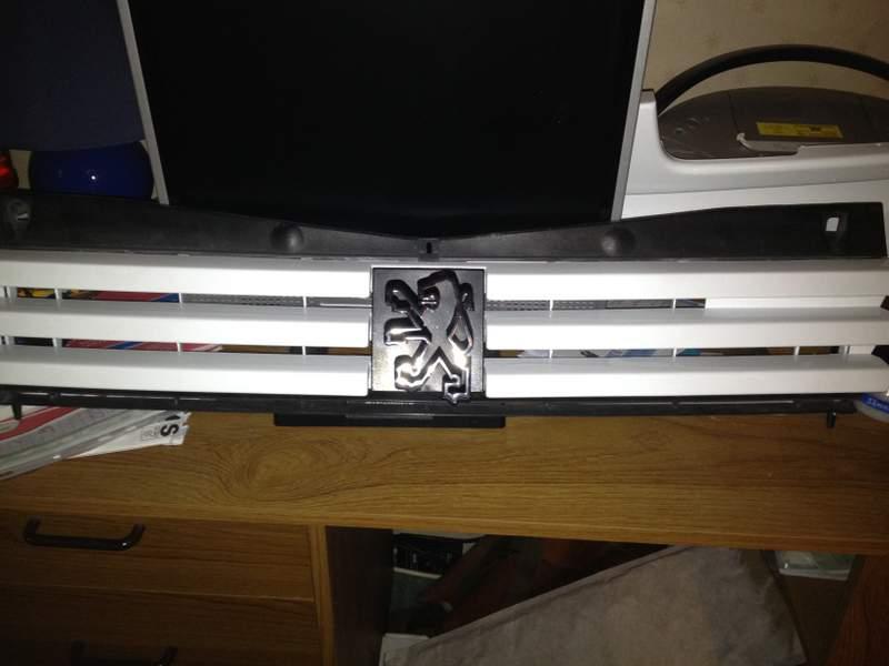

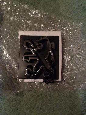

New peugeot badge

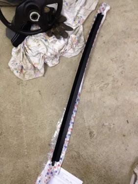

New window scraper from peugeot

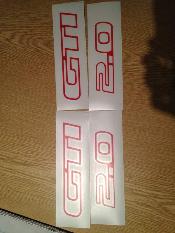

Got some 2.0 rear quarter stickers from skyquake, very nice aswell, i've been chasing these for over a year through various people

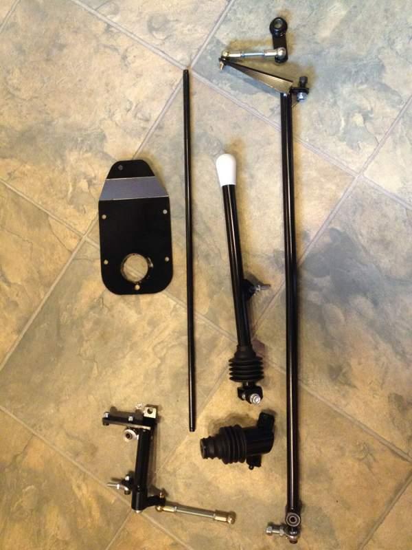

I bought my Satchshift over a year ago, it was one of the first things I bought

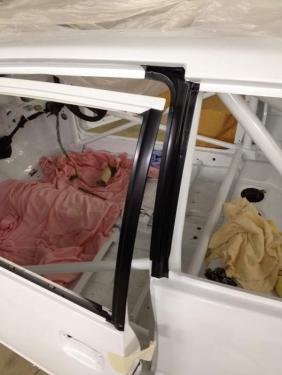

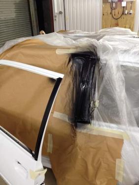

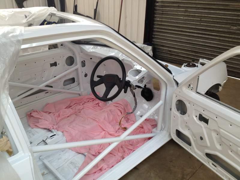

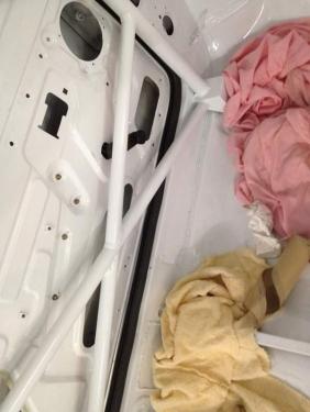

My mate who painted the car came around and painted the b pillars black

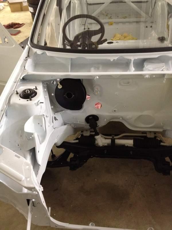

Re-fitted steering column
Gave pedal box and servo a lick of paint and re-fitted

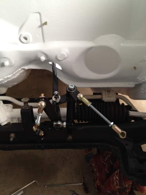

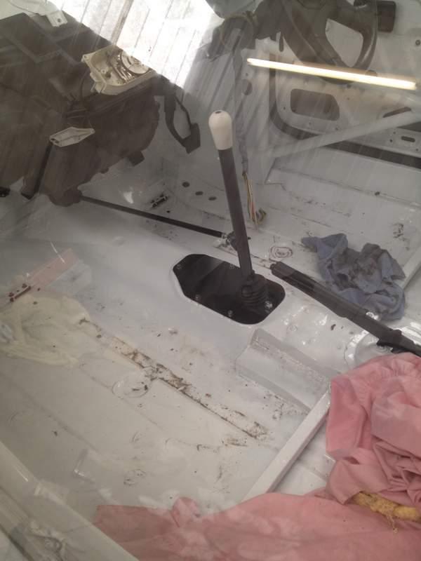

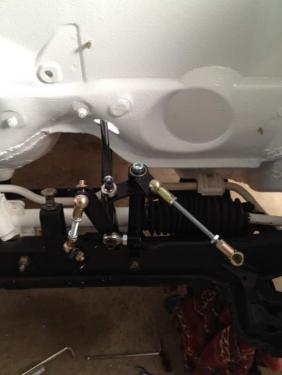

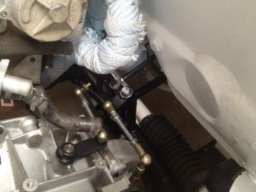

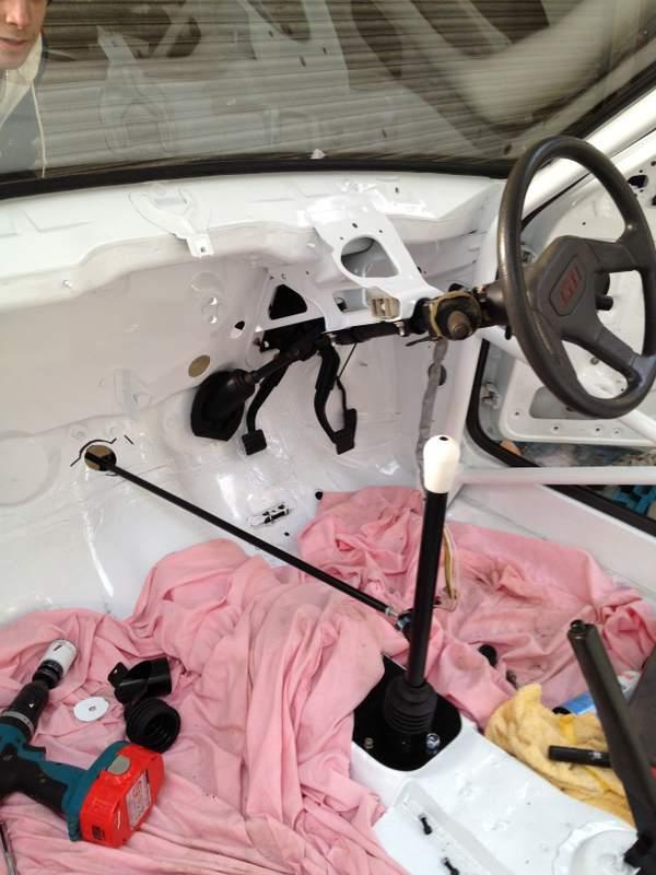

I mock fitted my Satchshift so I could figure out where to drill my hole in the bulkhead
Then removed this as it made climbing around inside difficult to say the least.

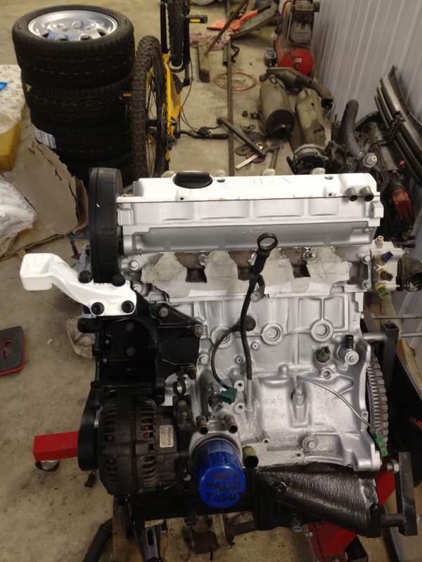

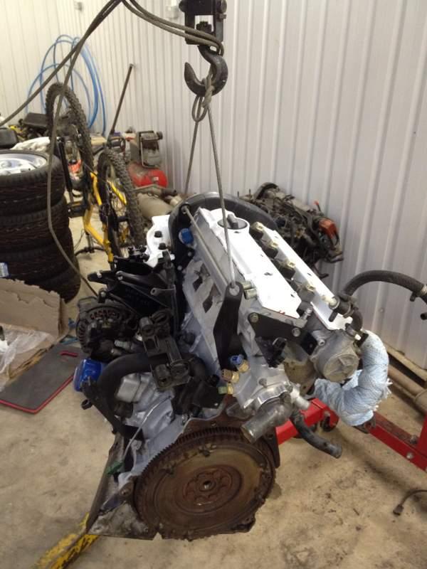

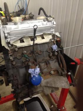

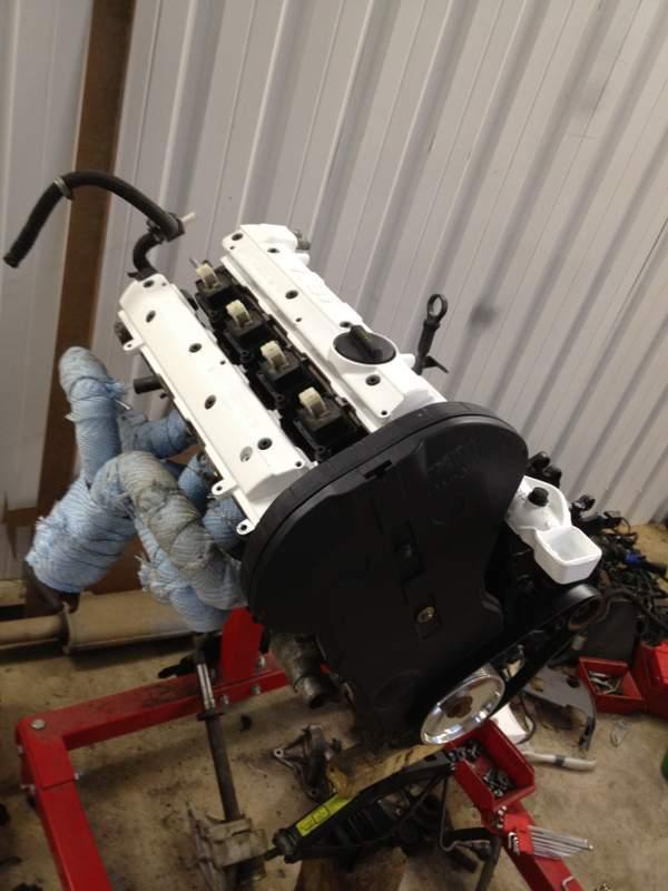

Then I FINALLY started on the engine

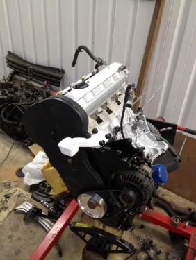

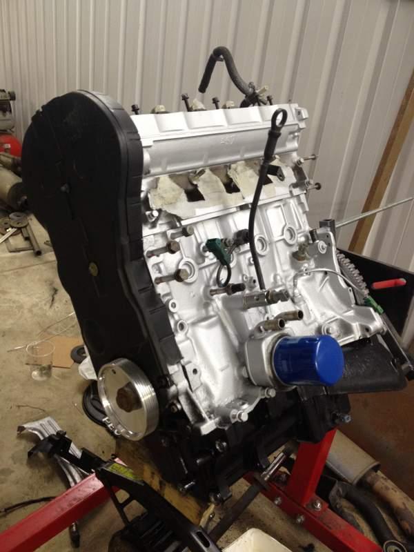

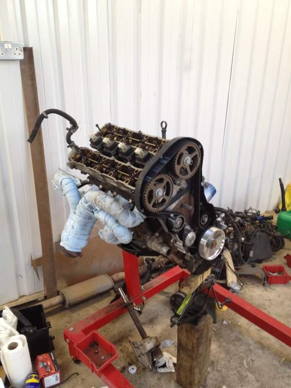

Stripped it down to clean and paint, did sump in black hammerite and block and head in zinc, galv spray

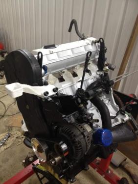

I put a new cambelt on, new waterpump, new ngk plugs, new oil filter, shiny new ally crank pulley off rich walker.
Set about modding the exhaust manifold, stuck a 3mm grinding disc through it, then widened it a bit, pulled it until it touched then welded up
mech205eng
Heat wrapped my manifold
Re-fitted it with new brass nuts

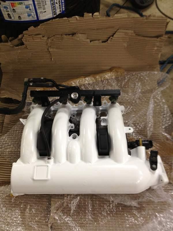

Sent cam covers, inlet manifold, engine mount off to be powdercoated white, sent throttle body off to be bead blasted (then I would paint it white), sent thermostat housing off to be bead blasted, got engine cradle blasted then a lick of satin black.
Painted fuel rail too.
I'm not running p/w steering so i bought a 700pk belt, took my old cambelt tensioner and turnd down and M16 allen bolt so it had a 13mm shaft and M8 thread so I could tension my alternator

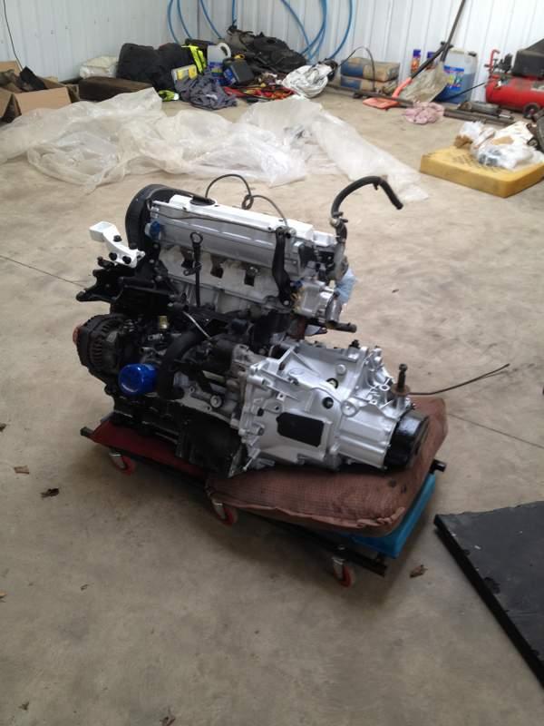

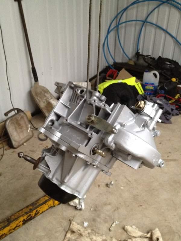

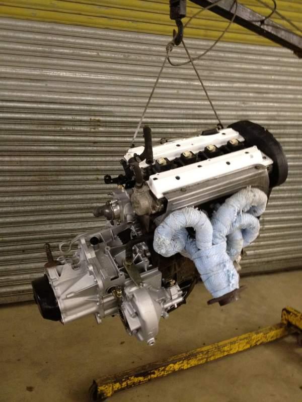

I painted my gearbox

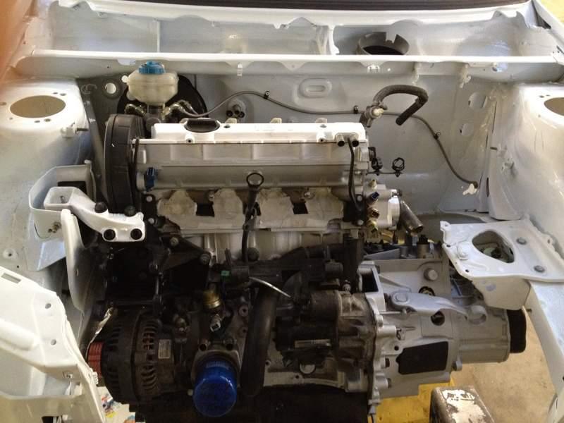

Got my engine off the stand, fitted a new clutch, slid gearbox on, bolted starter motor on. We were good to go :D

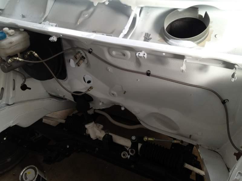

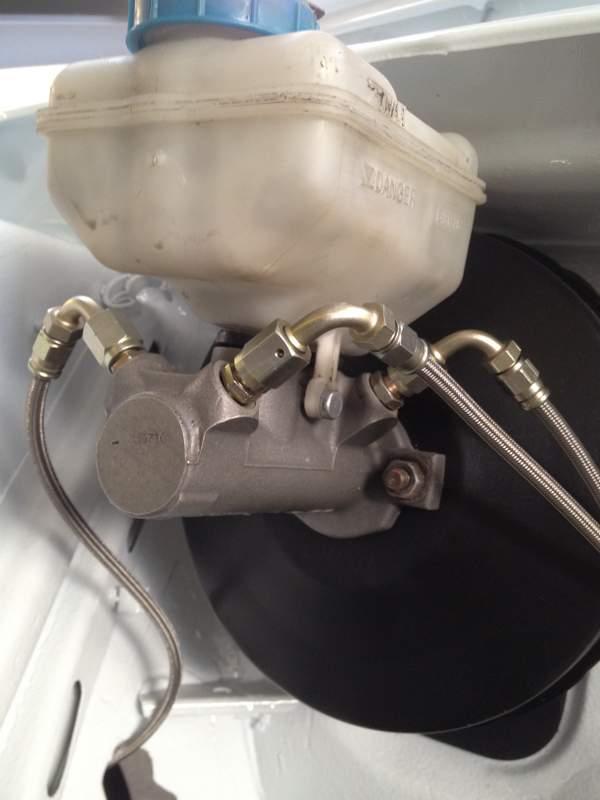

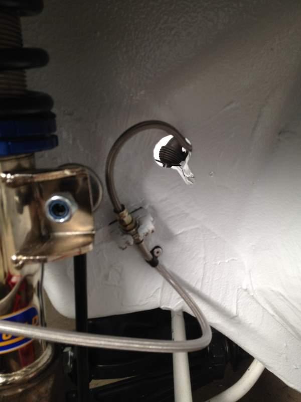

Before I put the engine in I needed to do the engine bay brake lines. Can't remember if i'd mentioned it earlier but i'm doing the whole car in braided hose and running it inside. Fitted a 406 non abs m/c too.

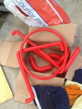

Got some bakerbm engine mounts and a red silicone hose kit
mech205eng
This has nothing to do with this car or 205's but I saw it on facebook and loved it

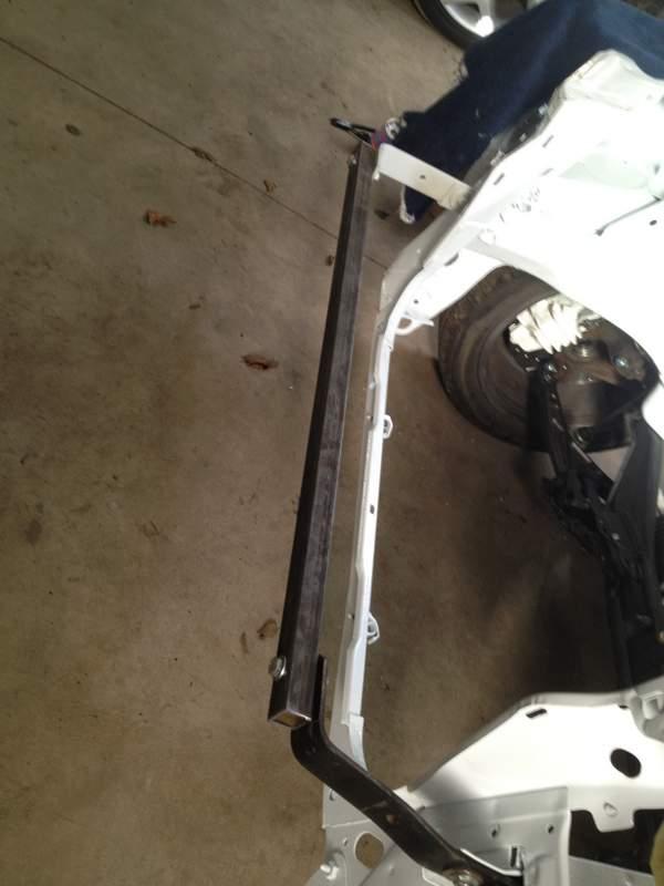

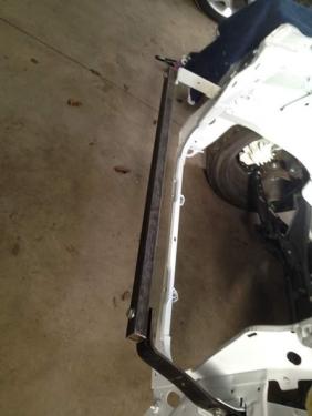

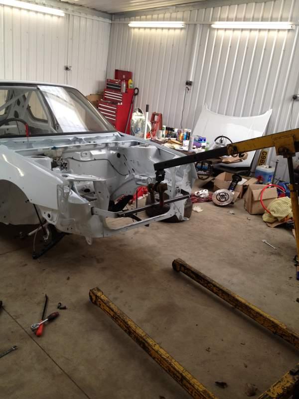

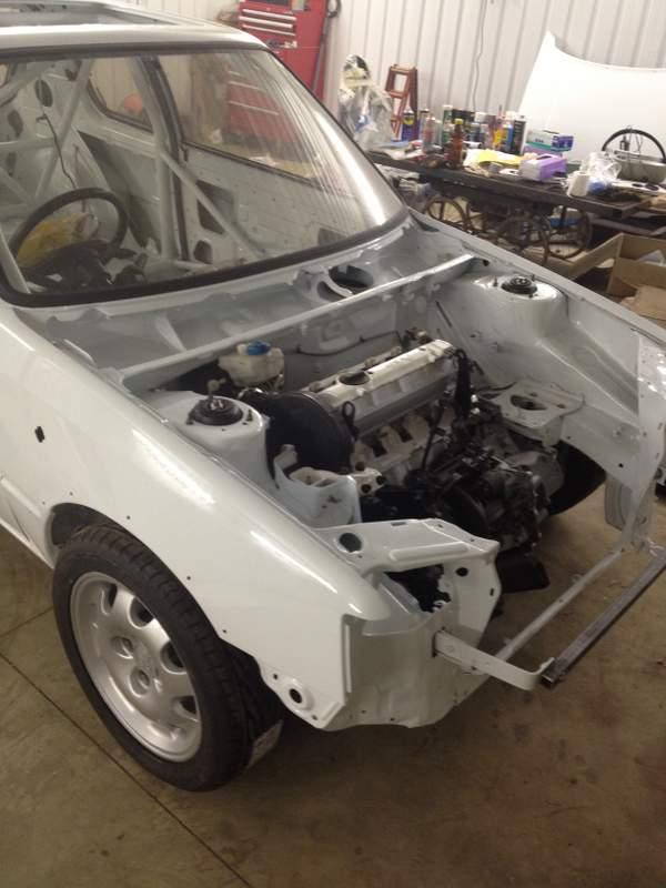

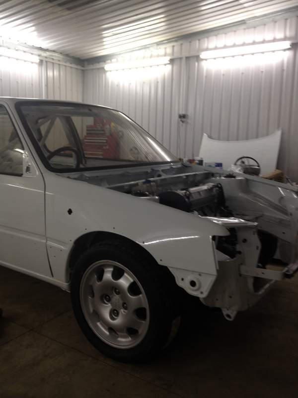

I figured it would be easiest to put the engine in by removing the subframe, picking the front of the car up with an engine crane and sliding the engine and box under on my creeper, this would also hopefully protect my shiny paint.
I made this out of some 1"x1" box and attachted it to the bumper brackets which bolt to the chasis legs, although there is very little weight in the front end I wanted to spread the weight evenly.
Got engine and box sat on my creeper
Lifted car up
And she was in

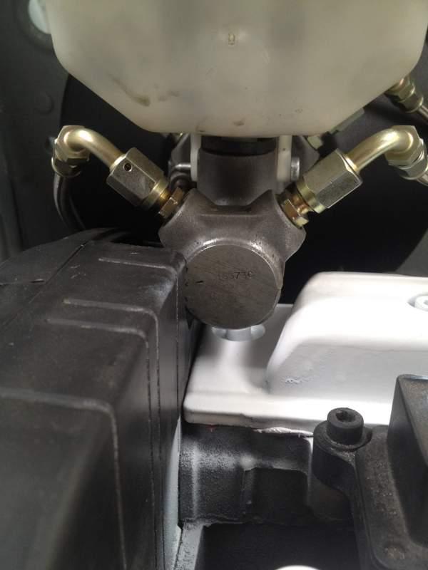

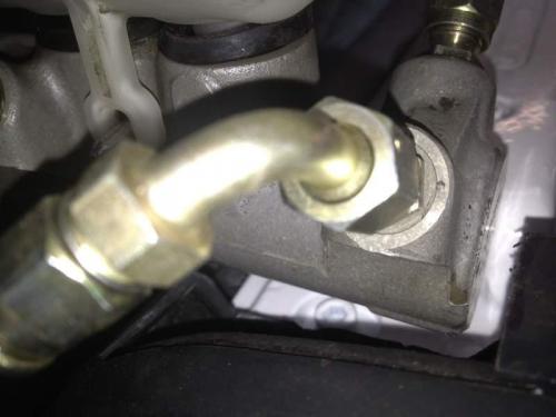

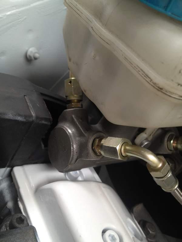

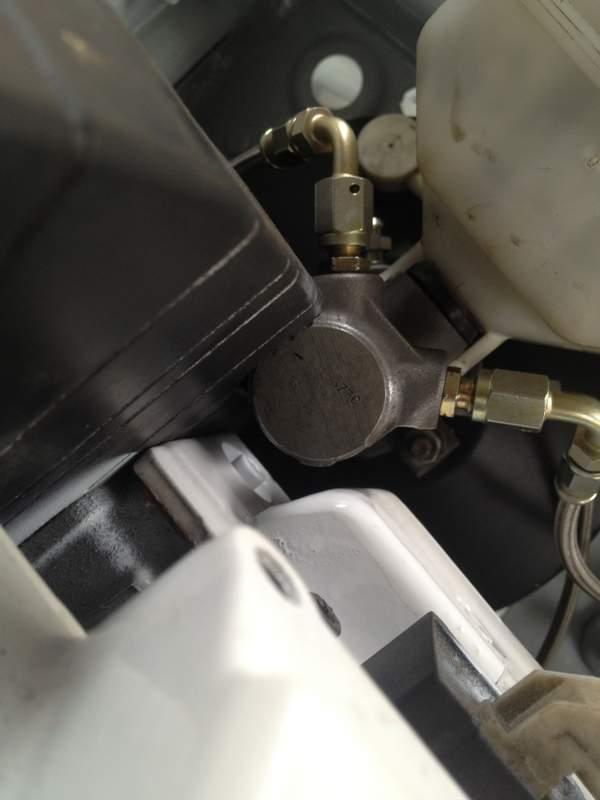

Master cylinder clearance was terrible

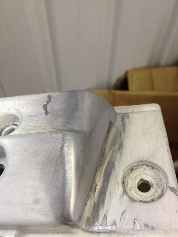

Took it out to sort clearance, had to grind away at my powder coated cam cover, ground too much and broke through, was sooo pissed off! But i tigged it back up and painted over it.
Also cut my cambelt cover too

Took the engine out and back in a few times, exhaust manifold clearance is spot on (was a bit worried I wouldnt of bent it enough), put subframe back on and bolted rear engine mount on so I couldnt see where it would really sit. Used a solid fork bush too.

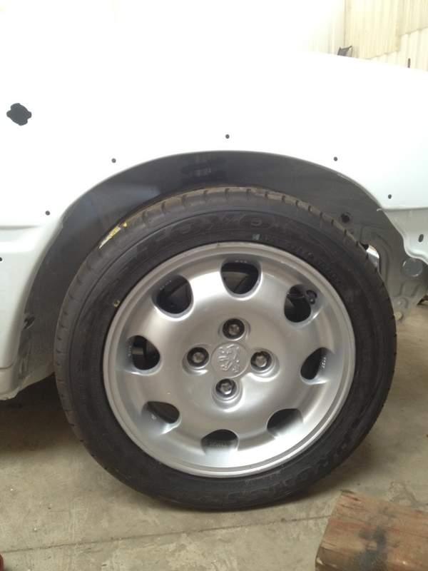

I took the helper springs out of my coilovers while they were out as they were doing nothing and it sat too high. Now with the weight of the gearbox and engine in I can see it will still not sit very low. Here the coilovers are wound down nearly as far as they'll go
I don't wamt it to be ridiculously low though so it'll probably be alright as it is. I'm guna need some spacer on the front though because the inside tyre wall is rubbing on the locking collars of the coilovers because they are that low. No problem there though. Ideally I could do with some shorter springs but I can do that later.
Forgot to mention before I put the engine in I put all the blowers, heater matrix and all that. I've got my satchshift back in to see if i could select gears, I can and it feels amazing!

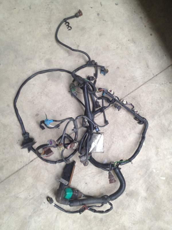

Bought a gti6 crank sensor off Dan (chipstick) and sent my looms off to spiky, got that back today

One thing I forgot is I did need to space the bottom of the pedal box to get that master cylinder clearance

That IS pretty ruddy low tbh, pop an arch trim on and youll see ;)
Also have a look at the wishbone angle, and how much damper rod is still visible...
mech205eng
i held an arch trim in place and it did look a little lower. I reckon when I get all the arches and bumpers back on it won't look too bad. My wish bone angle is completely horizontal, what is its optimum angle?
