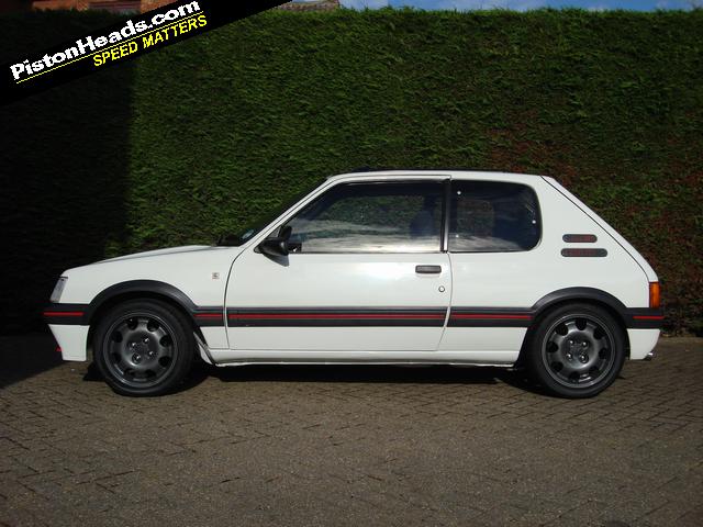

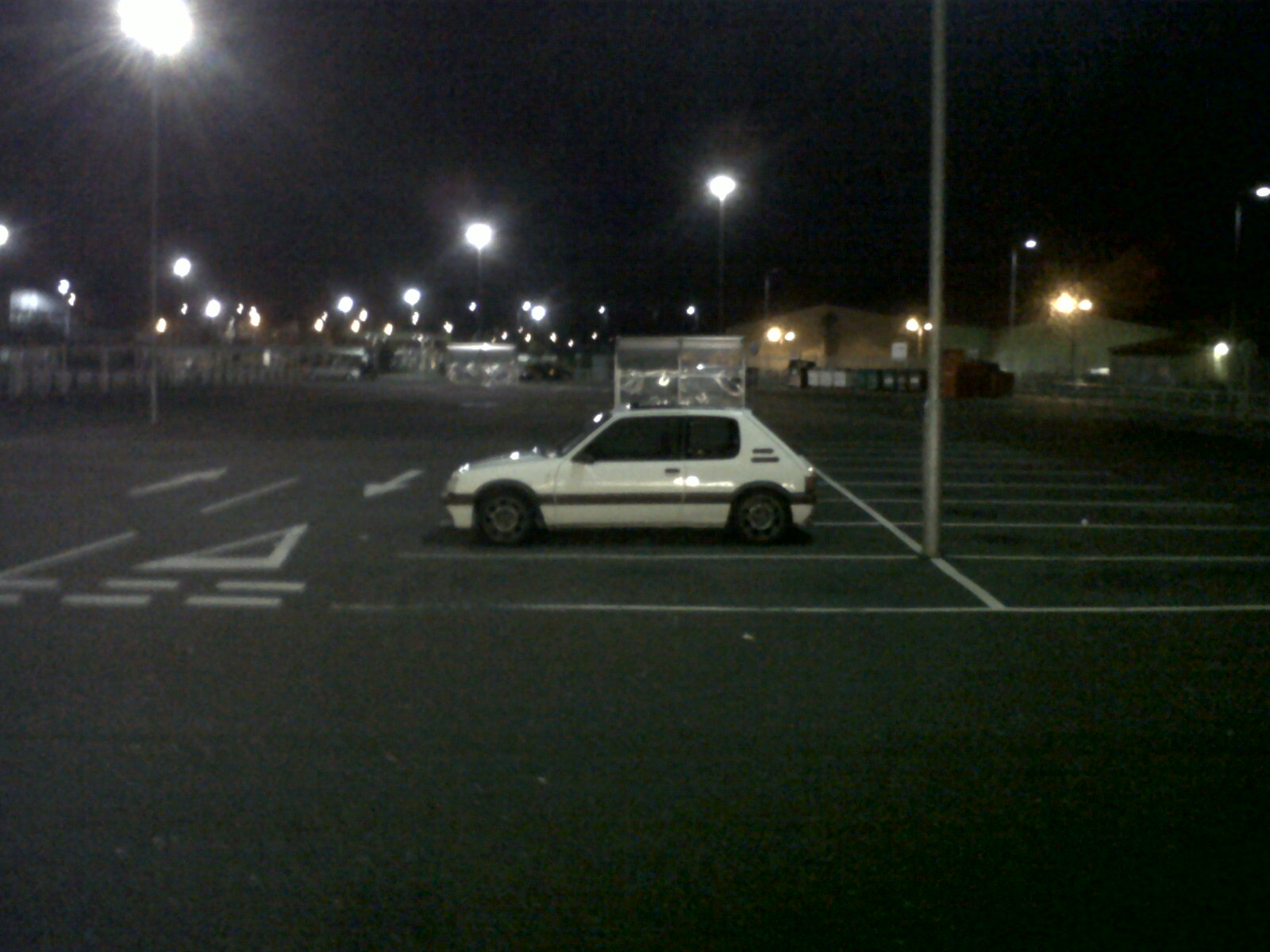

Hello all, I have already introduced myself before but here is my full run down on the car and hopefully my progress through getting it to a standard where i will be happy with it.
The 205 originally a 1.6 GTi and had the conversion to a XU9J4 engine in November 2010 by Spoox Motorsport and it was an intended track-day car until i had purchased it at the end of June this year
http://www.spoox.co.uk/catalog/
It has had an extensive amount of work done to it but i am in the mind that i could do with maybe advice and help in the work that shall need to be done as it is my first pug and especially one this quick and nice.
The stuff done to it already is as follows :
Automatic bonnet fitted and painted
3 Piece Clutch kit
Spoox motorsport 4 - 2 - 1 Exhaust Manifold
Spoox motorsport custom inlet manifold valve
Spoox motorsport ITG Air Filter
Spoox motorsport uprated lower engine mount
Some mad South African alarm thing
It has the 1.6 BE1 Gearbox still and is in as much as original condition the wheels were acid dipped and powder coated just before i had bought the car
I am having some issues with the engine it can give more but how would be the best way of going about it , I am thinking of weber carbs but would that make a difference over what is done ?
Thanks for looking

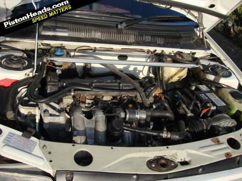

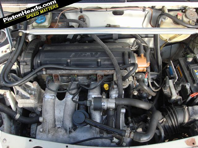

I looked in the filler cap when i noticed i lost some oil and it was packed with sludge up to some of the pipework behind the air filter which am told means i need my cylinderhead skimmed as well but when i did my sump gasket they only used that orange instant gasket and i am thinking that, they might of done that on the cylinder head as well but it is a lot of messing about when i potentially couldnt be ready for the amount of work i will need to do if it isnt just some quick fix as the oil pressure increases when i accelerate and it drops really low when i pull up to a stop or idling. Is there any way of checking without losing use of the car? As i need it to get about even to get a munch from asda's. It also i think is the cause to the car " coughing " when i pull away on the first use of the car that day
I will stick up a pic of the sludge later on when i get to the car as it is always on the mind when i have to drive it
kyepan
Mayo is normal! the mesh is there to collect it.
The oil pressure sounds like it's acting normally, remember that the pump spins at engine speed so the pressure will rise with revs until a point when the pressure relief valve opens and is constant.
When warm the pressure will be low at idle, only start to worry if the stop light comes on. Which it may do in summer with a thinner oil that needs changing.
Look up 26 tooth sprocket, and 2 bar spring.. as those are some of the ways of increasing oil pressure, either that or fit a mechanical gauge to be sure what it's doing, as the electric gauge is slow to respond and usually fairly inaccurate.
Get bodies - far better than carbs for reliability and fuel economy.
dcc
unless already doen so, remove and replace the mesh.
It breaks up and small bits wil find their way to your bearings.
As for 'releasing' more from your engine, you have to think about what you want to spend. for £1200~ Id get a mappable ecu, loom and map done. for £2500~ Id get throttle bodies too!

This might sound like a stupid question, but The Mesh? I might not have that bit as i haven't seen it yet. Can you tell me where about to locate it ?
I want to hopefully charge the engine, I like the idea of supercharging it but can that be done with the engine on tilt like it is? Would it be easier to turbo charge it ? I am not concerned of turbo lag at all i want to be able to drive hard and keep it as turn key simple and reliable, if that's possible. I like the eagerness of the car and how fast 3rd gear up is.
What is up with the tilting of the engine? and if the Mi16 is put back straight is there a reduction of space where the bodies would go ?
P.S After checking the paperwork it says i got the motronic engine management and ECU, am I right in thinking that is the standard ECU and management ?
Baz
Yes.
Does the car or you have anything to do with sPOOx?
kyepan
you have too many questions!!! in so far as you haven't chosen a direction.
Get reading some turbo and supercharged projects on here, and throttle body conversions for that matter, have a look at my thread if you want to see what a rebuild and ITBS conversion involves (although i was a bit anal about it).
Motronic is the correct management for an MI-16
