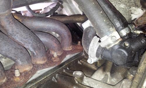

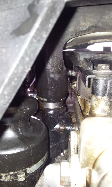

I know it’s a common post and I have done a search but please can anyone help diagnose a leak on my Mi16? Seems to be coming from the back of the engine somewhere.
I’m getting it ready for an MoT after 4 years off the road and noticed that it was pretty oily around the offside driveshaft. At first I thought it was grease from a split boot, but having cleaned it up a bit and changed the engine oil I’m pretty sure it’s engine oil coming from somewhere. I can’t see where it’s coming from, other than it appears to be coming from somewhere above what I think is a coolant hose connector block;
Are there any common/known leaks from this area that I should be looking at?
Many thanks,
Justin.
kyepan
My initial guess would be cam shaft pulley oil seal, cam belt end.
Alrhough it could be rocker cover oil seal or head gasket.
See if you can get a small inspection mirror down behind the cam cover at that end to look at the cover.
Same with the inspection mirror but this time above th water distribution block, to see the bottom of the head.
Taking the outer cam belt cover off will tell you if it is the cam shaft pulley oil seal for sure.
If its been sitting for four years you could take the opportunity to change the cam belt, doing the oil seal is a matter of removing the pulley when the pistons are all safely at half mast. (rocker cover may also need to come off if you forget to slacken the pulley retaining bolts after taking the belt off.
