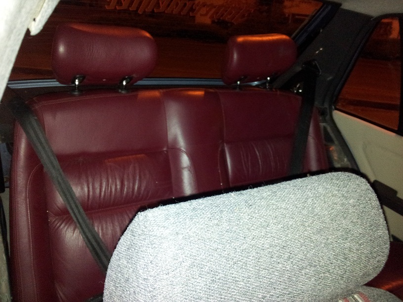

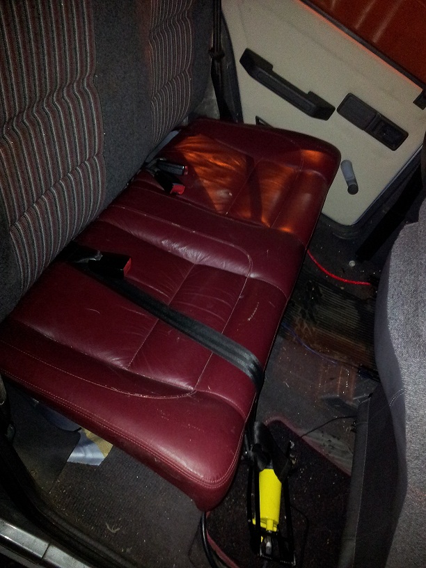

306 cab rear ones do fit but the are a little too small width-wise on the base and the backrest bits sit quite high. also the back rest bits will need to be attached to the 'frame' of the standard rears as they dont have any support as such, just molded foam.

few snaps of the 306 cab rear ones, this is in a 5door and as you can see, you get a little bit of visible uncarpeted floor, not really very noticable with the door closed, and not sure if it would be an issue at all with a 3door
and then the backrests, these are just rested in place, but gives an idea of how much higher they sit unless you tuck the backrest down and pull the base of the seat forward. little bit less legroom that way though.
there is also again a bit of space eaither side, where the frames from the 205 backrest need to go (just unzip cover and remove foam)

the backseat you can use (in most cases), is the one of a 205 with a full-leather interior. So you can see on the pics. I had a 309 backseat in the time of the Goodwood interior, because Baz says, it fits straight in.
The 306 interior is a whole other thing. And i'm still busy at the moment. The lowerpart isn't the problem. I already flexed the metal and foam to fit it in. The backpanel is the most challenging. The plan is to buy an old 205 panel, and place the (modified) metal sheet into the back of the 306 seat. The thing is, that the backpanel is offcentre and the 205 seats isn't. Maybe i weld it together. Don't know yet.
