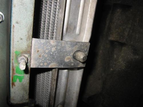

Right, just taking my radiator out due to a leak and though it would be a good chance to grab some photos. I used holes already present in the little towing eye type things. Also note my bracket is slightly bent due to having a fight with a field in a previous car -_-
As you can see there isn't much room and I've grinded some metal back, even so this is the reason for a hole in my radiator so some jiggling about will be needed
I will add a photo of how low the radiator sits when I put it back in. :D

No, I used the BBM item.

My god that is close!!! I'll have a play around at some point and see what's what before I put my order in.

Wow.. those brackets sit quite far back! I guess that's the problem when you need to leave the lower crossmember in. Mine sat right forwards so the fan motor was about 5mm from the back of the bumper, there was tonnes of clearance behind it then! If I'd have mounted the fan on the rear of the rad (which is more efficient anyway) then it would have been even better. :)
To answer a few points
These brackets were designed to fit with an 8v or Mi engine, picking up on the two "ears" on the front panel each side, which are the lowest point of the original shell steelwork. They are made with the intention to be a bolt on part with minimal need to cut and carve the shell for both ease of fitment for people who are not that confident cutting their car, and also to keep the possibility of returning to original in future if reqd. The radiator is intended to then lean forward away from the engine, however people have now used these brackets in a few different ways to suit their application.
I have used them to fit both standard and Turbo diesel rads in the front of my cars, one with the fan in front and the rad leaning at an angle, one with the turbo diesel rad stood upright, with intercooler in front and fan on the engine side.
They are tight on a GTI 6 engined car due to the pointless "wing" on the sump/block that sticks out, people have still successfully fitted them with some trimming.
