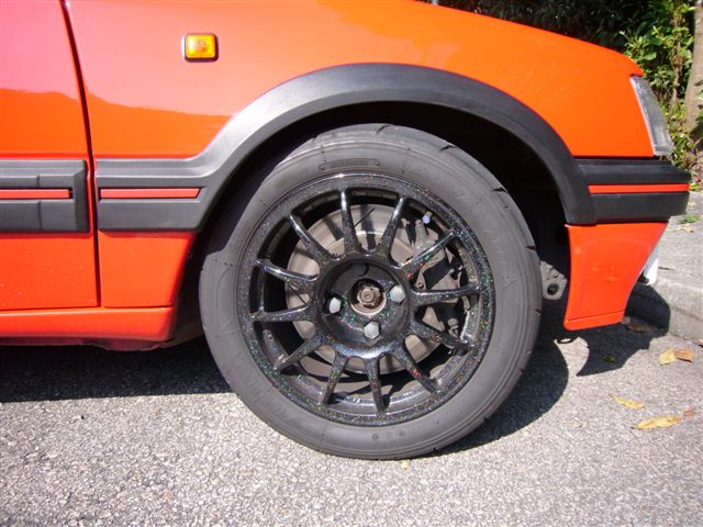

I've OZ superleggera's in 16", indeed very light
OZ Superleggera
Cast
15x7
11.5lbs
5.2kg
OZ Superleggera
Cast
16x7
14.6lbs
6.6kg

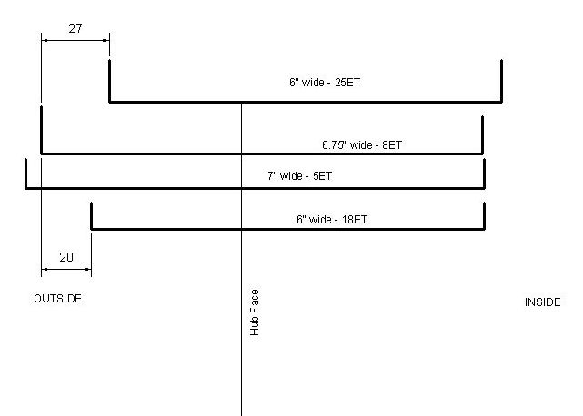

Secondly, I presume 15x7 in et15 would be the way to go.
No, you'd need an offset <10mm for a 7" rim, or else the tyre may foul on the strut. For example, a 15 x 6.75 SL434 is ET8. You need to draw standard rim in cross section, then overlay the new rim width and offset to see where the rim width goes.
15x7 et15 with 195/50/15s fits with standard struts. If your running coilovers you may need to run shorter springs.
