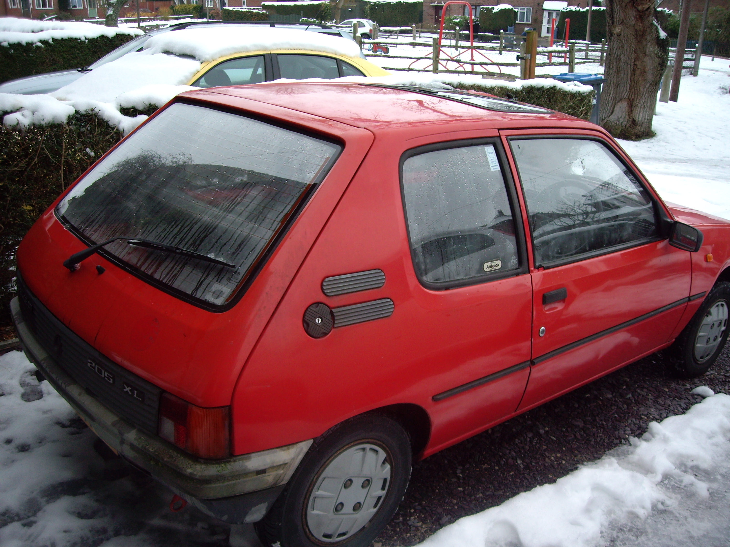

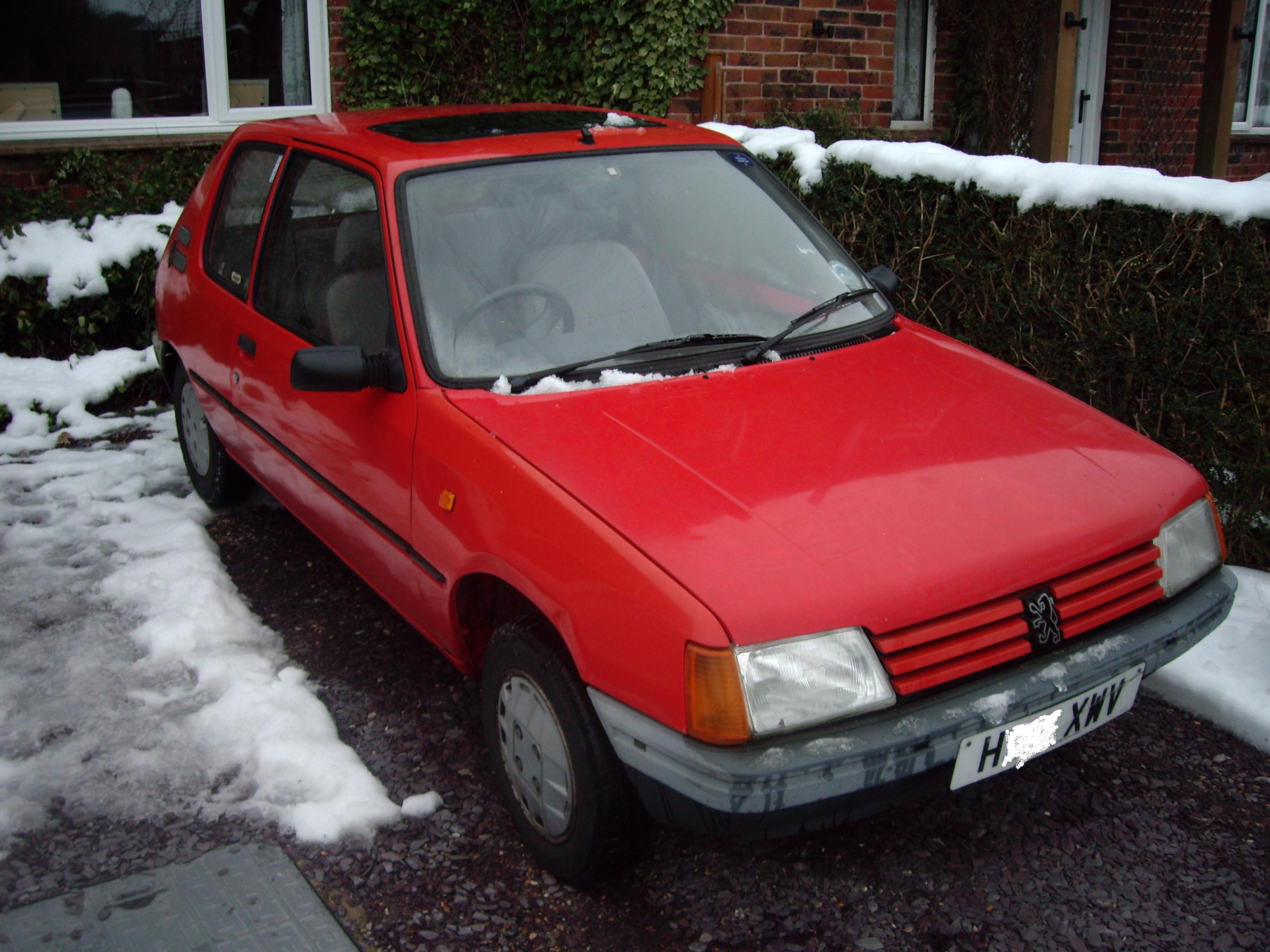

Basically I only got this car as somebody my mum knew was moving miles away and they were going to scrap it, so instead I gave them £50 for it which was a pretty good price I thought. The overall plan is to do a GTI6 conversion as from reading lots of posts on here and weighing things up I think it's the best option. The idea is to make a road legal track toy so 2 seats, roll cage, keeping the dashboard though. This probably won't end up being the most amazing conversion on here as it's being done on a bit of a budget but it's a good learning curve for me as this is my first project.
Below are some photos from the first day I got the car so you can see what I started with:

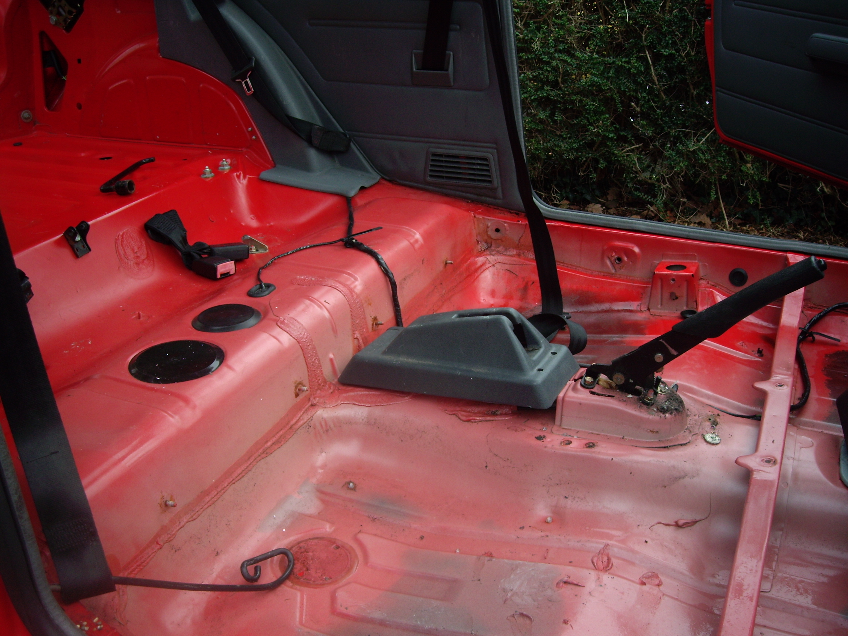

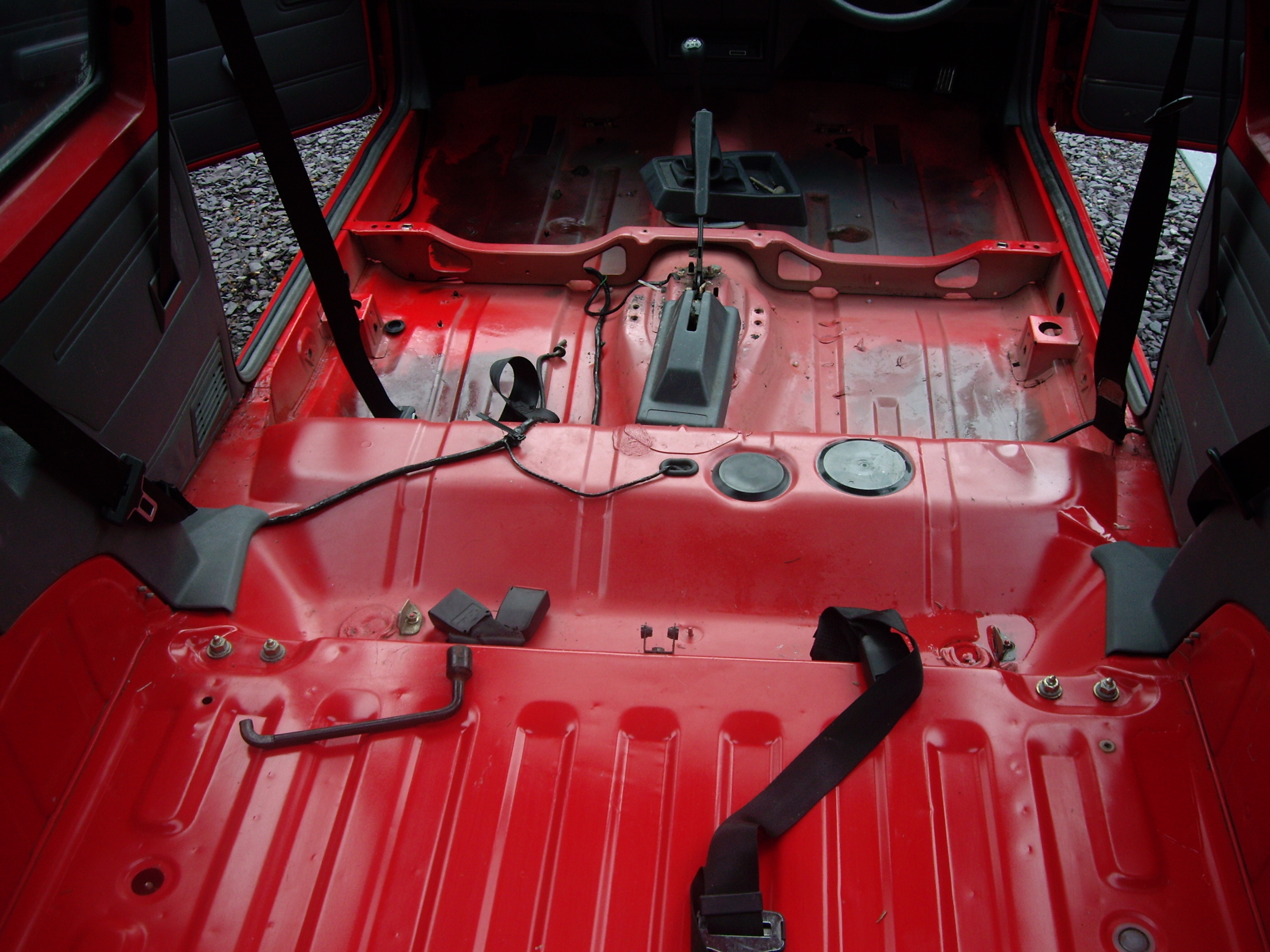

After deciding I didn't like the seats, or carpet, or pretty much any of the interior I decided to strip it all out! This being my first project I naively thought 'this will be easy just undo a few bolts and screws here and there'. Oh how I was wrong! After much frustration with rusty bolts etc. it was done though and here are a couple of pictures of the interior stripped out:
While doing this I found under the carpet was soaking wet (which seems to be pretty common) so the next job was to try and fix some leaks so I sealed up the rear quarter windows and the windscreen. I also took off the door and boot seals, cleaned them up, rubbed them with vaseline and re-fitted them. I also removed the original window rubbers on the doors and fitted some new ones. Already this was starting to be more work than I originally thought!

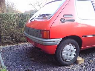

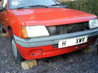

After doing these boring jobs I decided I wanted to something a bit more interesting so I got hold of some gti valances and fitted them:
Not a massive job but I think it makes the car look much better.

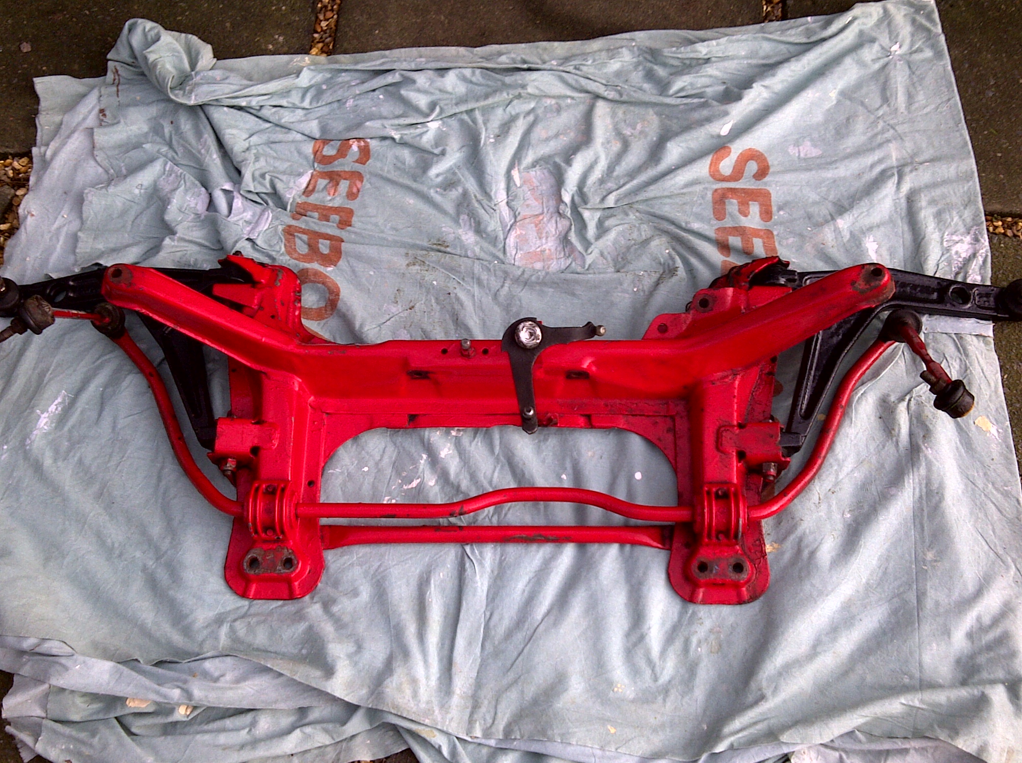

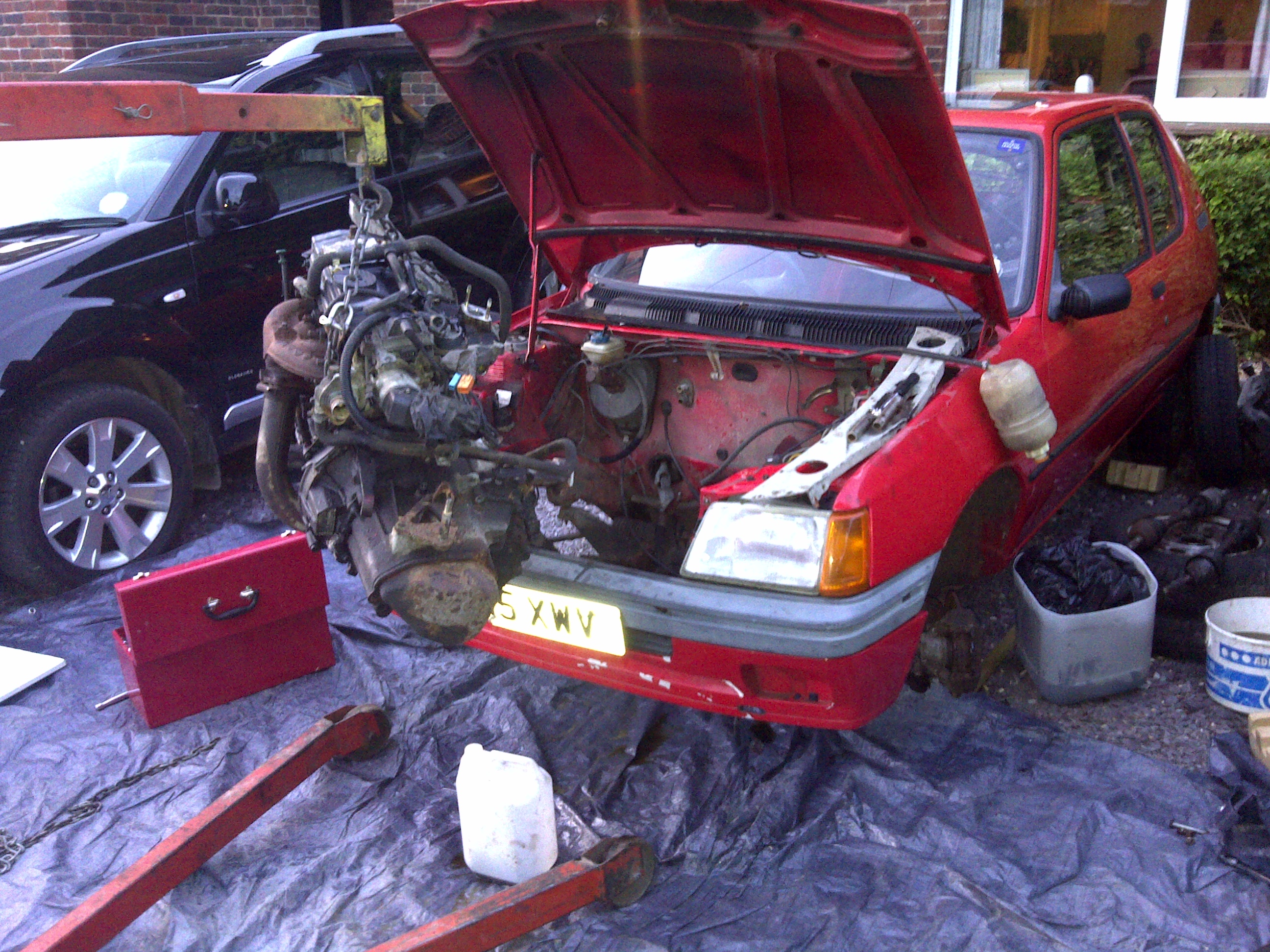

During last summer I set about removing the rear beam, fuel tank, front subframe and suspension and all the brakes and brake pipes (all of which I still need to get rid of!). No pics of the car in this state but it's not very interesting anyway!
Over the Christmas holiday I set about getting on with this project a bit more so I have now cleaned and undersealed the bottom of the car and the arches, hammered out a couple of larger dents on one of the arches, treated some surface rust in the engine bay. Also behind the n/s headlight there was a rust hole so I had a go at repairing it with a fibre-glass kit. Not the best job in the world but this project is as much about learning as it is about doing a perfect job. I also sealed up the edges of the stupid leaking pop-up sunroof (I hate them if you hadn't noticed) which looks really s**t tbh as I did a rubbish job but it least its stopped leaking lol. I fitted a boot spoiler (I believe it was from a phase1 gti although not sure as I bought it ages ago and forgot I had it). The last job I did was to fit a new subframe which I got off ebay:

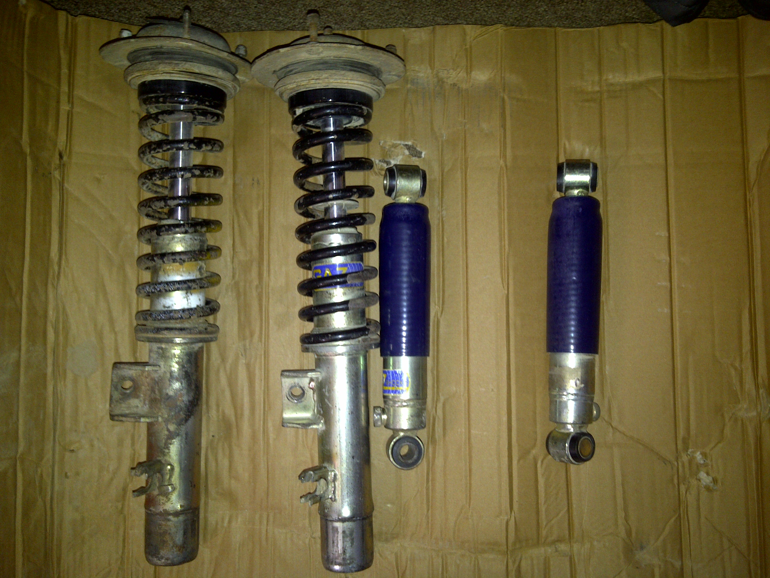

It was in pretty good condition, a few bits of surface rust and one of the drop links doesn't look too good but easily sorted. I have also just bought (delivered yesterday) some Gaz fixed coilovers and adjustable rear dampers. They are 2nd hand and on initial inspection seem to be ok and tbh they saved me a lot of money even over buying new standard suspension. Hopefully these will only be on the car temporarily (ish) until I can afford a nice Bilstein setup but the main priority is getting it on the road right now.
There are a couple of things concerning me about these but not massive things. Firstly one of the fronts appears to be missing what I think is the bump stop (rubber bit where the top mount meets the damper?) but I could be talking complete bull. Also while checking the rear dampers, the adjustment knob can be turned more times on one damper than the other (I wound them both to the softest setting before I checked how many turns). I dont know if this is because it is a bit more seized than the other or if I'm just worrying about nothing lol.

You've got a good amount of work to be getting on with! You've already got the sub frame, but you also need BE3 gear rod and linkages as its all different to TU engined cars. You'll also need a GTI tank with fuel pump in. Good luck! Love it when poverty spec models get some TLC, should be a right sleeper!
