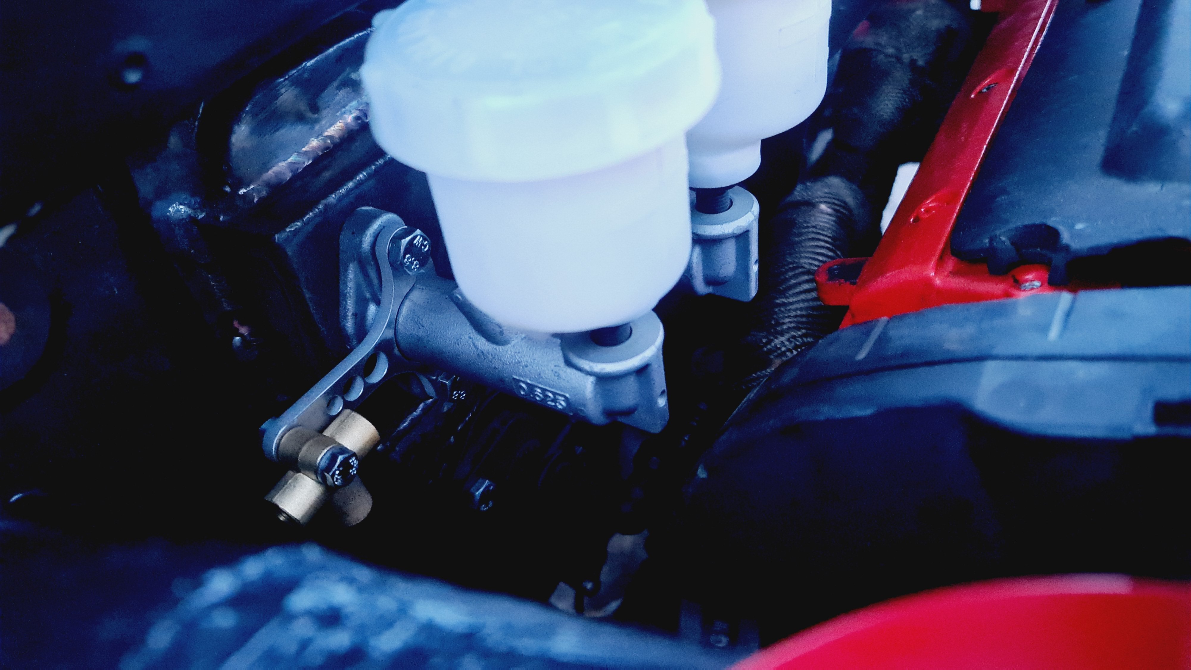

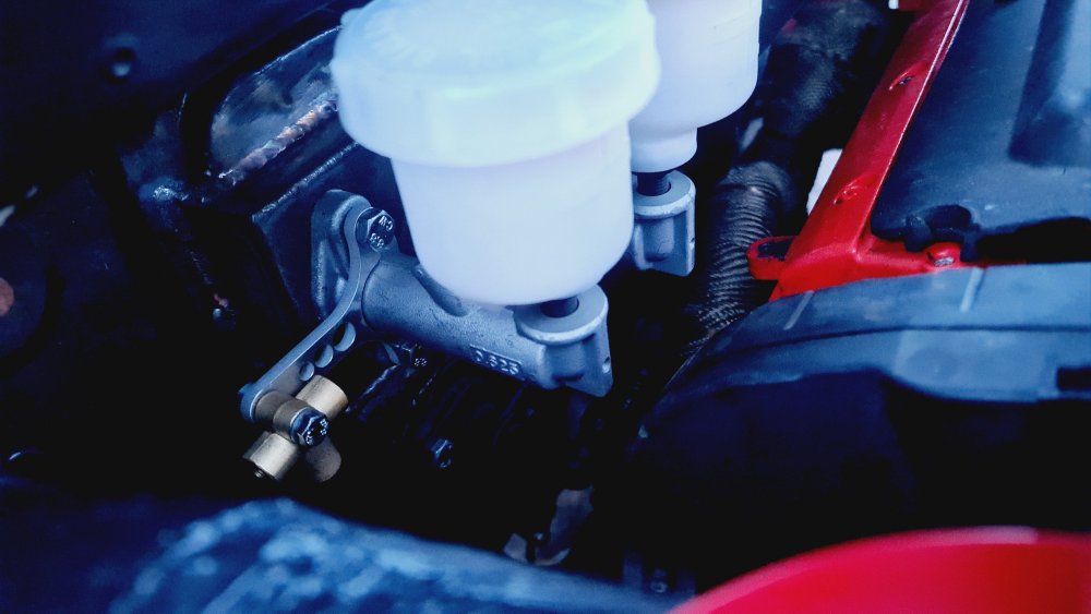

The last few weeks ive turned my attention to the pedal box, design ive really just winged it but concentrated on the pedal ratio as id rather not be braking with a brick like pedal. 5.6:1 was gained which i hope will be ok. Starting off with .625 cylinder for the fronts and .7 for the rear, Of course this may get changed or swapped at somepoint. I ve also fabbed a brace from the pedal box to the strut brace to try eliminate as much bulkhead flex as possible.

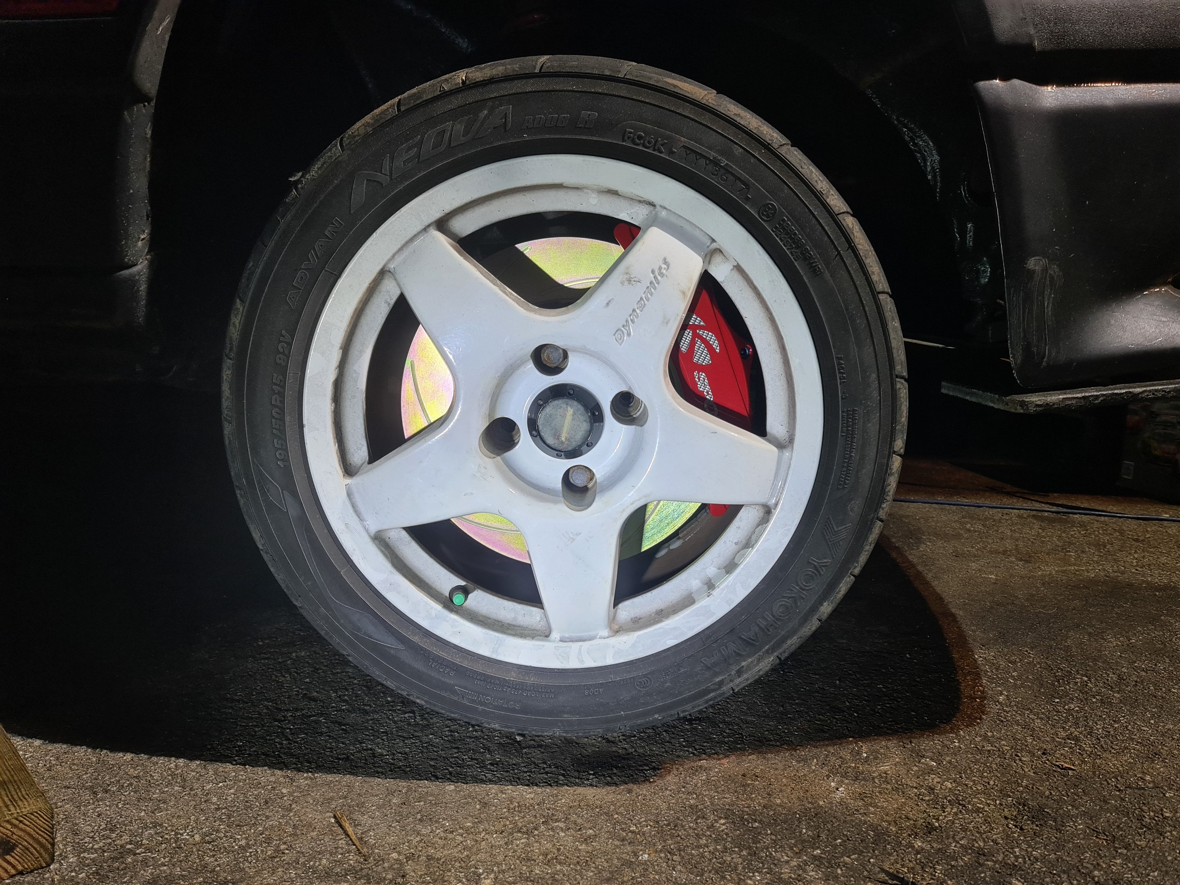

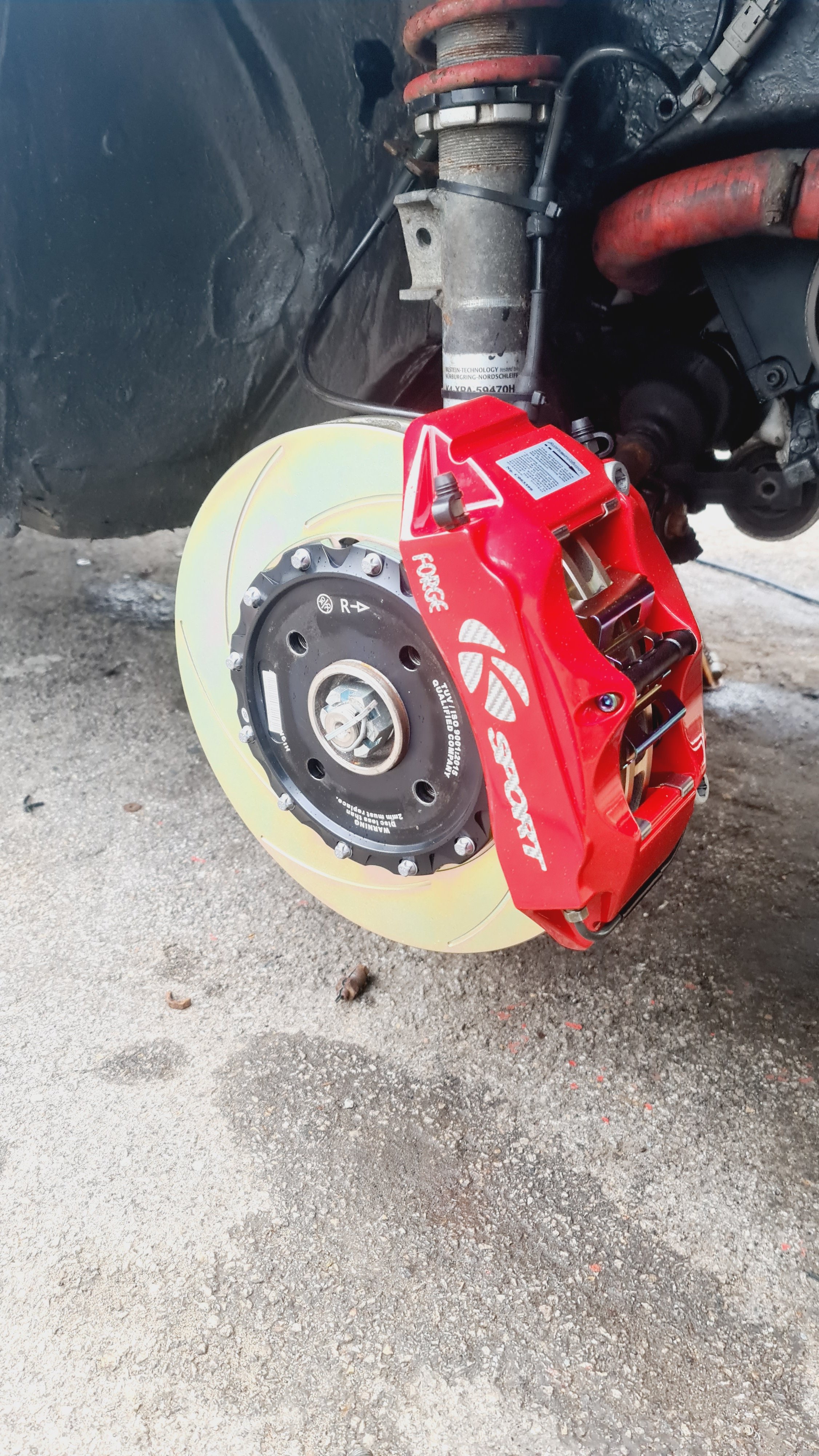

Brakes have finally arrive from ksport. First impressions are good, seems like a decent kit. Increased disc size from 285s to 304x28 with their 6 pot caliper. Like a utter child i dashed outside to fit them, despite the rain. They clear lovely behind the td pro 3's, only contact is the dust cap on the bleed nipples so might have to leave them off. Ive got some ex btcc pads to go in which will be more than ill ever need.
