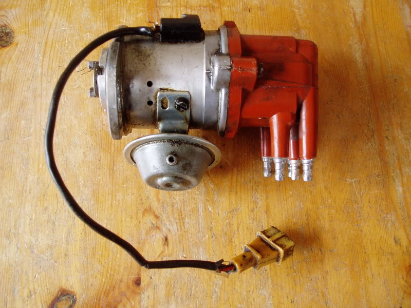

This is the style of cap I have on my 1989 1.9 Gti - is it correct?
ECP's database is at best absolutely useless.
Your car has the correct cap fitted for the age/model - indeed, as far as I know all 1.9 GTi Jetronic models have that style cap.
Sounds like ECP have supplied you with an early 1.6 GTi dizzy cap.
Whether you'll get your money back after 2 months I couldn't say, but I don't see why you couldn't swap the parts for the correct one if they're in as-new and unused condition, especially if the parts are listed wrongly on their system. I suspect that the default answer will be "no" given the time frame so you might have to kick up a stink.

Yeah, as I thought. Hopefully they'll be reasonable about it and swap them at least. I have to say I was convinced the supplied parts were wrong as soon as I took them out the packaging - unfortuantely for me (I have been rather busy with kids, xmas, etc ,etc) that was nearly 2 months after purchase.
Cheers once again. That has made me feel slighly less dim and a tad better :rolleyes:
