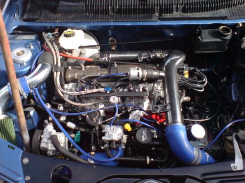

On a Friends car from this to
Miles
Intercooler hidden from all

Not seen many 2.0 8v turbo that doesn't look a mess, though Miles does a good job there of making it a little better!

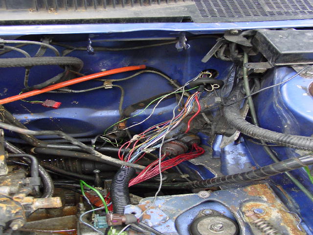

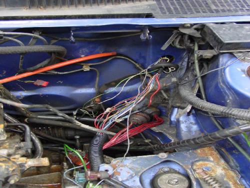

Here's a pic of the wiring loom nearly finished just need to find out if I need vss etc

yes you do need a VSS with the turbo ecu.

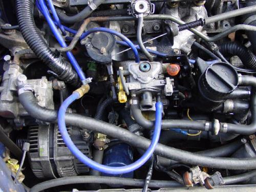

This was all done by my own fair hands
